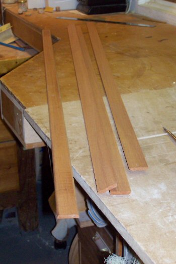

I wanted to try reverse kerfed linings (up to now, I've only used traditional) & couldn't stomach $3 per 16" piece, so I made up a batch & took pix. It turned out pretty well so I thought I'd post them, for anyone else who'd like to give a try (although I expect a lot of you are already doing something similar).

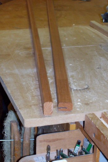

I started by milling mahogany to 3/4 x 1 1/4" and easing the corners with a 1/4" roundover bit.
These were then resawn in half & planed to 7/32" thick.

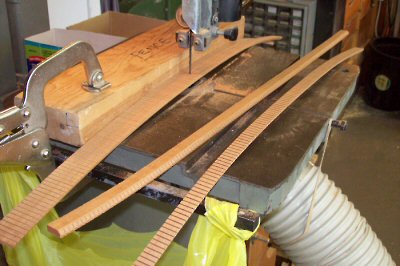

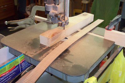

I glued a runner 90deg to a wood block, then cut a recess for the bandsaw blade & inserted a tiny brad to index kerf spacing. (Like I said, nothing fancy). The rear "slot stop block" dictates the depth of cut (& therefore the web thickness) and the front one is the "unload" position (shown), so you don't bang into the back of the blade each time. Just "unload", advance each newly cut kerf onto the brad & cut the next. Setup keys are backstop bearings touching the blade (ie no rearward flex) & make sure the blade teeth & vertical face of the block are parallel (my blade leans back a bit).

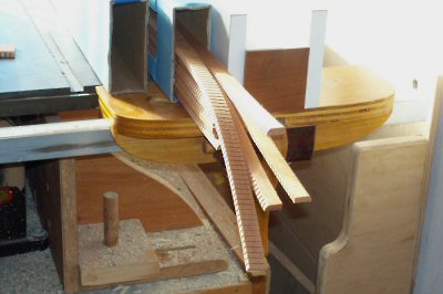

Once all kerfs are done, saw in half & you're done.
(36' in about 3 hrs.) You can tap the rear stop block to adjust the web thickness - thicker for the majority of it & a few pieces of reduced web for sharper radii of cutaway, horn & waist.  Hope this helps!

Ken - you place the "back" (flat) side of the strip against the vertical face of the block & feed into the blade, which cuts partially through the strip before being "stopped". You retract, move the strip to the left (so the kerf slips over the brad in the block just to the left of the blade) and cut another kerf. Repeat (many, many times!)
