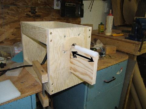

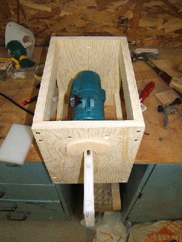

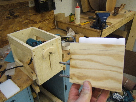

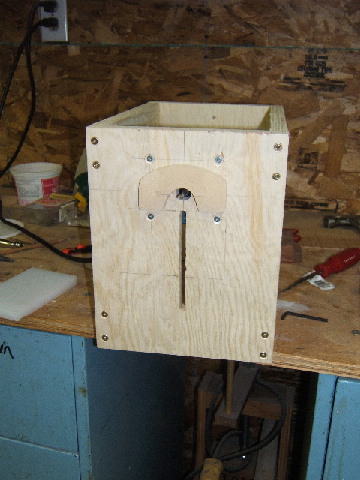

Well, I've never been happy with my binding setup (router and small roller guide). So I decided to make my own like many of you. I based it on the Larrivee/West/guitar jigs design, sort of.
Here are some pics for ya'll. It was very inexpensive to build, like under $5 for materials and $25 for the router bit (spiral down cut). All Canadian, so that is like $1.50 US for the materials and $4.75 US for the bit .
Anyway, hope this can help someone. I do plan on mounting a fine adjustment bolt or screw under the support arm at some point.
The nice thing with this design is that you can realy mount it anywhere. On the bench, in a vice, screw it to the wall. Now I just have to try it out. Wish me luck.

It should work well, set up might be a bit cumbersome tho. Practice on scrap to see how it behaves, then go for it! I use a similar jig and like it a lot. Mine has bearings that index off the sides, I'm sure yours will work just as well.

Hey Rod, on all of the ones I have seen, two..., at David Webber's and Ted Thompson's the caul that the top/back of the guitar rests on is quite a bit smaller. Yours looked well "formed" so you have prabably considered that.
Lookin' good!

Would a smaller caul make it possible to switch between flat-top and carve-top instruments more easily? (Or, the
larger caul could be made so that it's removeable/interchangeable to allow for different joint geometries.)

Keep it simple is a good motto. An old chainsaw adjuster and you are all set. No need to reinvent the wheel eh?
One suggestion you may consider. After bending some tough old cocobolo with wild grain the sides were less than flat in places. So a pair of rub points might work better in practice than a solid rub block.

Thanks guys, the caul footprint is big, but as you noticed Shane, it is formed to be a small contact point. The caul is attached with double sided tape (I love double sided tape) so I can always take it off and reshape or just put something different on.
Bruce, do you meen changing the UHMW rub block to two points, one at the front and one at the back? I could just cut a long notch in it on the band saw.

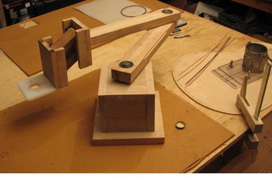

   Cool. I'd like to try that system as well. Here's a little jig I've copied off somewhere on the net. It's oak and birch and has a ton of bearings (that I had lying around the shop). Works o.k., I guess. Never really tried it on a guitar (closing up number one now) but the carriage where router sits is dead level (maybe not such a good thing, though)... Cheers

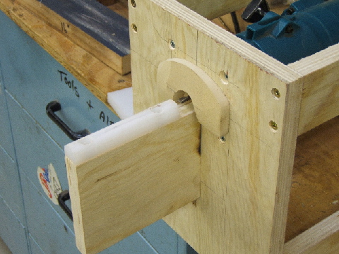

I used a similar rig for a few guitars & found it worked better once I carved a curve into the rub strip. (between the two screws on your setup) This will leave you with two points of contact rather than riding on the whole length of the strip. Makes for less friction & discrepancies in the sides will have less effect on the cuts.

Yup, that is the beauty of these types of jigs they hard reference off the sides so you want the 'depth' reference (which would be the width of your binding for instance) to be as close to the outside edge of the guitar as is safely possible so that you get a consistent depth of cut irrespective of top/back radius.

[QUOTE=Rod True] Bruce, do you meen changing the UHMW rub block to two points, one at the front and one at the back? I could just cut a long notch in it on the band saw.[/QUOTE]
Yep, two points to eliminate any irregularities in the surface causing the guitar to rock on a high point.
Congratulations by the way, building a simple tool like this to do a difficult job is fantastic.

I will trim that rub block down in the middle to ensure the body is resting on the outer ends only.

The downside of having only two points of contact is that if you have a guitar with a shallower than normal side, like my travel guitars, then the side doesn't rest on both ends of the spindle.

Rod, while you are considering the two rub points, you might as well consider one other adjustment.
I have a commercially produced unit. The problem of fixed rub points is that it is possible to lean the guitar into the cavity between the rub block near the cutter. This makes a nasty gouge into the binding ledges.
After modification, my setup now is adjustable and closes the gap between the rub blocks and the cutter. I usually have no more than the thickness of a business card between the rub block and the cutter blade. No way to tip the guitar body in there now.
I'll see if I can dummy up a photo and add it here.
The adjustment could be as simple as loosening the screws holding the rub material and sliding it in and out as needed then retightening. Similar to what you are doing now for height. Mull that over.Dickey38723.8810763889

Bruce, good idea.
Or maybe a dovetail down the center of the plywood, that way I can use two rub blocks and I can adjust the back one as well for thinner bodies.
