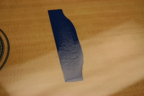

Thanks for the info! It raises a question I've had about masking off the
bridge before finishing - does the thickness of the masking tape cause
problems with sanding to level the finish? Thanks!

PostPosted: Sat Oct 13, 2007 12:33 am
[QUOTE=crazytooguy] Thanks for the info! It raises a question I've had about masking off the
problems with sanding to level the finish? Thanks![/QUOTE]
Crazy:
No, it doesn't. I had that exact concern but it just isn't an issue. If you wet sand down to the edge of the tape, not only will it not be an issue, but the finish OVER the tape will be perfectly smooth too. I took a photo of that for you. And remember, we're only talking about a few thousands in the finish thickness anyway...so the "ramp" up to the tape will be miniscule at a level that is practically irrelevant. (IMO)
