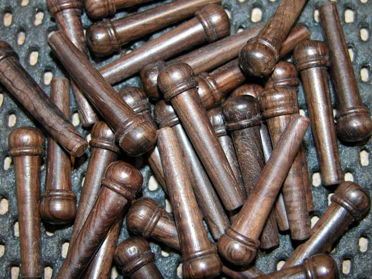

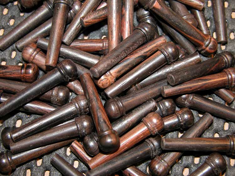

A while back I contacted a fellow OLFer and asked him if he would make me some BRW bridge pins.  Not only was/is this OLFer one heck of a nice guy he was very happy to help me out.Now I am not revealing our pals name (yet) because he never answered my question to him as to if he wants it known that he made these.  My concern is that he may not want to be flooded with requests and I am protecting his privacy - I am sure you would understand.  But if this very fine guy would like to step forward, or let me know that I can use his name, by all means do.With that out of the way.....  What you are looking at ladies and germs are 3 degree, unslotted BRW bridge pins that were each individually made by one of our very talented OLF pals.  My pictures do not do these pins justice by any means.  They are the nicest pins that I have ever seen or had.Interestingly when I was opening the package you could hear them "pinging" against each other - a very good sign.....Now, to head off any misconceptions that I believe that these pins will make a guitar sound better I will offer this.  BRW bridge pins, custom made, are merely yet one of the many details that some of us may go to in order to impart value to our guitars.  Perhaps they will sound better, I don't know and I am not making the claim that they will.But clearly I was convinced by recent threads that unslotted pins are superior and 3 degree pins are probably also superior.  The fact that these ring very well may be a bonus.One thing is for sure, my dog and I plan on spreading them out on the floor and rolling in them as the maker suggested that I do.Take a look.
Thanks for looking and MANY, MANY thanks to our OLF pal who made these beautiful pins!!!!!
