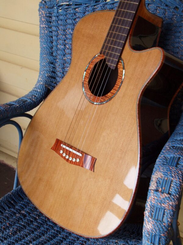

PostPosted: Thu Jan 29, 2026 4:22 pm
Joined: Mon Sep 05, 2011 10:45 pm
Posts: 1501
First name: Trevor
Last Name: Gore
City: Sydney
Woodie G wrote:
While I would not dream of offering a correction to Mr. Carruth's third post re: matters of primary importance, I would offer an additional consideration for those building for our ever aging population of Boomers and early Gen X'ers. Shortening the neck relative to the location where the guitar rests on the right leg (for righted-handed players) reduces the tension and related stress during play with first position chord shapes, etc. This can be easily experienced with a 14 fret-to-body guitar and a few minutes playing the same piece open and in Capo2 or Capo3. Particularly for those adjacent to or perhaps actually enjoying their seventh decade extant, the bio-mechanical benefits of a shorter 12 fret neck - often paired with a shorter 14 fret body style, shorter scale length, and a cutaway for upper fret access - may keep a customer comfortably in the game for years longer than soldiering on with long-scale 14 fretters.
That sounds like you're writing an ad for my guitars, Woodie! Thank you!
This is a 000 sized guitar, 12 fret neck, Venetian cutaway, straight pull head stock (which you can't see) which makes the strings feel lower tension, and in particular, the high waist which brings all the left hand work closer to the body when the guitar is rested on the left thigh. Same for the 00 sized guitar. And they sound good too! (Bruce Matiske playing).
Full plans and build instructions for the 000 sized guitar are in the book.
Trevor Gore, Luthier. Australian hand made acoustic guitars, classical guitars; custom guitar design and build; guitar design instruction.
http://www.goreguitars.com.au
