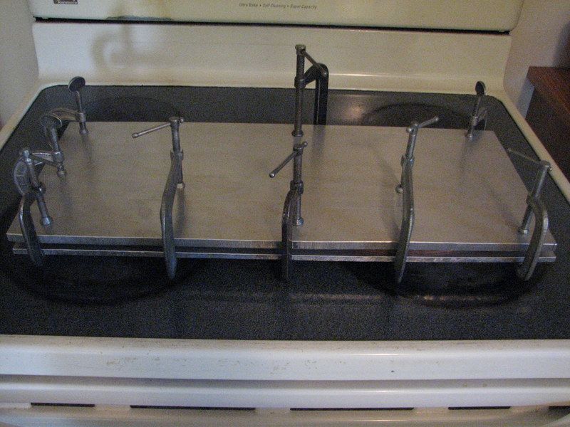

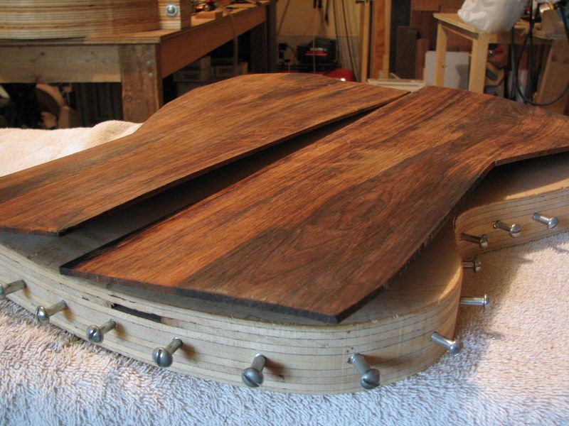

A very warped set of brazilian rosewood that I flattened out using my kitchen oven, two sheets of aluminum and a few clamps.Put the aluminum in the oven at 280 for 20 minutes to get hot. take out and place both back pieces between the aluminum and gently press down slowly. I had no problem getting them to go down together completely flat. a few clamps around the edges and back in the oven for 15 more minutes. Let cool for several hours and they came out perfectly flat and have stayed that way in the finished guitar.Be sure there is NO WAX on the ends of the back sheets. On this set I used a razor blade to scrape ALL the wax residue off before heating the wood.

Where do you get aluminum plates like that, and how much do they cost?

I went to a small machine shop near where I live. Payed $40 dollars. Considering the cost of the rosewood, it was a very small charge to get it into useable shape.They came out perfectly flat, but I was a little concerned about the warp coming back. I glued the two halves together and cut out the guitar shape, thicknessed the back to .095 and let it sit for about two months. Still perfectly flat.
