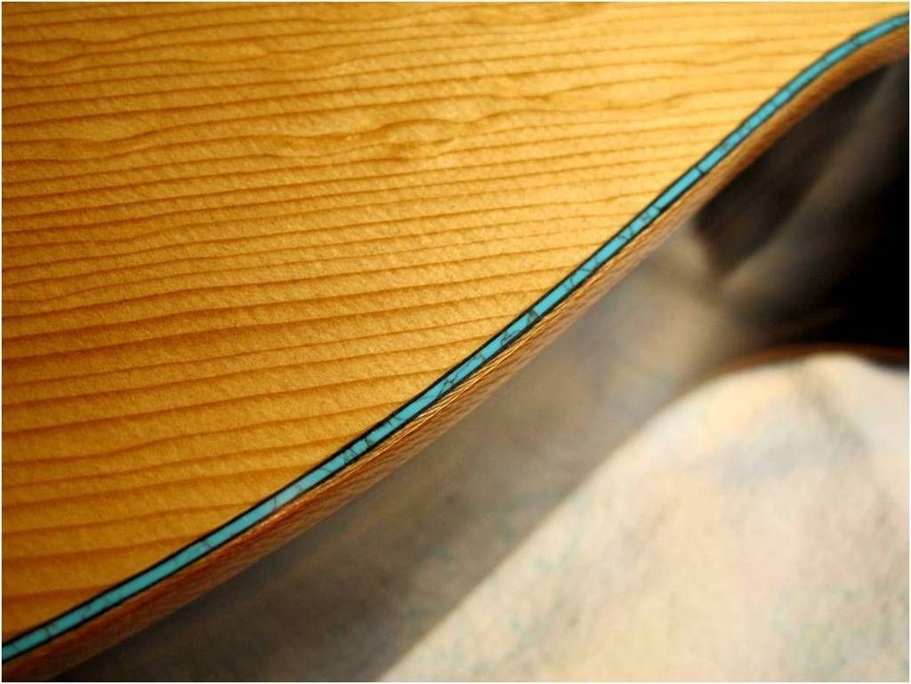

Pat Hawley wrote:
I should have added that there will be no side purfling but the top will have blue paua abalone zipflex. I'm curious, Dennis, about your suggestion for having turquoise recon. stone for purfling. I'm not familiar with that. Can you point me to an example of what it looks like?
Pat
Here's an example. It came in strips about 4 or 5 inches long in the width you see in the photo. The strips were straight but could be shaped into curves using a heat gun.
These users thanked the author J De Rocher for the post: Pat Hawley (Sun Jun 07, 2015 7:45 am)

J De Rocher wrote:
Pat
Dennis I love that look! I'm prepping to build a Claro Walnut and Western Red Cedar top OM guitar with curly maple binding and rosewood fingerboard and bridge with a mahagony neck laminated with Mah/Curly Maple/Claro Walnut/Curly Maple/Mah pattern. They inlay theme is Paua Abalone I don't want to use that same thing around the top for purfling but that Turquoise recon looks great. Where did you get that from? Also open to any suggestions on the design.
