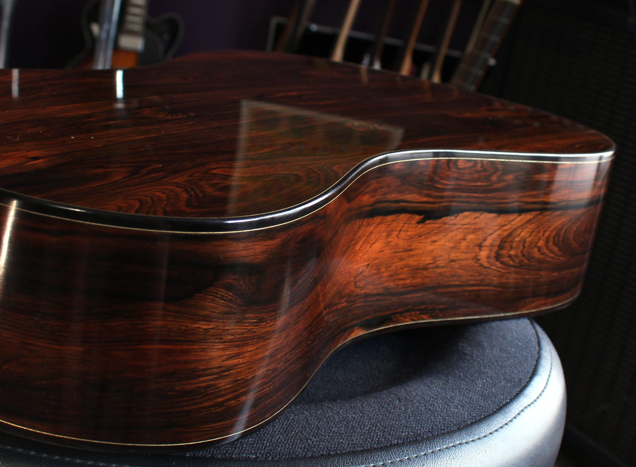

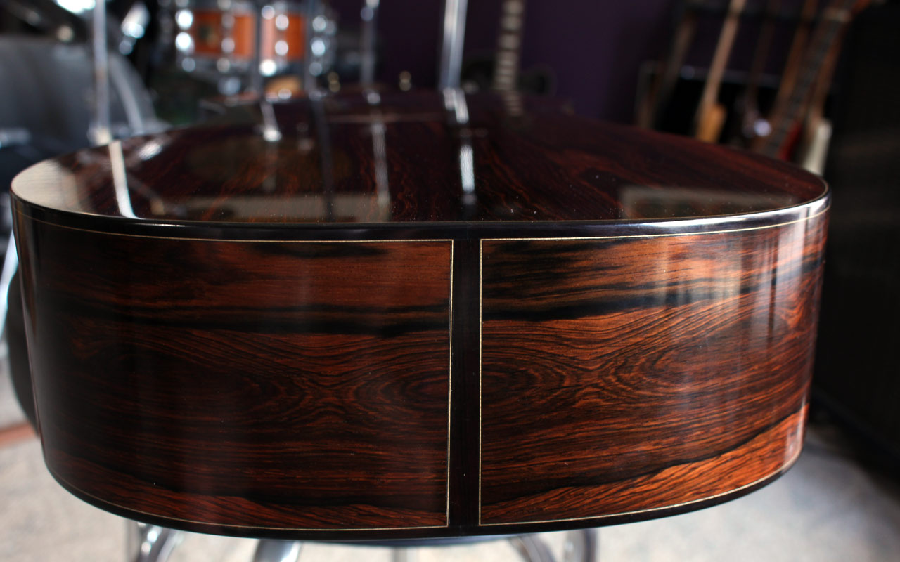

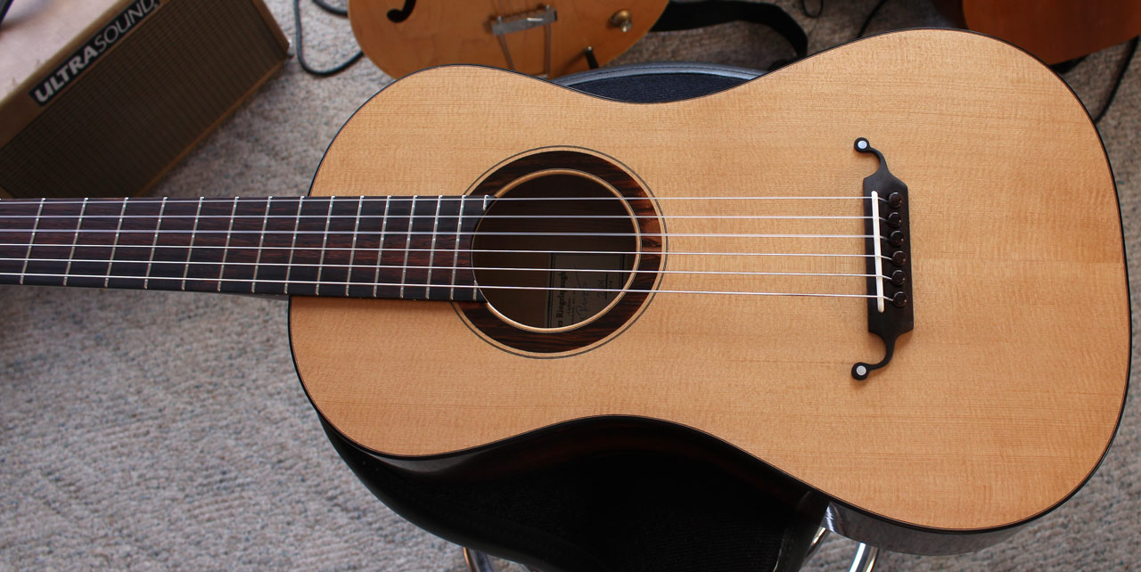

I hope you folks don't mind me sharing... I'm finally taking time to finish up some of the 'it might be cool to try...' projects I've started over the years. This one is a little 11-1/2" wide guitar loosely based on some 19th century guitars but with contemporary features like steel strings, modern machine heads, and an armrest bevel.
Specs: X-braced, 26" scale, 11-1/2" lower bout, body depth is 3.5-4"
Spruce top, Brazilian rosewood back, sides, headplate, rosette, and bridge (the back is Brazilian rosewood veneer laminated onto spruce). Honduras mahogany and Spanish cedar neck with V-joint. Cherry bindings. Finish is French polished shellac on the body, sprayed semi-gloss shellac over open pores for the neck.

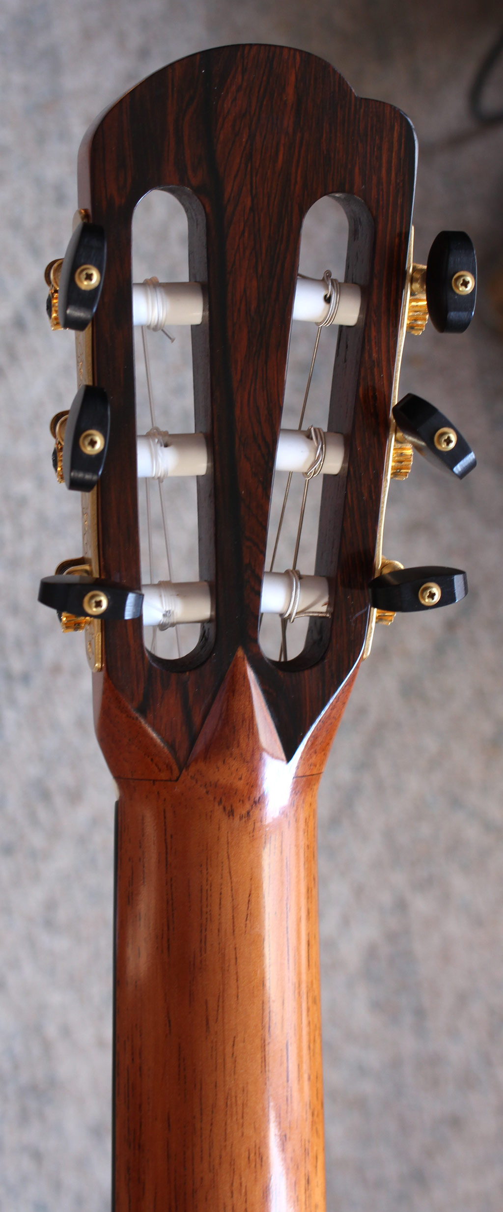

Wow, James!
It is quite stunning!
I really like the shape, the materials, and the finish.
The v joint looks well done.
I very much like the classical look applied to a steel string.

James, I know next to nothing about parlor guitars, but I think you have created a stunning little beauty. A question I have is about the scale. Not a criticism, only a question: It's longer than the biggest honkin' arch top I've ever seen. Wow! Is this a normal scale for a guitar of this (otherwise) dainty size?

Very nice, love the size, shape and bridge. Not a big fan of glossy finishes over open pores.

Nice! I love smaller guitars, spruce double back?
Regardless, I really like your little guitar. I'm not sure my old left hand could span the fret intervals, but in the final analysis, who cares what my old hands could do? I love it.
Patrick
I actually thought about going longer, but for the size and shape of the top a 26" scale got the bridge where I wanted it... a shorter scale put the bridge too close to the soundhole. Plus the longer scale gives it a little more tension and power over most modern scales which sounds really good. Feel-wise it's very close... the first fret is only .03" further away from the nut than it would be using a Martin scale.

DannyV wrote:
That is a very cool little guitar James. Love the way you've tied together the old and the new. I'd like to try a 26" scale. Do you notice the length?
Like I said a few posts up, not much if at all. It is a bit top heavy though... I really wish there was an affordable lightweight tuner set with wood buttons.
Yep, Brazilian rosewood laminated over spruce. It's my understanding that a lot of 19th century guitars were done this way. It definitely keeps things light and very lively.

Very nice. Don't know how some of you guys get such a nice French polish. I really like that bridge and the overall shape. [clap] [clap] [clap]
