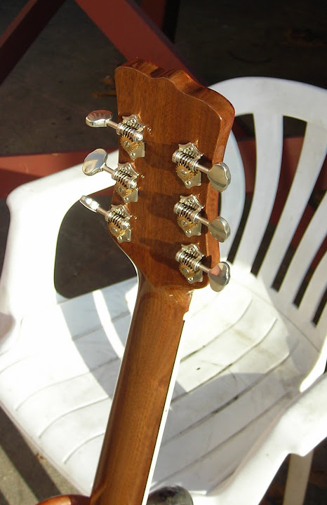

I was going to suggest dyed wood veneer, too. While building my tenor banjo, I ran across an excellent builder who ornaments his instruments with lots of cross-banding in dyed veneers. I decided to emulate his techniques and make cross-banded fret position markers under the fingerboard. I did this with un-dyed walnut and maple veneers. The neck has a one-way compression truss rod with a spline glued in over it. Then a sandwich of three veneer layers and finally the bound fingerboard on top. It worked very well for me. Frankly, I have no idea whether this would work with a two-way rod and without the spline. But, for a compression rod neck, I see no reason why one or even a few layers of veneer wouldn't work. This degree of ornamentation might be out of place on most guitars, but it always seems to work on banjos. I don't have a picture which features just the cross banding, but you can see a little bit of it in these two shots.
