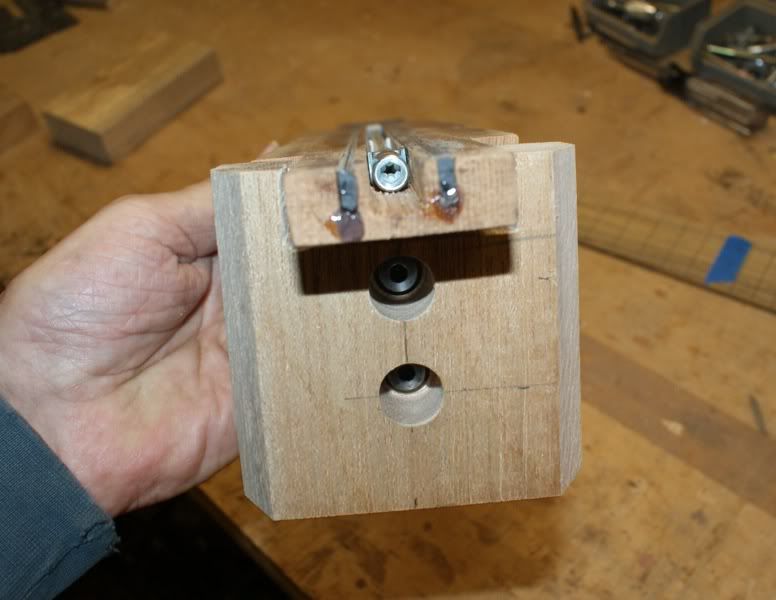

A couple of years ago, I built an all western red cedar guitar with two square CF rods in the neck. On each side of the truss rod.
The CF rods ran the full length of the neck including the finger board extension support. Glued in with epoxy glue.
I used a router table to cut the CF rod slots and the truss rod slot when the neck blank was still square with no peg head ears.
