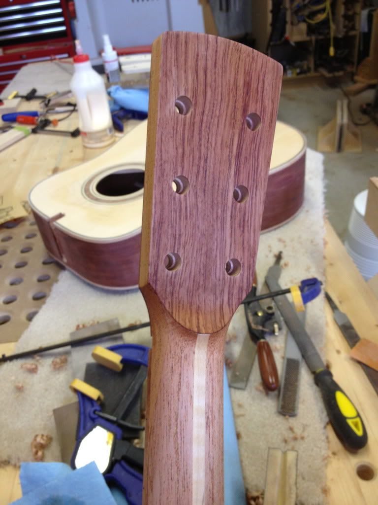

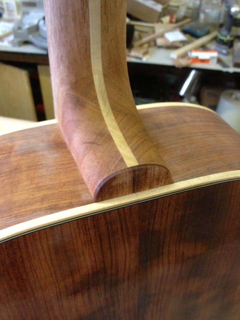

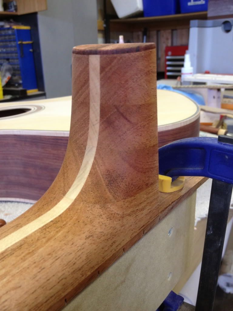

Well I've been working away at my first two scratch build guitars for some time. On my wenge build, I purchased a partially shaped neck blank off of the internet, and for my bubinga build I decided to give building a neck from scratch the good ol' college try. And of course, instead of keeping it simple, I decided my first attempt would be a laminated neck. (sucker for punishment I guess). Today I've finished shaping and sanding the neck and I'm extremely excited about the results, however, the laminated heel was a bit of a disappointment. The lamination went well, however, you can see the joint lines. I have nice tight joints, but the joint appears darker than the African Mahogany I used in the neck. It's really noticeable when there's nothing on the neck, but tends to disappear a bit, but not completely, when I hit it with naphtha. My question is whether or not this is common with laminated heels and whether there is anything I can do to mitigate how this looks?
And because I know you guys like pictures, I've included a bunch below of my neck, as well as some overall shots of both guitars : (I hope the photos aren't too big)

I don't see anything abnormal with the glue lines. The biggest thing you may see when finished is the different grain patterns of the individual pieces.

not an expert, but i think youre always going to see the stack lines with that design, it is just "par for course". i suspect that when you start finishing, the darker glue won't absorb finish/stain at all, whereas the wood will, so the lines should become less apparent. that is my hunch; i could easily be wrong !

Rob: When not doing a solid neck I like to use a solid heel block. With good wood selection quite often you have to look closely to see it's not a solid neck. Agree with Brian,the grain is a bigger give away. Nice looking guitars going on there by the way.

I'd say your stacked heel block looks quite good - for a stacked heel block.
I just carved my first neck and am not a fan of the stacked heel block - at all. I don't have too many options as I don't have any stock to use a solid neck or a solid, single stacked heel either. Not too many alternatives but I'm looking for them if they exist.

Brian and Larry have it, in my opinion. Don't sweat the glue joints. They look fine to me. You will see the grain orientation in the various laminations. I've got a hunch that's what you're really reacting to. Well...who cares? Just press on, and when it's finished you can tell everyone that was a conscious choice. If you decide you don't like the look, you can do the next one differently. But this neck will be just fine. You can experiment with full heel blocks or other stacked grain orientations in the future. If they are all built to this standard, I'm pretty sure they will all function very well, and each will hold some beauty that will catch the eye of some beholder. Beholders are all individuals. I've got an artist friend. He's actually pretty famous. He tells me: "I hate about half of my paintings. But someone always buys them." It's no different with guitars. Beholders have their individual tastes.

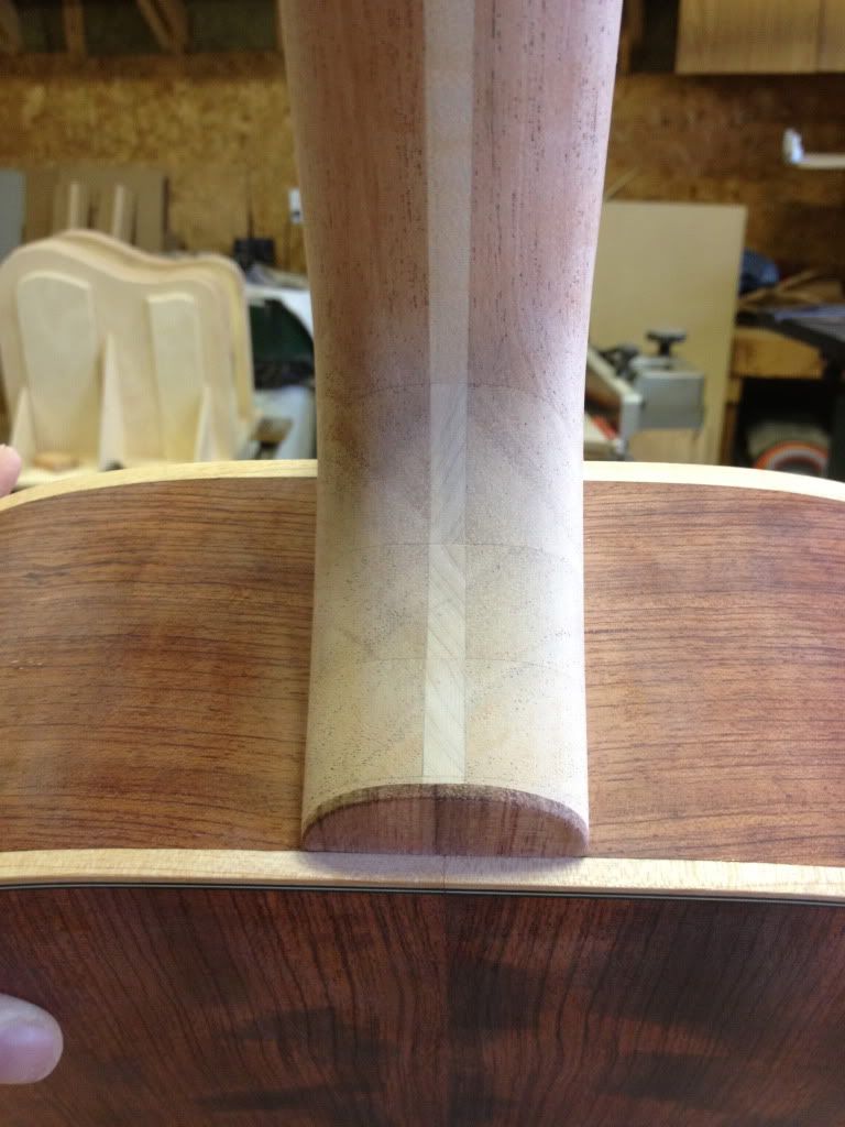

For purposes of how I pay attention to grain, here is a picture of that heel when I was shaping it, before the finish went on.
