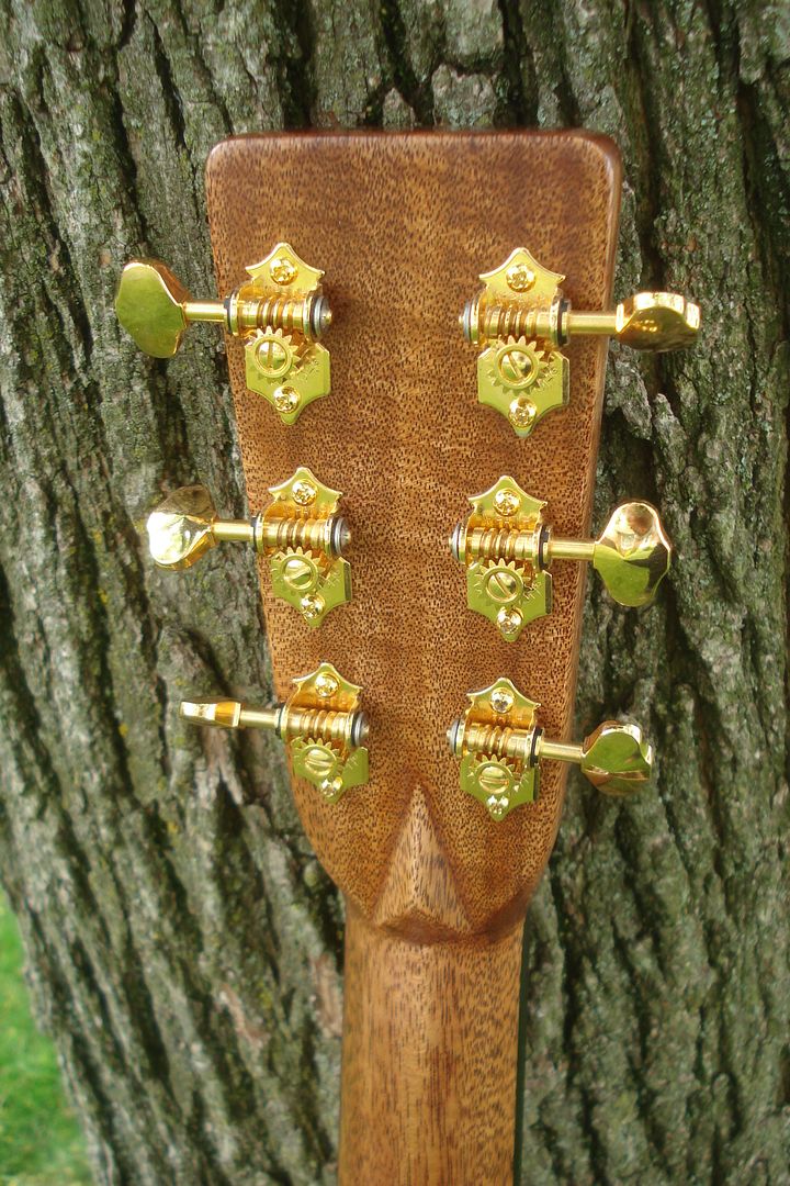

PostPosted: Mon Oct 15, 2012 4:52 pm
Posts: 1877
First name: Darryl
Last Name: Young
State: AR
Here is what my last mahogany neck looked like after pore filling with Zpoxy (prior to finishing). The pores aren't as dark as on Fred's neck.
