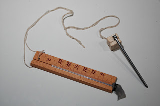

No problem. Make your own psychrometer. All you need is:
  1. a thermometer
  2. this online calculator
  3. to extrapolate the actual atmospheric pressure from the meteo data you'll find on the website of your nearest airport or aerodrome to the pressure at the altitude above sea level your shop is located.
  4. to make sure you do the measurement while there is an even temperature in your shop and no great air circulation (or you'll probably not measure two times "the same air" when using only one thermometer for dry- and wet bulb temperature
This is a list which will help to interpolate atmospheric pressure levels at different altitudes indicated in meters above sea level (with normal pressure of 1013mbar at 0m).
Just go linear when figuring out your actual "right" atmospheric pressure using the data of the nearest airport and this table. It will be slightly wrong, but still good enough for our purpose.
The wet gauze wrapped around the bulb is important. If you use one that does not hold the water very well (shirt material etc.) you'll need a bit more material to hold enough water, which will result in a longer slinging time needed. Using T-shirt material I end up slinging the thermometer for 2 1/2 to 3 minutes till the temperature does not drop any more. When determining this point a digital thermometer really shines and you'll find that the 10 extra bucks were well spent.
Costs will be somewhere between 2 $ and max. 15 $ for an analogue or digital thermometer, plus a nail, plus an eye screw, etc.
When working very carefully precision will be better than +/- 3% even when using the cheapest thermometer you can find, respectively better than +/- 1.5% when using a decent digital thermometer and having the nearest airport within a few kilometres or miles, or even using a mountaineer's altimeter/barometer (which is what as I have - but that's not cheap anymore if you don't have it anyway).
I have written down the whole detailed story in Spanish, this is the link to the terrible google-translation (I believe you'll still get the main points I explain there, and you'll have a good laugh in any case - if an an important portion of the automatic translation is not understandable at all, learn Spanish :lol: ...or just ask me ;) ).
Finally, here the analogue 2 $ thermometer version:
Click on picture to enlarge
And the digital 10 or 12 $ thermometer version:
I hope this helps you save some $$$. ;)

Mike Lindstrom wrote:
But as I said, I have no idea how consistent it is.
I have a similar one:
Image Image
Click on the picture to see the (spanish) blog entry, use the google translate option at the bottom of that page if you are eager to read that stuff in something similar to English.
... and I think it is pretty consistent, much better than any "cheap" hygrometer other than a cheap psychrometer. I had done comparisons with a cheap-and-everytime-recalibrated hygrometer throughout an year or so and the wooden hygrometer seemed to be always right compared to the freshly re-calibrated cheapo.
However, a few weeks ago I decided to modify the wooden hygrometer a bit, so all the previous measurements don't serve anymore for future comparisons. I took this as an opportunity to start over with comparisons, but this time with my psychrometer. Again, as far as I can tell after these few weeks it seems to be consistent. I stored the records on my PC and uploaded them right now to the Internet here in case someone should be interested in (sorry, each picture weighs 1.5 MB - initially I did not think of publishing them but thought of a quick & dirty data collection just for me).
A few days back after a couple of rainy days I had 40% RH but for some reason forgot to take a picture of the wooden hygrometer. However, now RH is back to 29% and the wooden hygrometer indicates just what it should on its "scale" which so far are only the grain lines of the base plate.
The wood I used is abies alba, here we call it "Weisstanne" which literally translated to English would be "white spruce" or "white fir", but i thing usually it's called "silver fir". I used this wood because I had scraps of it laying around. I don't think that, regarding consistency it matters which kind of conifer or even any wood one uses for building a hygrometer.
I glued up the short indicator with HHG, and the long indicator with Titebond. I could not see any difference so far, although I have to admit that I don't look too much at the short one. The nice thing of the two indicators is that when they start to "intersect" (they are now narrower than the strip in the first picture above) I know from a distance that humidity is dropping below ca. 30% which is kind of alarming for some older instruments I own (that's the critical RH when they must stay in their case).
