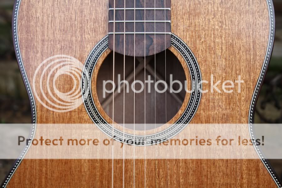

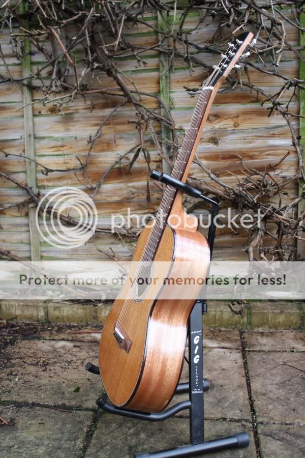

Well, this one's finished and ready and ready to go to its new owner.
The wood to make this guitar came from my neighbour's old window frames, and that's who this guitar is going to.
The mahogany top is superb wood, perfectly on quarter, and came from the window sills, and was wide enough for a two piece top (with a few more sets left over), the neck sides and three piece back, from the widow uprights.
So, the components were:
Back Sides and Top and Neck, mahogany.

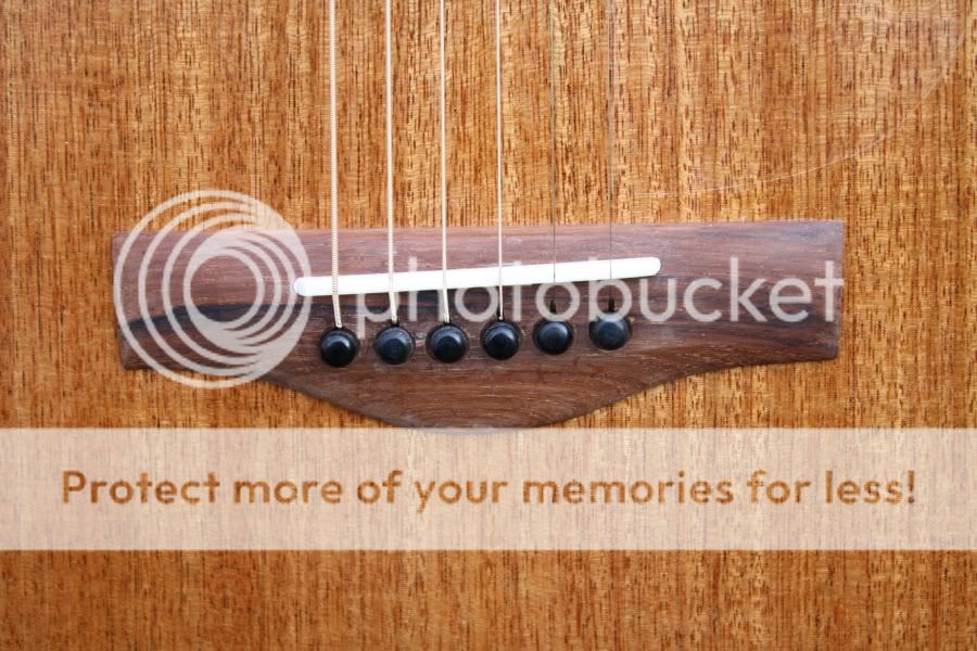

Fingerboard, bridge and binding, Madagascan rosewood.
Headplate, ebony.
Purflings, rosette etc Black/white/black and rope.
I make my small bodied steel strings using the same plantilla as my classicals, the Torres 1864 FE19, who am I to argue with the master.
Tonewise it's what you'd expect from mahogany, real growl, but full and even across the board, this is the perfect little blues guitar, and will get better and better over the next months and years.

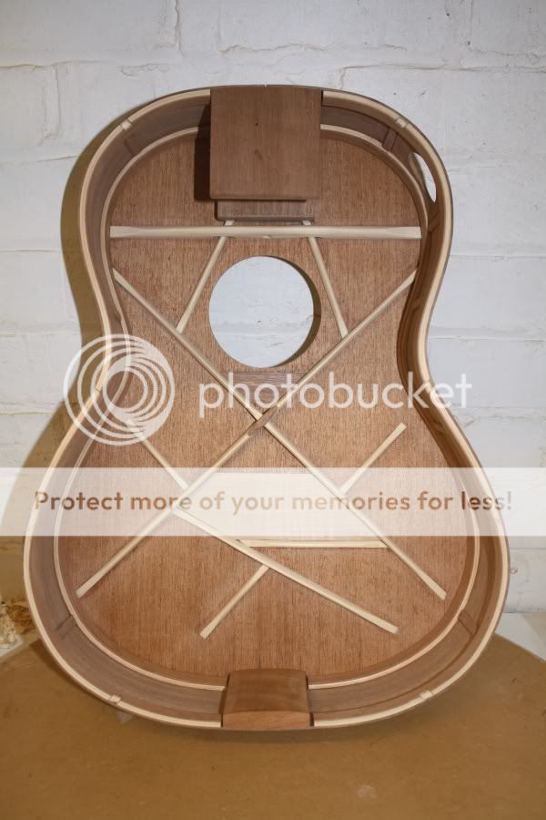

Colin awesome git what was the thickness of the top, back and sides? I'd like to build a small body all mahogany git for my next project! bliss

Before final sanding the various thicknesses were:
Sides, 0.085"
Back, 0.095"
Top, 0.100"
Top thickness as always is down to the individual piece of wood.

Did you brace the back like that because it's a 3 piece or is that your normal way? I've never seen that before and I really like it.

Joe, I always use an X braced back of some description, sometimes just a single one in the lower bout, with a transverse brace in the upper bout, or like this with two X braces. I like to build with a stiff back, and find that the Xs do this and stiffen the back.
