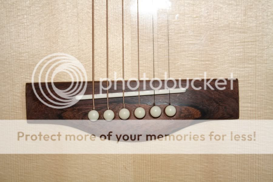

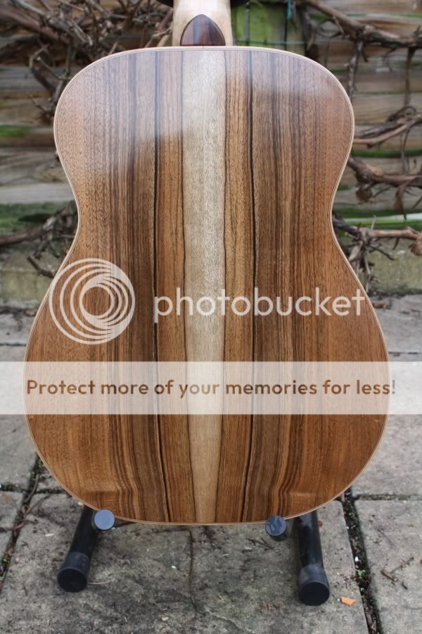

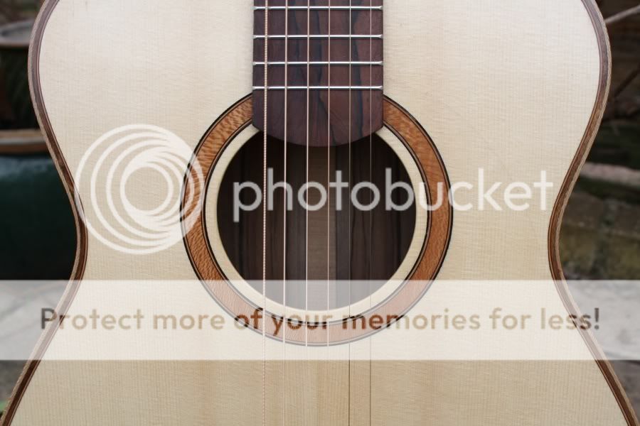

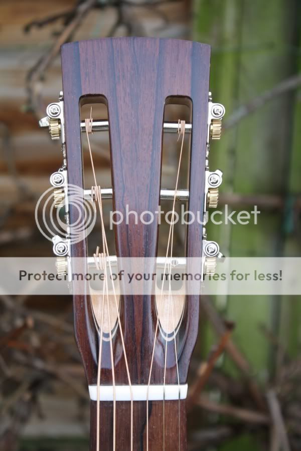

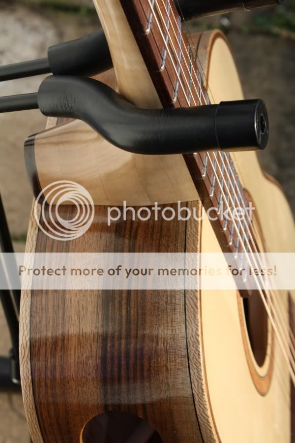

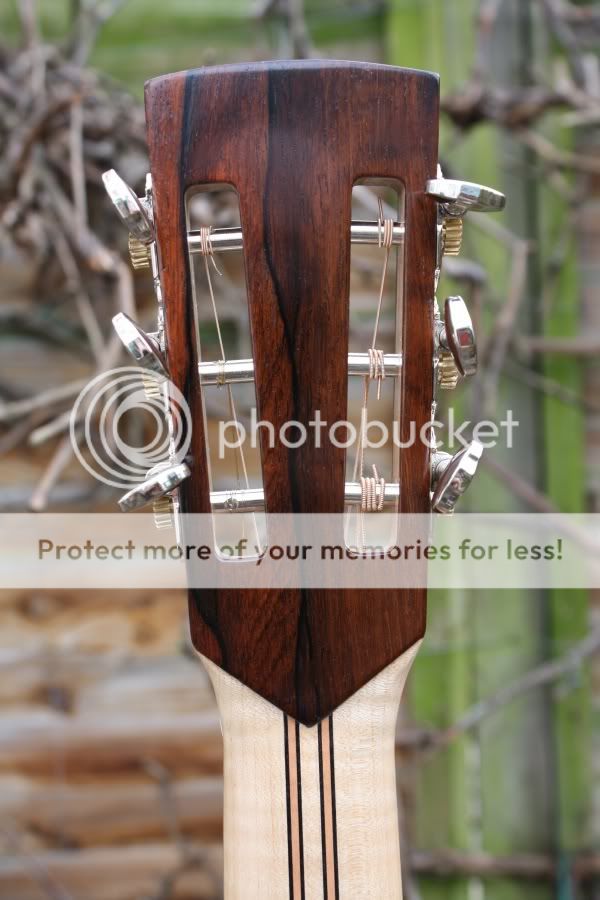

This is going to be collected by its new owner this weekend, together with an LS redwood/Cuban Mahogany OOO
This is a sister guitar to my old personal DADGad guitar I made some years ago, the customer played that and liked it and luckily I had sister sets to both the B&S and soundboard.
Soundboard, European Spruce (speaks Italian).
Back & sides, English Walnut, from a tree that came down in a storm in 1987.
Fingerboard, Bridge and Headplates, Madagascan rosewood.
Binding and rosette, London Plane.
Neck, Curly European Sycamore (that's a maple to those who live on the wrong side of the pond).
Purfling and neck laminates, Walnut, ebony/pear/ebony.
Bracing stock, European spruce.
Nut and saddle, camel bone.
Finish, oil varnish
Though I shouldn't say so myself, this has turned out to be one of the two or three best sounding steel string guitars I've made, very full and even right across the board with strong fundamentals but overlain with rich overtones. I'll try and get the new owner to record it for me .
I'm completely anal when it comes to the fit of components on a guitar, binding gaps and gaps at the neck body joint drive me mad, so I love it when it ends up like this.

Beautiful guitar, Colin! It has a very nice visual balance, and the bindings are stunning without looking overwhelming. Congrats! [clap]

really nice! i´d never thought a london plane rosette/bindings would look SO nice!

It's funny, the London Plane looks like sycamore.

Love the color palette--as usual. I am particularly fond of your necks, and your laminating scheme.
But better luck next time with the fit-to-body.

Is it going to a classical player who needs a great steel?
I see no side or f.b. markers?
Mc [:Y:]
Mike Collins
PostPosted: Thu Jan 19, 2012 1:17 pm
Mike Collins wrote:
Very nice !
Mc [:Y:]
Mike the player is a steel string guy, but it isn't unusual in the UK for no fretboard markers, again I guess a hangover from the classical guitar influence. I never used any on my personal guitars, you never see any markers on a violin or cello once a student is past level 1, and they don't even have frets! If people want side markers I might put them on, after giving them a lecture on learning the fretboard, but I hardly ever get asked.

Can we have a close up photo of the volute area from the side please?
