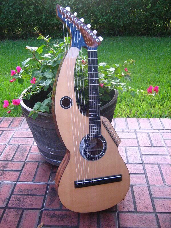

Stewmac no longer carries the ColorTone Dewaxed Extra Pale Shellac Flakes. I was buying a pound at a time and I am fresh out. Does anyone know of a good quality replacement to this product? Stewmac has flakes but not at the pound price and the color is different so I need some suggestions from some experienced members. I use the shellac as a sealer then finish with Seagrave lacquer.
Here is a sample...I finished this Harp Guitar last month.
Michael

WOW .. nice work Michael ... must have been fun gettting the two necks to line up. I just set the neck on Belair harp number two of mine yesterday ...
