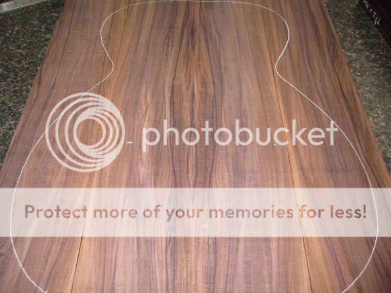

I have to agree with VerHeeberSlapper! I love it too! When Brazilian started getting scarce a lot of veneer mills turned to Pau Ferro as a substitute. It looks awesome when you can get the right board. Has a good long tap too.
Here's a 4 piece back set.
