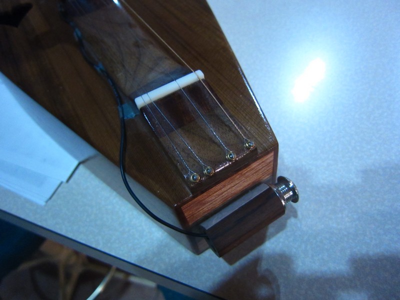

Here's mine. Brass pins go into the tail block.
Steve Smith

Here's mine. The saddle is slotted for the strings, so the pins for the unison strings don't have to be close together.

Thanks for the pictures, they really help.
