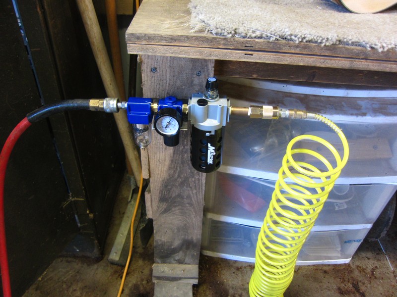

Well, my dynabrade finally got here. I'm stoked. I went out and bought a regulator, oiler, and filter/dryer. I already have a dryer installed, but I figure another can't hurt.
The sander came with the PSA pad, so until I buy a hook and loop, I guess I'll be using psa discs...

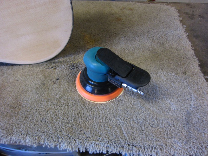

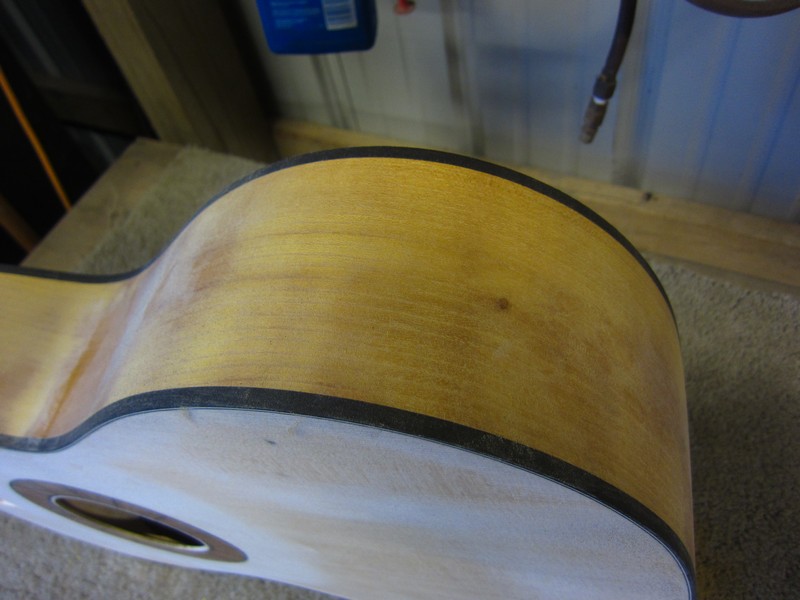

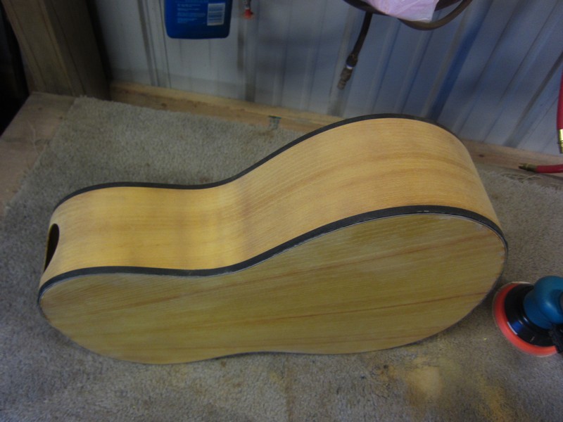

I got the air system all put together, and have the sides of my current project sanded:
So far, I love the new sander!
