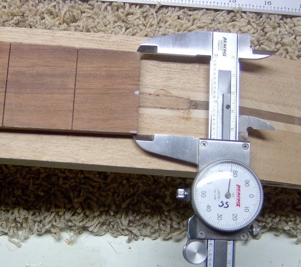

I did it essentially like Filippo and Tom… I marked the taper using a white pencil, free hand cut to within about 1/8 inch on the bandsaw, hand planed down to outside edge of the lines with a No. 4 and made the final few passes with a No. 7. It came out perfect.
