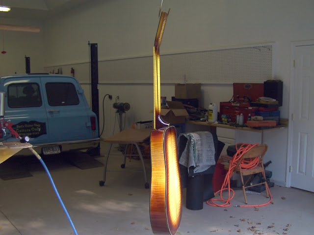

I built a thin line acoustic for a performer and while acoustically it is lacking, electrically however it shines on stage with nearly zero feedback at extremely loud volume.
