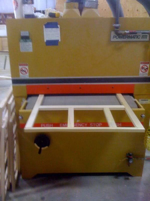

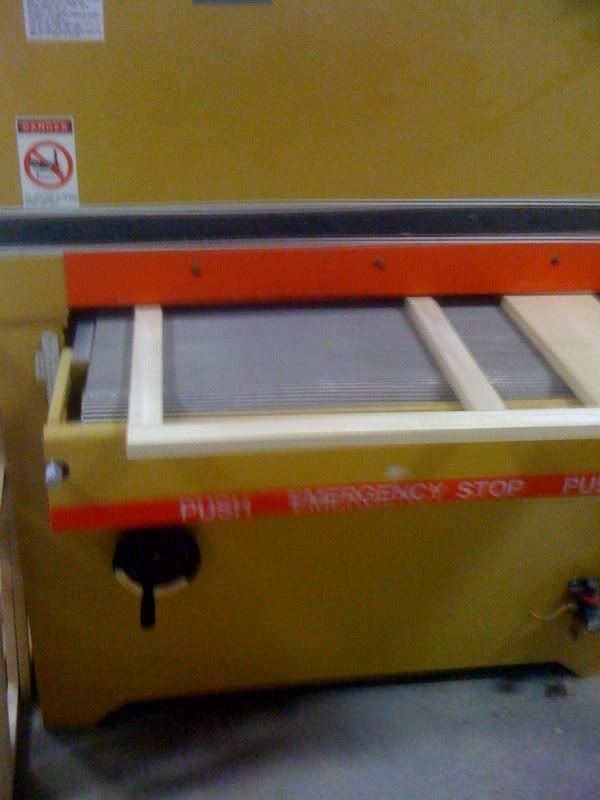

I took a trip to my uncle's cabinet shop to do some of the work I don't have the tools/patience for.
Price of admission: sanding 47 face frames. Ugh.
I had planned glue up for the front, back, and neck as well as making my forms, rosette inlay and thicknessing on all my surfaces.......
However, after 3 hours on the drum/palm sander I only got to glue up.

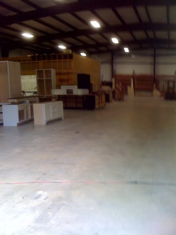

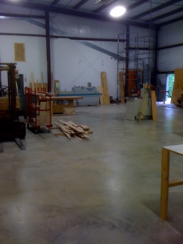

Uncles Shop
25,000 sq/ft
2 table saws, straight line rip saw, jointer, band saw, drill press, edge bander, CNC, clamping table, 3 8x4 work benches, 30x30 ventilated paint booth, more routers than you can shake a stick at...... more than that but all I can think of....
"Paying" rent

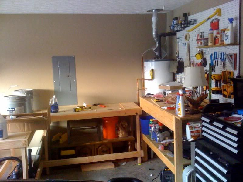

My "shop"

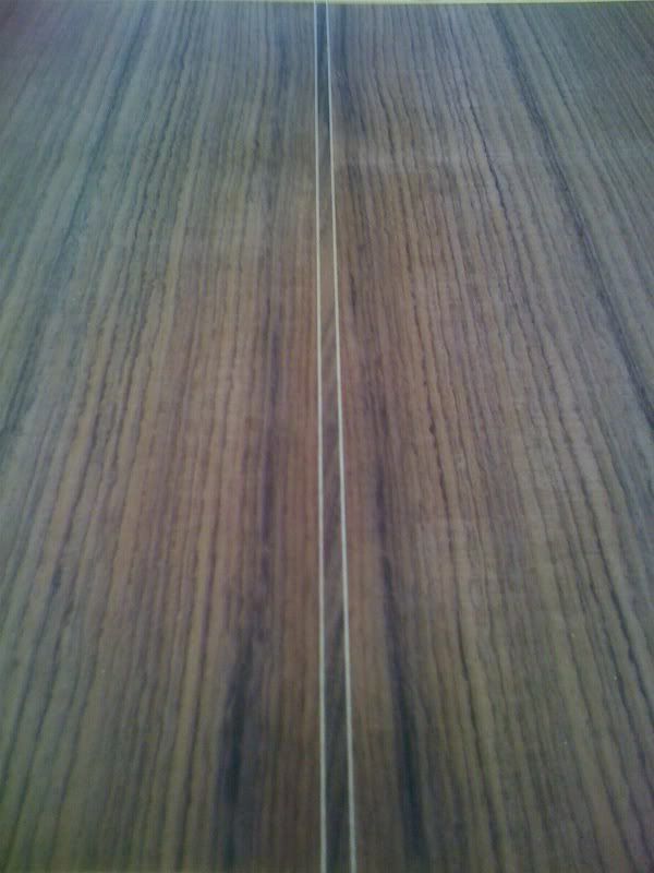

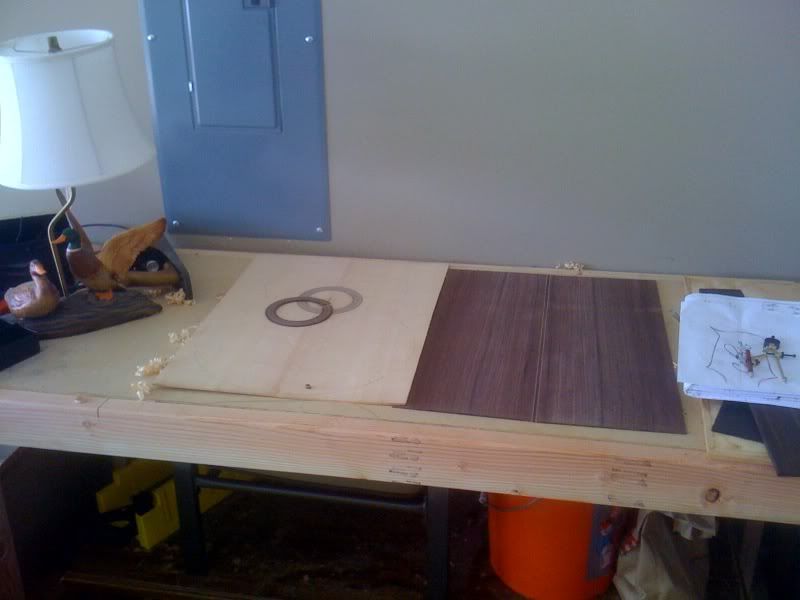

Work I got done

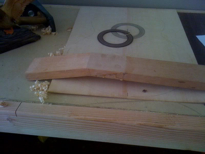

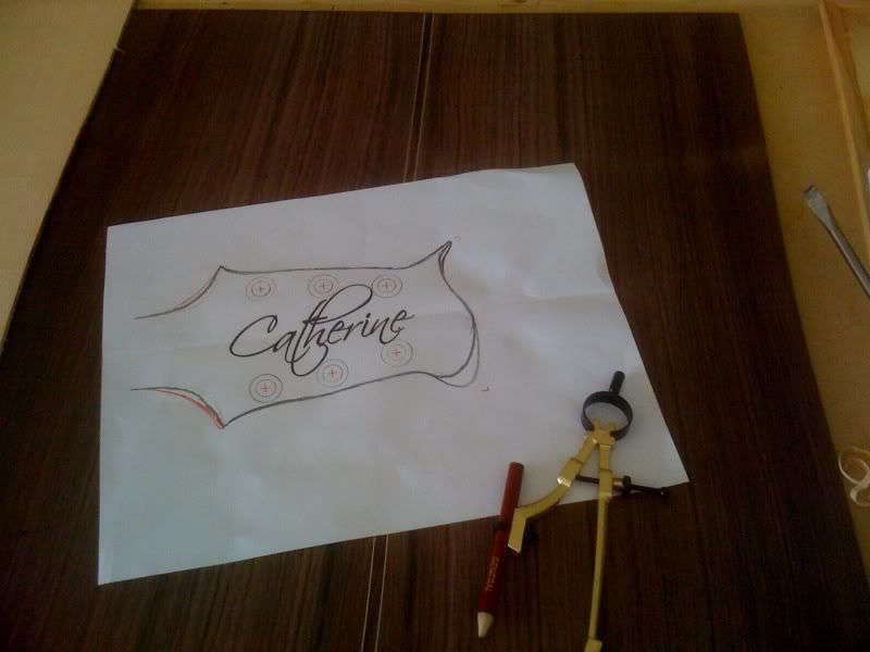

possible headplate design

Back glue-up looks nice, along with headstock design. Your scarf joint is reverse from what most people would do? (Most would have main neck shaft extending to end, with headstock glued on below.) Home shop looks about right for many of us.

Bakwards scarf joint = getting in a hurry.... gaah
still gets the job done... should be able to hide the seam well. It is a nice tight joint.

backwards scarf joint?
funny, that's how i always do it.
why? because it's stronger.
think about it.
