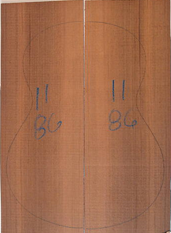

Build #1 is on a bit of a break at the moment while I wait for tools and a few things to come though the post over then next 2 weeks or so. I have decided to start build #2 in the mean time. Mainly as I am bored of waiting and also because that way I can use the skills I have learned quickly enough to stop forgetting things.
I am looking at making something different than my first build. I have sourced some western red cedar tops from a local supplier to me. With my first guitar I had ideas for what I wanted but this one I'm blank. I want to keep cost at a decent level as I still don't want to splash out on fancy backwoods on such an early build, but still want something that goes well with the top Any suggestions on what goes well with red cedar that bends, sands and cuts easily? ( I will be bending by hand [xx(] ).
Any ideas would be great. I will probably make a dreadnought sized guitar with this one as my first is a parlour.
Materials I have lying around are bloodwood & ebony purfling, some scraps of rosewood which I could use for a head plate or rosette.

Walnut bends like butter and works easily too.

Indian rosewood is one of the easiest-to-work (especially bending) woods IMO, and looks good to boot- even the 'lower grade' IRW looks good to me.
Mahogany is also a pretty easy-working wood, but thicknessing can be tricky in the varieties (like sapele) with 'rowed' or alternating grain direction. Good sounding, too.
You can make a great-sounding guitar out of quite 'ordinary' wood - no need to spend a great deal.

East Indian Rosewood I like, but maybe cedar is better paired with less expensive Mahogany (African/plain Sapele/Meranti), Walnut or perhaps Wenge (beautiful dark chocolate brown - cheap but big pores to fill and watch for splinters) maybe.
Also Imbuya (similar to Walnut?), and plainer Maple are well priced and reasonable to work.
All bend quite well and are inexpensive. If you get wide sides, you may get bindings out of them too. (Especially if you decide on an OM, they're not as deep as dreads) Stealth bindings, as they are sometimes called, can look really good with contrasting purfling.
