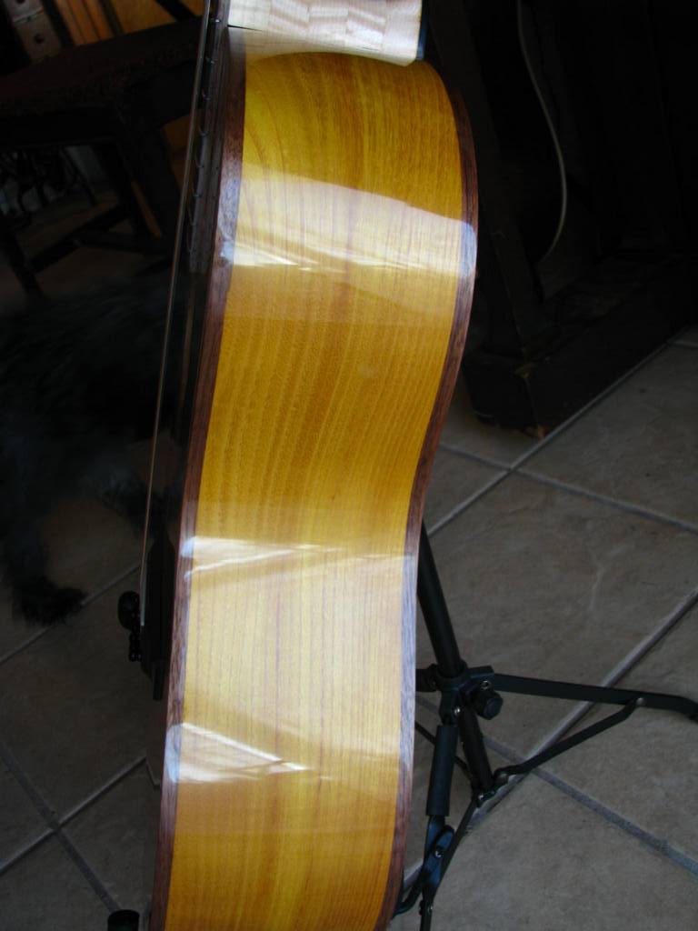

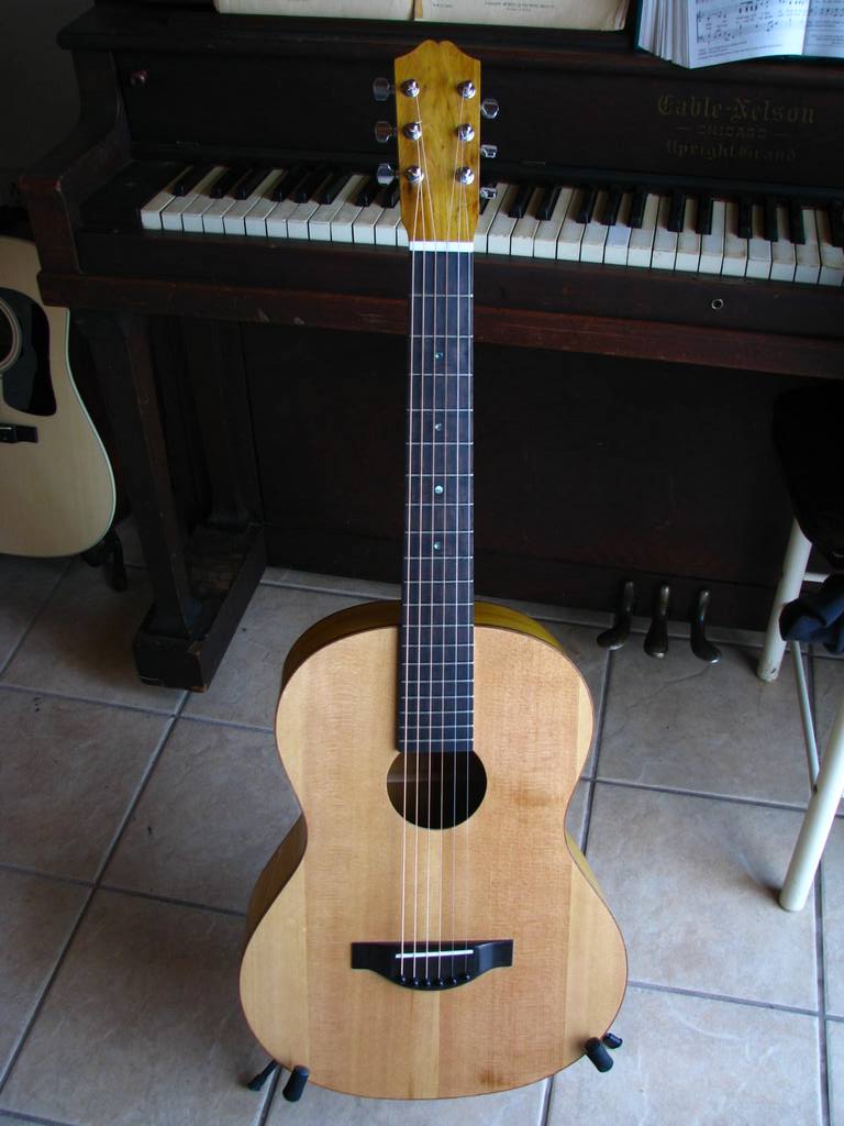

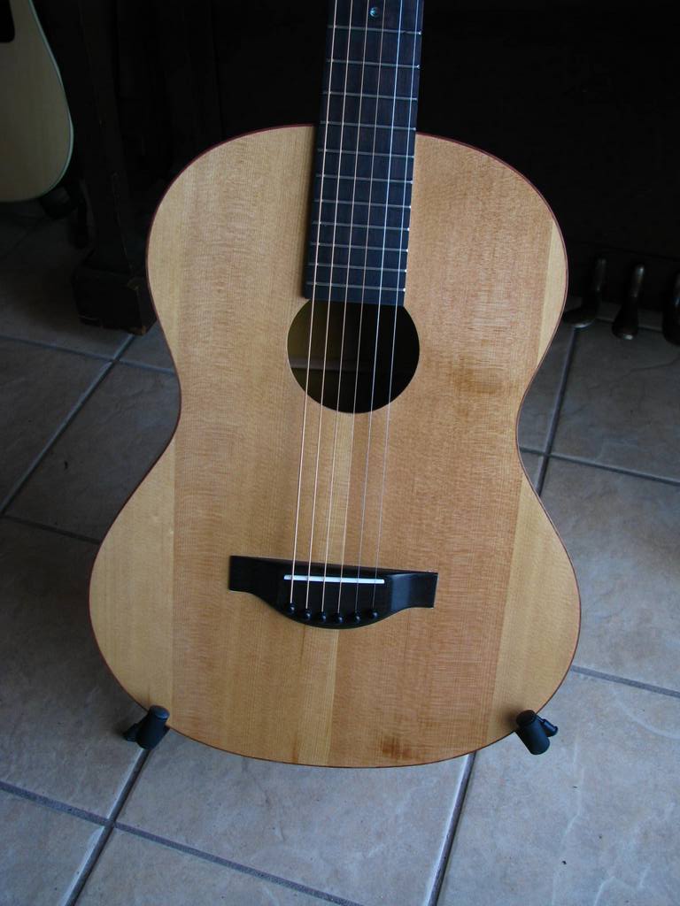

Howdy folks,
I finished this one up a couple weeks ago. It's actually the first guitar I started, but mid-way through I decided to build a classical first, since the classical seemed easier and simpler to make.
This is kind of out of the ordinary. It's a steel string, but I made it with a neck that's 2-1/8" wide at the nut, hoping that that would help me play fingerstyle more cleanly, and with the 12 fret at the body/neck joint. Also, the body is on the small size. I guess you might call it an OM? Anyway, I have a dreadnought, and it's too big for me to play comfortably; this one fits me just right.

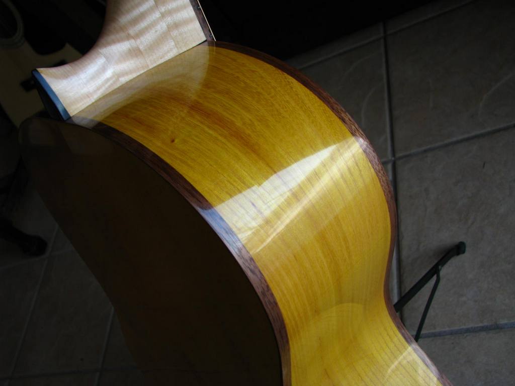

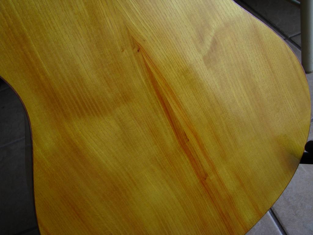

The back and sides are osage orange from my back yard. The neck is curly maple I got off of fleabay, the top is recycled from an old piano soundboard. The fret board is black walnut, which also grew locally. The bridge is ebony. The bindings are walnut.
Any comments welcome.

More pics:

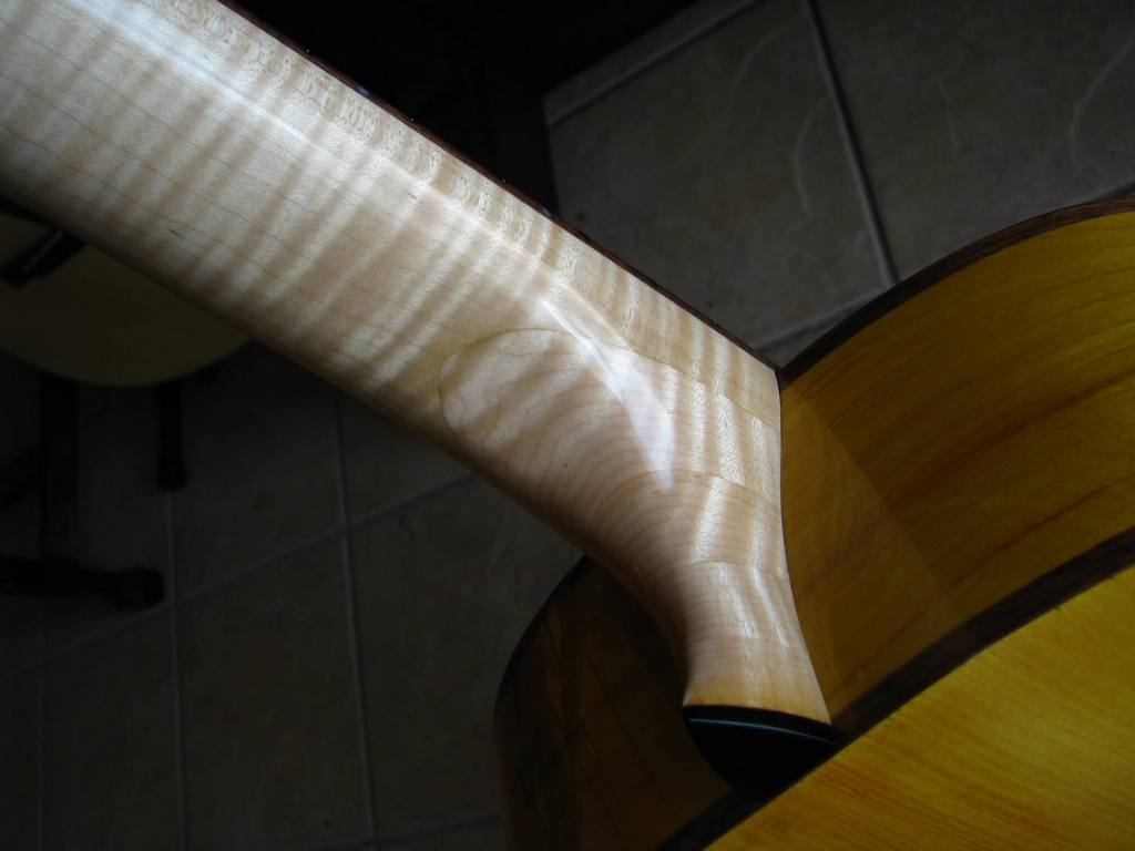

nice simplistic approch. I notice a fair gap at the top of the neck and body joint next time out try to floss this in to a good tight fit everywhere.

Looks good! Interesting in it's simplicity! Good work for an early guitar.
Thanks!
Yeah, I know it's not perfect, and I did try to close the gap, but it wasn't cooperating... How do you use floss to fix that? :o :mrgreen:

Very nice and very adventurous to build from scratch on your first attempt. I like the osage orange with the walnut......good combo. I would like to hear this guitar with the bridge almost in the middle of the lower bout. Nice figure on the maple as well.

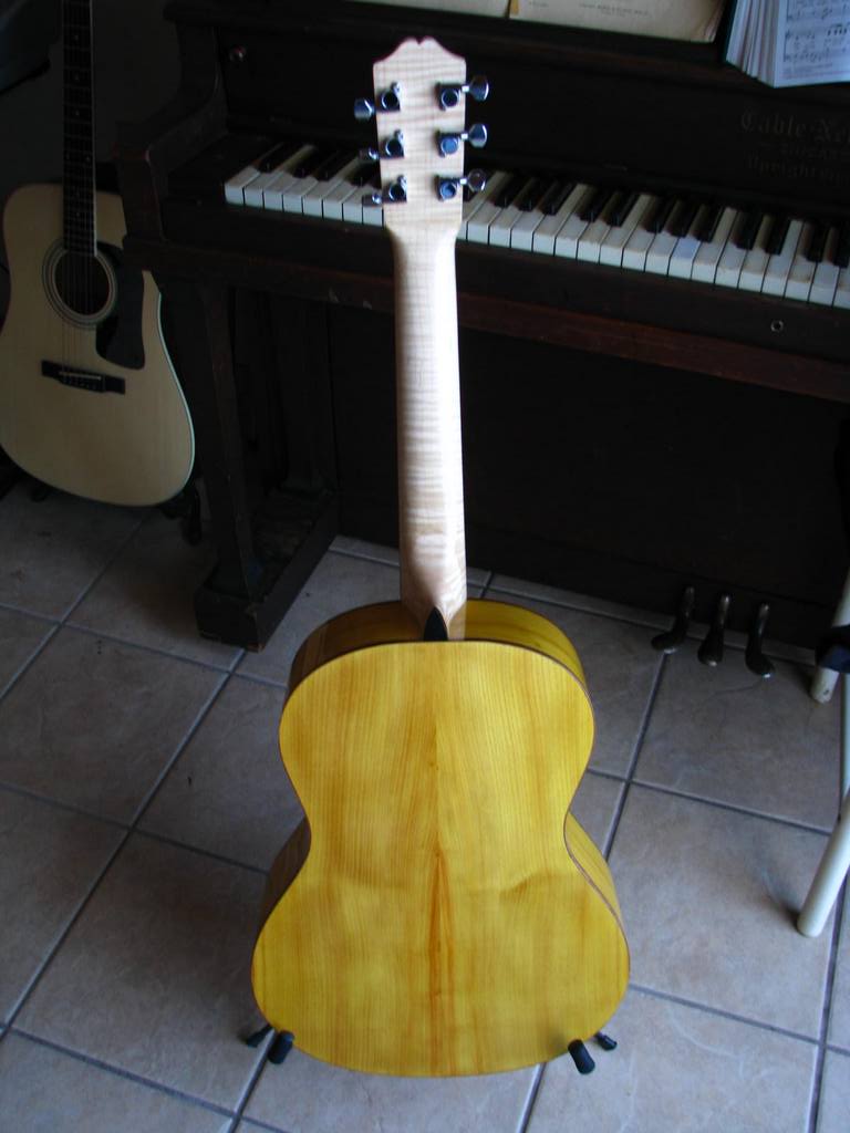

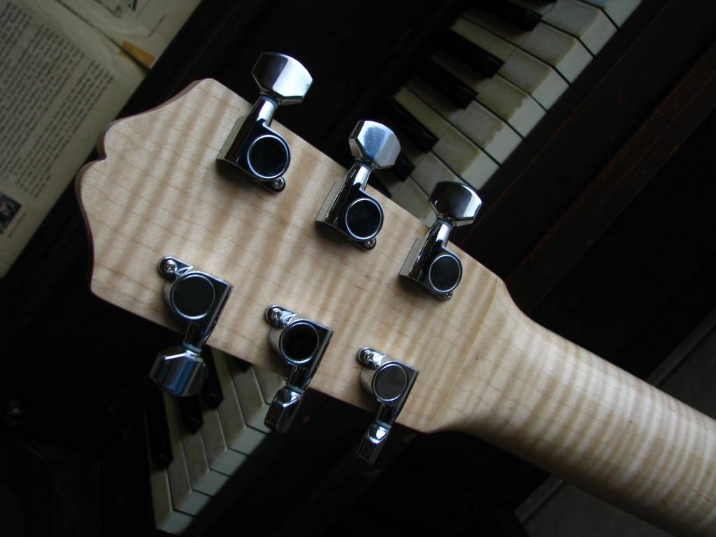

I notice you have used a "six in line" tuner set as the trebles are upside down. Was this part of the plan to keep it simple and use up what was available to make do?
Bill S.
I just used what Grizzly sent me. ;) I THOUGHT I'd ordered a set of 3 right hand and 3 left hand, but apparently not.
So yes, it was simpler to use what I had than to buy more. :mrgreen:

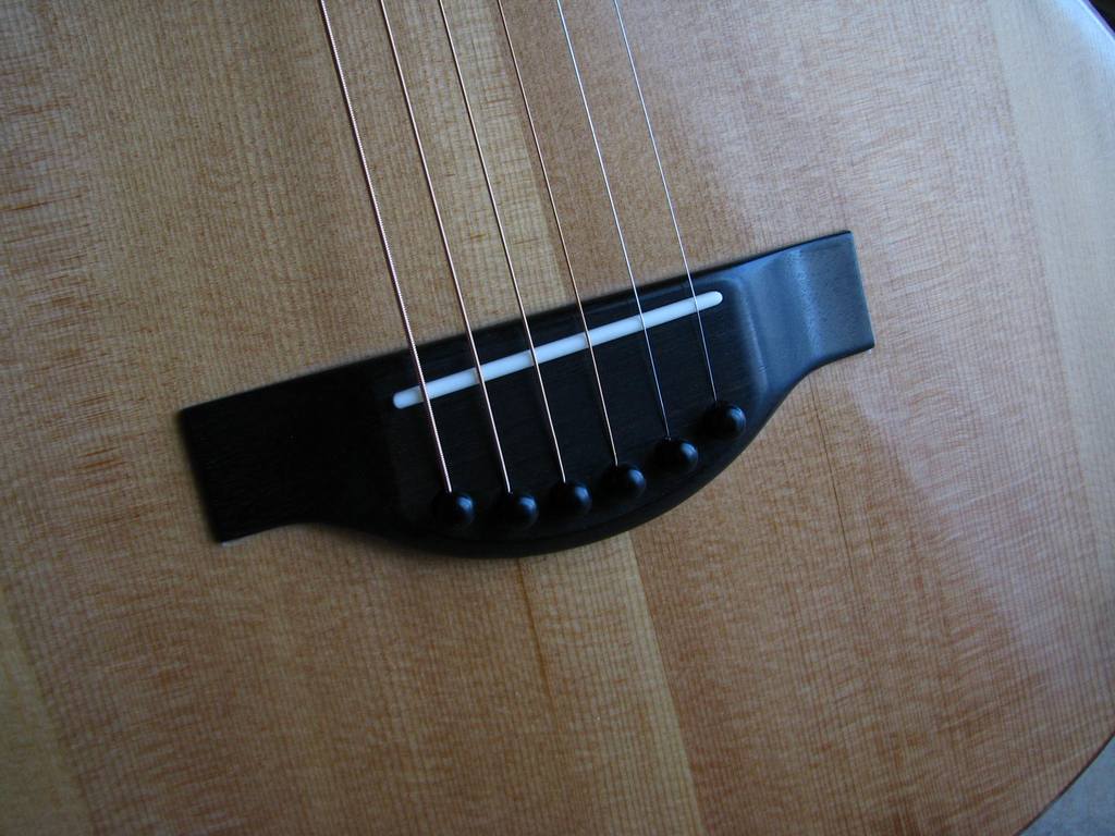

The extra wide bridge and placement of the pins makes for very little string break over angle at the saddle. Adding string ramps would probably make a significant improvement in your tone.
Thanks!
Flossing is a technique using sand paper to fine fit the neck to the body and proper alignment. My dear friend Hesh put together a fine tutorial on how to do this. The tutorial is for a bolt on neck but the flossing part to fit to the body would be the same no mater what neck joint is used. Here is a link to it.
http://www.luthiersforum.com/forum/viewtopic.php?f=10102&t=15022%22

I love it - it's got some nice mojo going on. The tuners fit with the whole vibe of the guitar and I like the top too. It's a shame most buyers of high end acoustics demand perfectly white tops - I prefer some color like this one. Keep building them. :D
