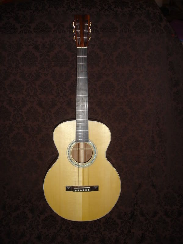

Here's my humble version based on the L-1. Of course the slotted headstock isn't very Gibson, but I liked the neck. I've got another in the works with a sinker redwood top and walnut b/s.

Yes Jack, what bracing pattern does the one you're repairing have? Waist dimensions and scale length?
Very nice build Kevin! [clap] [clap] [clap]
What bracing pattern did you use, and what is your scale length and waist?
Thanks guys,
Joe

Thanks for the bracing description and measurements Jack as I've never seen one of these in person. I've used that bracing a couple of times with very good results. I was looking to capture the ladder brace sound while avoiding the potato chip curl that ladder bracing is prone to. The lengthwise "tone-bar'' braces work to counteract that tendency. All in all that bracing seems to offer a nice alternative to the X.
