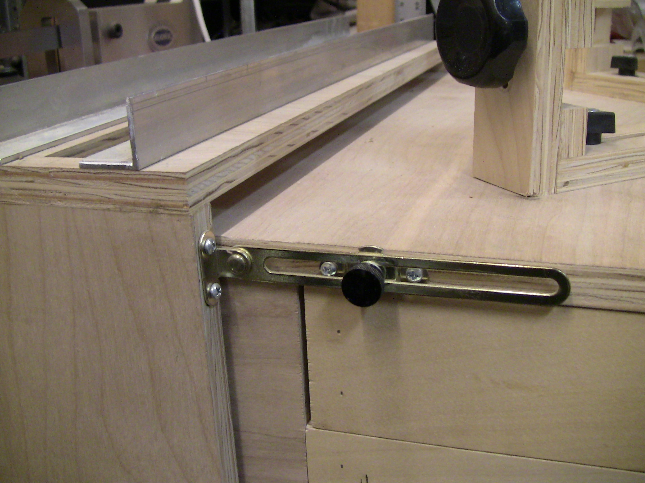

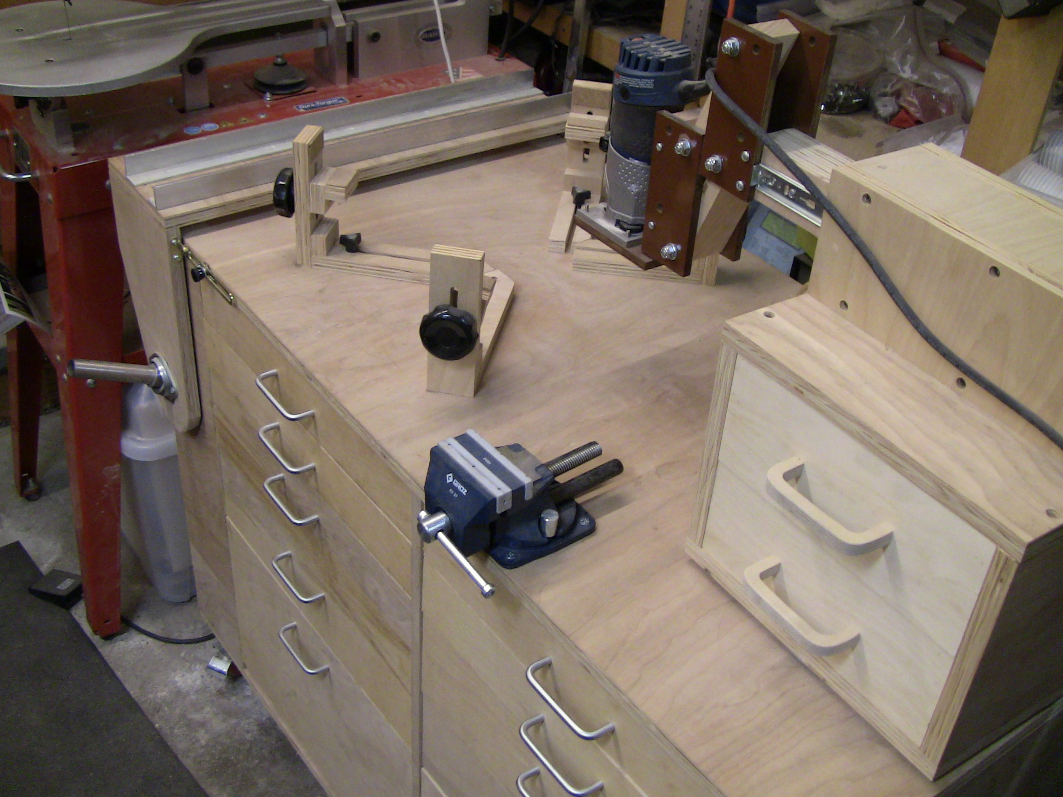

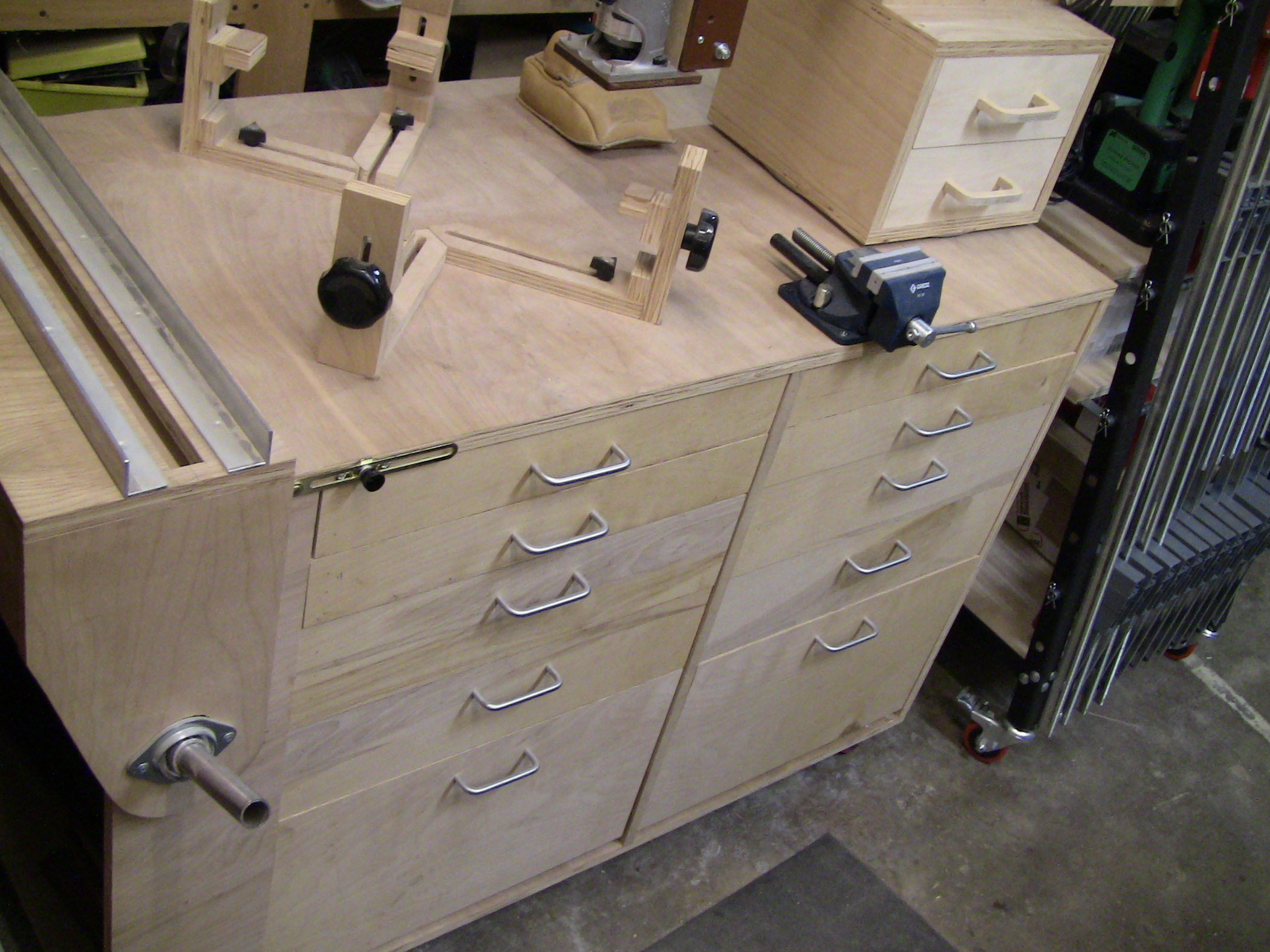

As promised, here's a picture of my radius jig. I told everyone it was simple. I use a 1/2" template guide and a 1/4" downcut bit. I believe I'll change it to use a bigger guide and a bowl bit. I think that will do the same job with a few less strokes. I done my first 5 with a plane, some sandpaper, a straightedge and radius guages.

I really like your setup or should I say your routing station. I like to save space and incorporate storage as you did. Nice job with that. I think this design would serve me best as I could just add it on to the end of my router table. Although it might work out better for me to use the the opposite swing like Woody's as I can have the top stationary router guide level with my router table .
Woody,
Do you find the need for the neat bearings like Dave and Mario use or will a few nylon washers do to keep down any binding if there is any binding. I also like the slot with a collar use as opposed to an angle guide. I also like simple if possible. That's a pretty good cost savings also. Plus I like the flexability to change to standard single radius although I probably will stay with the compound once I start to do them but still like the option if you know what I mean.
