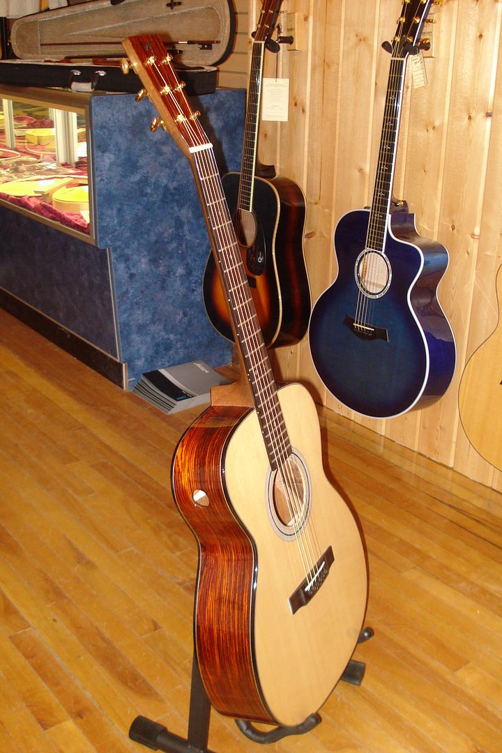

Strung up the 000 yesterday and it sounds real good already. This was a great learning experience, 1st sides bent with heat blanket and bender, 1st side and back set thickness sanded with my new drum sander, 1st Zpoxy grain fill and 1st buffed with a buffing wheel and menzerna polish. It came out quite good, with a better finish than the previous hand polished guitars.
These aren't the greatest photos but give an idea of what the guitar looks like. By the way these were done at the local guitar store's acoustic room, the guitars in the background are not mine.

This looks great. I really like the rosette. What is it made of and can we get a close up?

It is a Martin 45 style, with paua abalone in the center.

How does she sound? What kind of soundboard?

She sounds real good for a 1 day old guitar, probably the best of what I have built for a starting out sound. I think it is a little tight but has opened up even over its 1st day of life.
The soundboard is Sitka and the bracing is Engleman, a well known Canadian luthier told me he uses engleman on most of his tops and I have on 3 and the 2 I have completed thus far have sounded real good.

Very Pretty guitar!!! Nice Job. What kind of finish did you use?

Very nice! [clap] [clap] What is the binding, Indian rw or ebony?

Congratulations Fred [clap] [clap] That is really a beautiful instrument! The cocobolo really has some great color and the finish is beautiful. What finish did you use?

The finish is Behlen Instrument lacquer over Zpoxy grain filler, the neck is dovetail, the bindings are Ebony and the BWB purfling is pre made dyed wood from A&M in Cambridge On.
The Coco I bought from a Ebay seller in BC and was not real happy with how it looked, the photos on Ebay were not that good the figure looked better than it realy was and several issues were not apparent. The wood was re sawed to about .300" and quite rough so I didn`t see how good it could look. When I got my Delta drum sander I decided to sand that Coco set for practice as I did not like it as much as my other sets so it was expendable if I screwed up. It looked better after and I figured out that I could CA and sanding dust fill the defects but I still set it a side. When I completed my bending machine I again went for the Coco for the first set to bend as it was still I felt expendable, but after bending the sides I decided it was not so bad looking so used it. As I built I fell in love with the set and now am very glad I used it.
