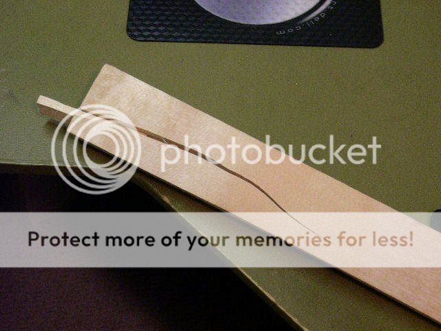

Sorry Wendy...don't mean to detract from your post...we get a little silly around here from time to time. But mostly we're just passionate about guitar building. So anyway....here's a picture of what you DON'T want your bracewood to do.

Notice in the picture above that the split line is not straight. My grandmother's stockings have straighter runs in them than this bracewood does.
Essentially you need to identify runout...or areas of the wood where grain doesn't run straight to be more specific. To identify this runout take a field hatchet or dull chisel (really dull)...or some other object in your shop that will function in the same manner...lay it perpendicular to the grain...and hit it. You are looking for a straight split.
Once you got a straight split saw off a piece that runs the length of your bracewood stock, about an 1/8 inch thick...hold it in your hands and twist it. You are trying to break it. Now you are trying to verify runout on the second plane or axis. What you are looking for again is a break that runs in a straight line. NOT one that runs in a curve or crosses the stick from one side to the other.
More will chime in here that can explain this a little better. I learned this here...and thought I might pass it forward.
Chris

Chris - Those look like PRE-SCALLOPED braces. laughing6-hehe

Chris,
In my experience, you almost never (probably always never) get a representative split by splitting off the edge of a piece like that. As the thin piece comes off the split will tear across the grain and not follow the grain line. You need to split in halves, or least in larger sections so that the pressure on each side of the split are equal. I am not saying anything about the quality of that piece of wood (it looks like some of mine idunno ) I am just saying that you might not be getting a true representation of what you are looking at. I know that you have done a bunch of work on this stuff but I thought I should just make this observation.
