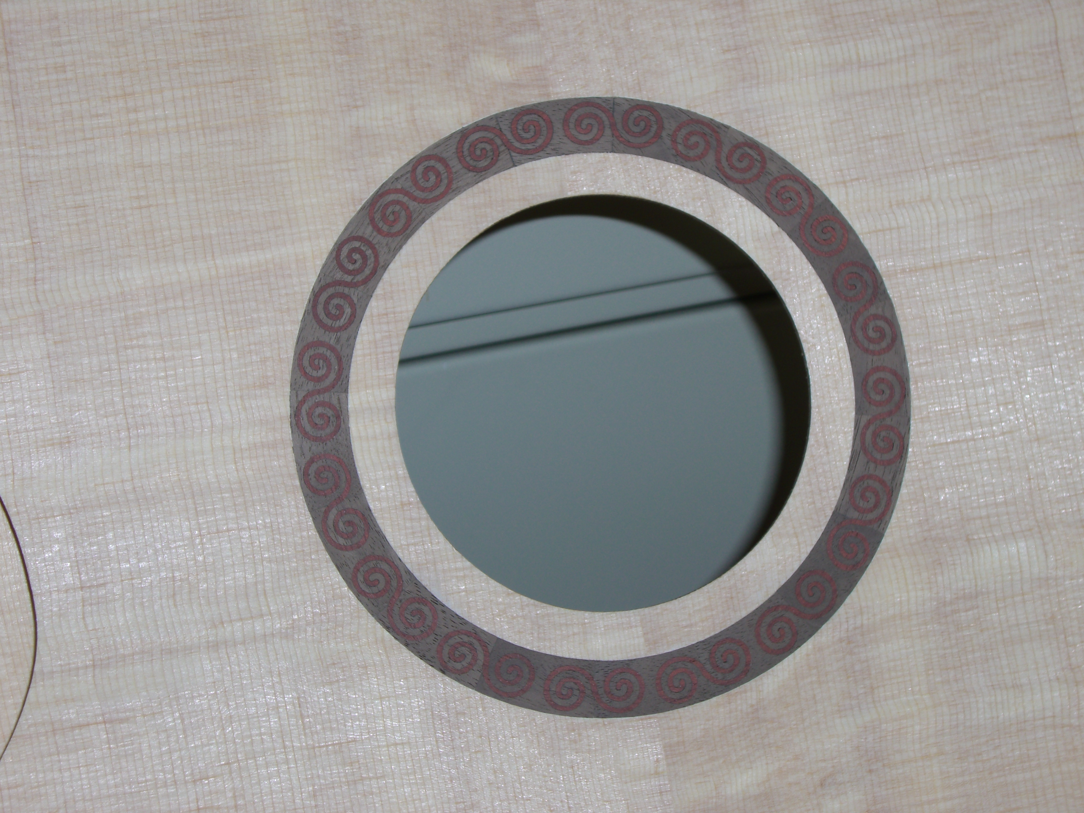

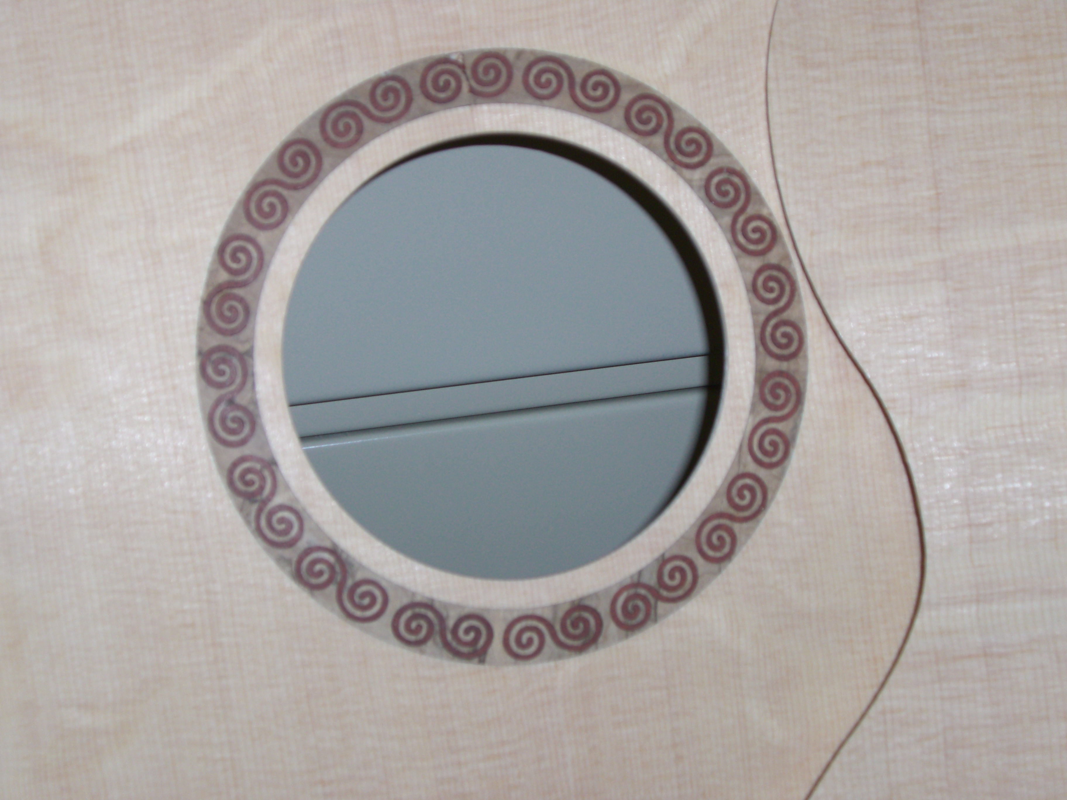

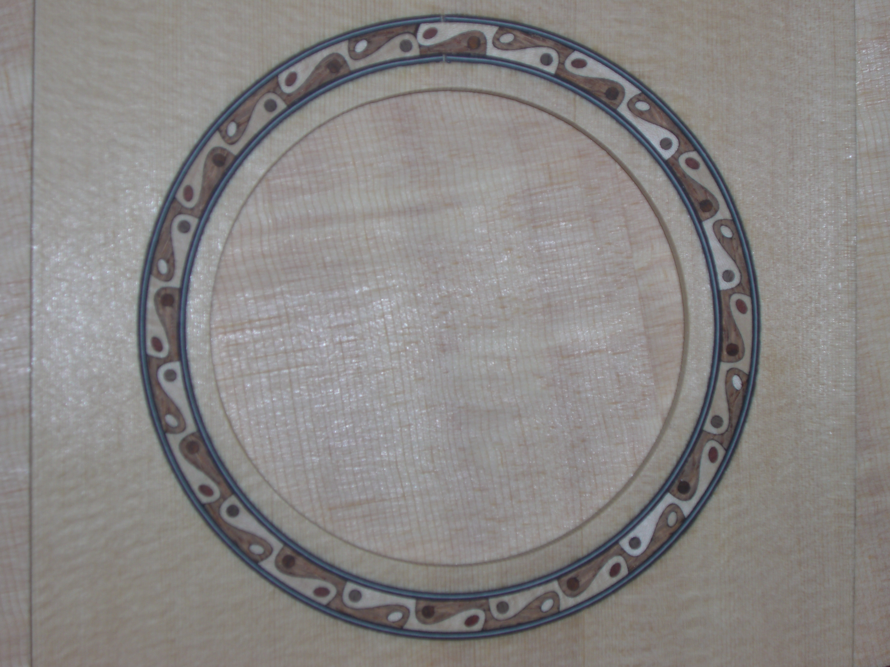

I've been playing with my laser engraver again....and come up with some new rosette designs that I think I'm going to use on my next batch of guitars:
Wadyathink?

What kind of laser engraver and how did you do the dark and light?
Mike (cool stuff!)

All three of those look really great!
It sounds like you have some cool tools to play with.
Blain

Rosettes? I only see three very nice spruce tops there :D
Honestly, those are cool looking rosettes.

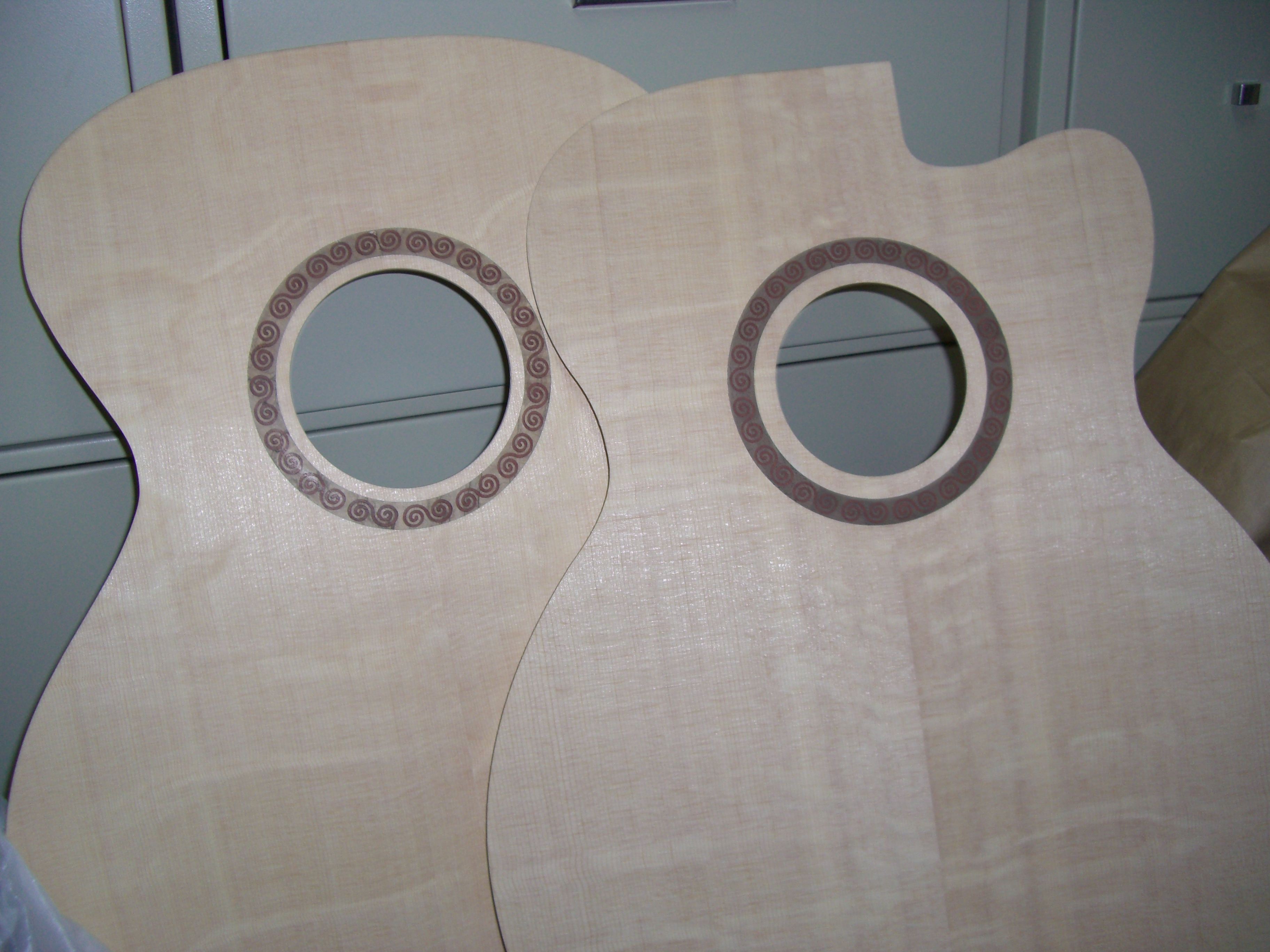

Thanks guys. I'm still messing around with various designs - I have some that don't "conform" to the normal circular soundhole/rosette convention. I'll audition those as and when I think they're ready.....

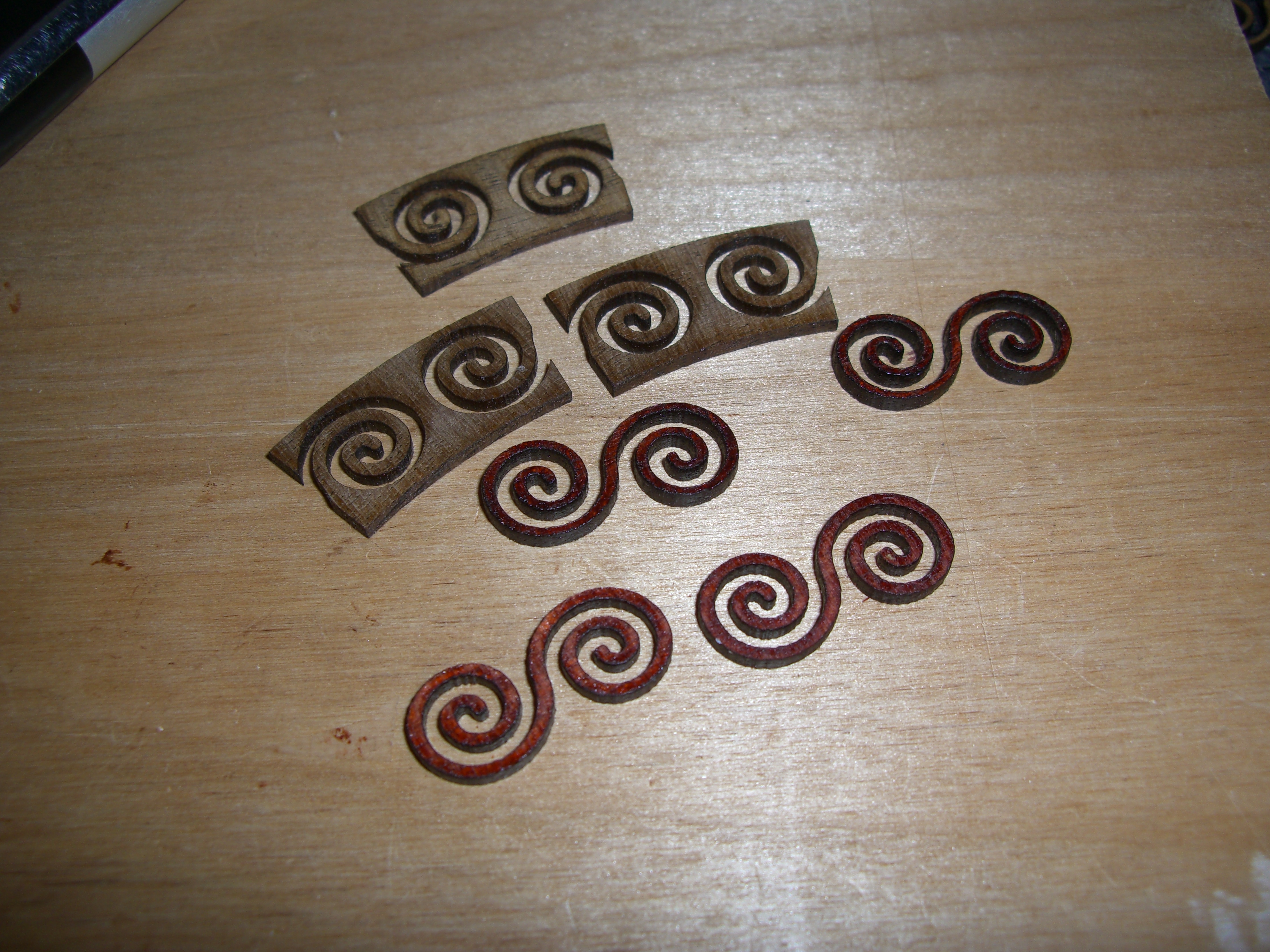

Mike - I have a 45W Epilog 36EXT laser engraving machine. It has two modes of operation. One, raster mode, which allows me to engrave on a surface (like wood, cloth, some plastics, anodized aluminim). I can laser engrave a picture into a piece of wood (for a box lid, or soundboard motif, whatever) with this mode. Second, vector mode, which allows me to accurately cut out shapes from wood, cloth, etc.... It's this second mode that I use to cut out tiny pieces of a jigsaw puzzle of 1/16" thick pieces of wood to make the rosettes. I also use this mode to cut veneer to do marquetry.
Here's a piccy of some of the spare pieces (yes, I always cut more than I need in case I break some) from one of the above rosettes. This will give you an idea of how it works.

That's very nicely cut! I am particularly intrigued by the spiral pattern. You must know that its a traditional Minoan interlocking spiral? Each end of the spiral nests in the other end of the one beside it.
I used that spiral pattern a few years back, without the advantage of a laser engraver. Analog hand operations for the whole thing.

i really like the last one [:Y:]

I like the last one also. The first one doesn't do anything for me. Doug's is nice.
