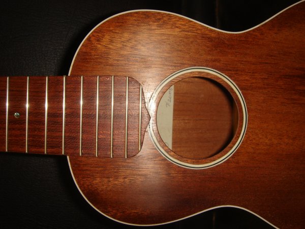

That is odd... unless the body join isn't at the 12th fret. Measure the fretboard along its centre line from the nut to the 12th fret to get the right dimension. There's nothing "wrong" with the 12th fret not being at the body joint by the way, it just isn't usual. (In fact, I am building a soprano uke at this moment, which has 13 frets to the body joint).

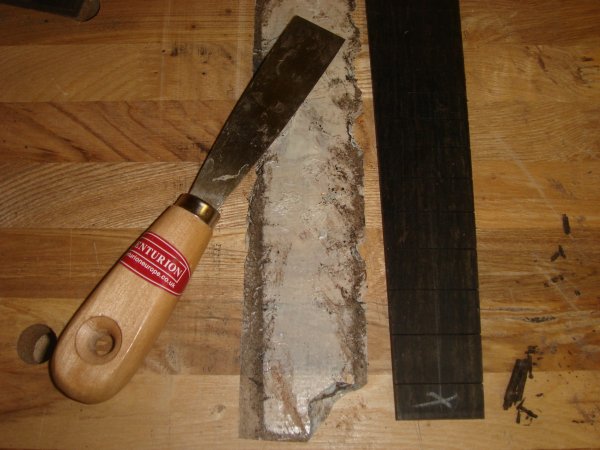

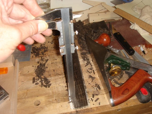

That's a good call about Hana Lima, Philip. I have dealt with them a few times (from here in the UK). By the way, their pre-slotted fingerboards are for a 13.5" scale, and are LONG! More useful for 14 fret necks, otherwise you tend to start overhanging the soundhole at the other end.
They are also, in my opinion, much too thick and would result in having to have a bridge that is too tall and strings too high over the body, but its an easy task to plane them thinner (before fretting). I simply fasten them to a workboard (fret slot face down) with double sided tape, and then use a good smoothing plane on them, and testing for thickness at each corner and the centre quite often.
You do need to be careful getting it off the double sided tape afterwards as it is fairly fragile. I work carefully using a thin palette knife.

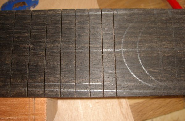

Here's what can happen to the fingerboard using the Hana Lima pre-slotted one on a 12 fret neck and a standard bodied uke. There are too many slots for comfort. And I have already cut the last one off!
This is a Hana Lima fingerboard with the 13th fret over the end of the neck/body joint, with the soundhole marked on it in the normal position, and also a bit further south.

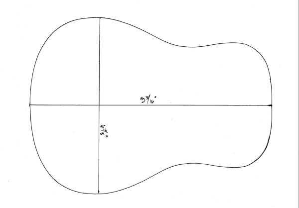

The ukes that I am now building are sopranos, but to my own plans, and even of a different shape... basically like this... which I based on the shape of my Martin 12 fret to the body dreadnought guitar.
Rod

Thank you Rod, Philip, and Todd for all of this information.. Those pictures are great Rod!.
