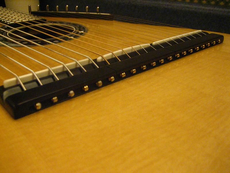

I have built 3 Harp Guitars with this bridge. The most recent one holds 21 strings. There is a combination of an X brace and fan bracing beneath it plus a maple bridge plate. I used a closley fitted caul taped on the inside when I glued the bridge in place. I hope I never have a problem in the future but if I do this will make a beautiful wall hanging in a resturant some where.
Michael
