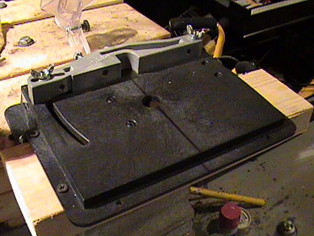

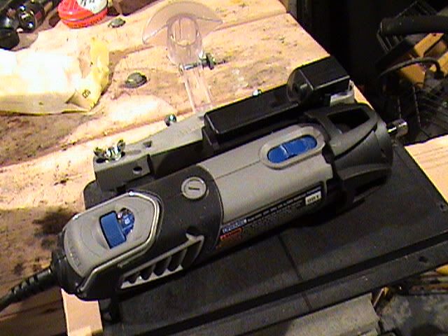

SO, I have the new dremel 9000, but the old school dremel 231 routing table. They did not match up, dremel sent me a conversion kit free of charge . Problem is it also didn't match up , but solved the mounting problem. So i am making a board to mount the dremel too . i had to cut a hole with a hole saw . so here is the set up , and the shim I made for the neck so I can route in on center . Also a picture of fall in Maine . Next set will be to make the accual route , perhaps I will make a video for the route .

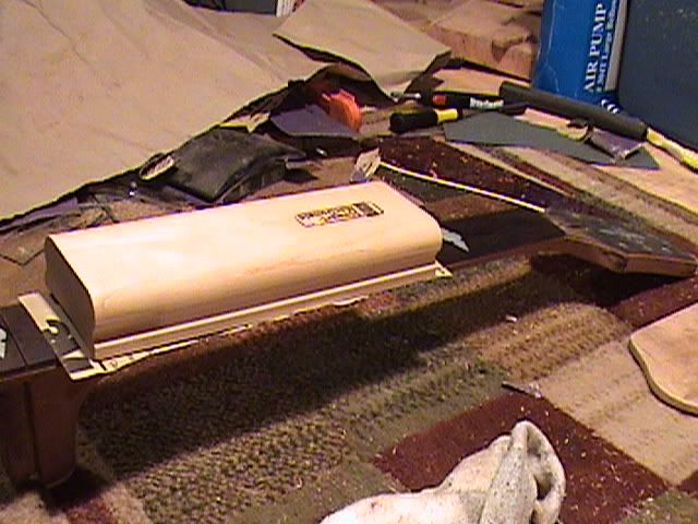

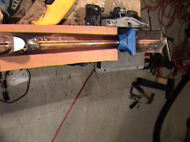

WOW!!!!!! Ok I ran into issues . Pretty much I had to rebuild the entire neck. So I made the shim and tried routing the channel . The dremel router even after trying to do multiple shallow passes , liked to bind ( using a fresh bit and fastest setting on the newest and most powerful dremel set to the highest speed. It ended up going crazy, grabbing the wood and digging a hole so deep the back side of the neck was so thin it pressed inwards like a peice of veneer.
So on to rebuilding the neck. I saved as much of the routing dust as possible and put it into a pot. I made up a batch of hide glue and made a fiberboard mat of wood chippings , dust and hide glue. I lined the channel with this mixture . Until it was high enough to where the original route should have been cut. This then dried for a few days. I fit the trussrod in the channel, and put a strip of wood on top of it , using hide glue again. I had a strip of snakewood I had laying around so I used that. I scraped the piece of snakewood flush with the neck, and filled in any low spots with the tone woods shavings mix, then scraped again.
Now we have the chips and indented back of the neck to deal with . I filled the indent and chipes with other pieces of snakewood / tonewoods dust mix which by now has rosewood and ebony sanded down in the mix which also includes maple ,mahogany, and walnut .
scraping , sanding, and filling little gaps, until I was satisfied it felt great .
Of course none of this will ever be noticiable once the guitar is finished . Its such a stronger neck now , with reflief adjustment. Knocking on the neck in every spot like you would knock on someones door , the tone transfers so much better now as well .
Image Image

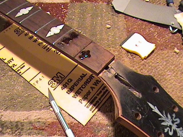

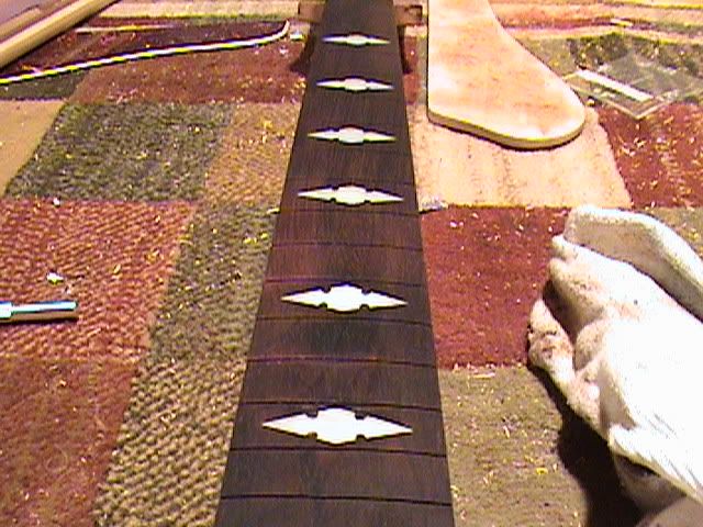

fret board being reattached , and 2 days later fret board gouges being filled , using dust i scraped from the underside of the board .

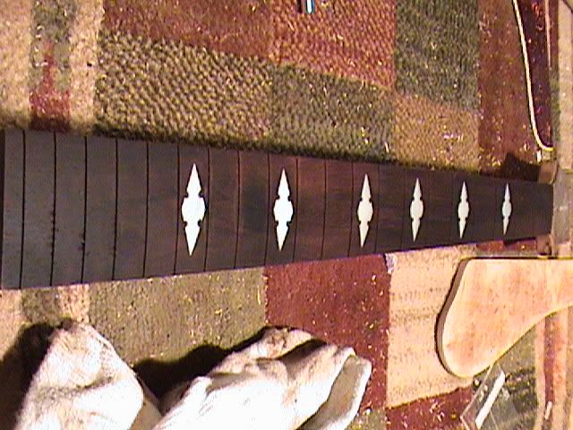

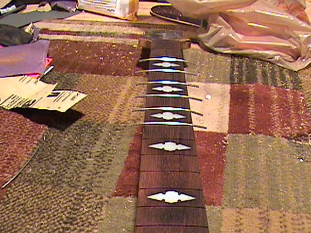

9.5 radius block arrived, so I got to it on the fret board. Coming along nicely.

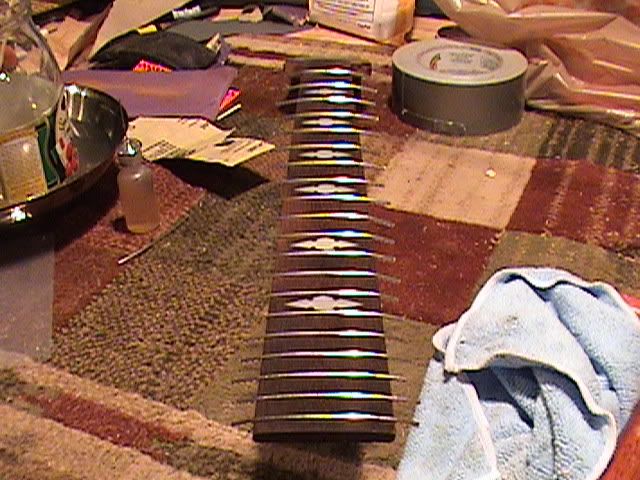

After recieving the wrong sized frets in the mail my new frets have arrived. So to the bat cave I go . The first slot was a little wide so I decided to use glue . The first one needed to be clamped but te rest were just fine on their own . I will let this dry, and get to trimming and dressing at some point .

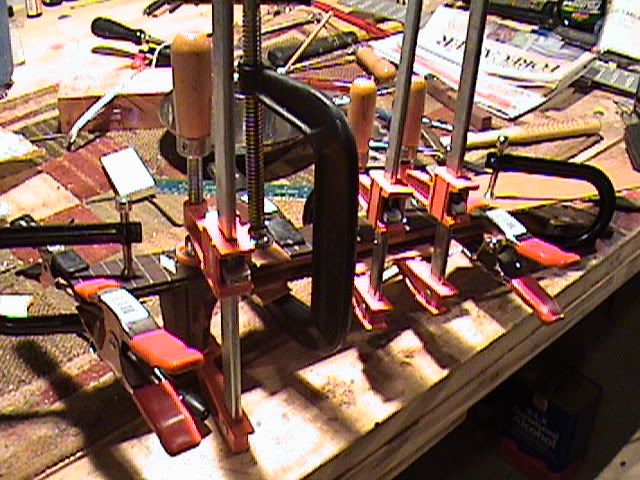

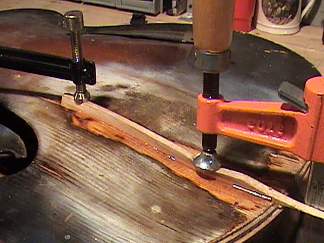

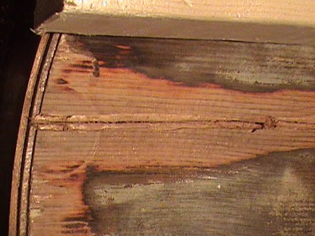

So I have been out of town for some time but I am back and working on my project. Upon returning , The crack opened up, I steamed it again and tried to close it but it wouldn't cooperate. This will really make your ladies undies bunch up. I routed a grove, and will inlay it with matching grain red spruce sourced from west virgina.
Since this a darker piece of the sunburst no one will see it anyway, but it was the only way I could close the crack. I know some "expert" will be on my ass like yor destroing it , but no this is the right way to close this crack. fudge original finish seriously go sip some tea with your pinky out. Ohh and a pictur for kids who read this in 75 years . This is our president! Yes we are much cooler than you will be in 2085! I hope who ever has this guitar by then because I will be maggot bait , is loving this repair because it will have held up.

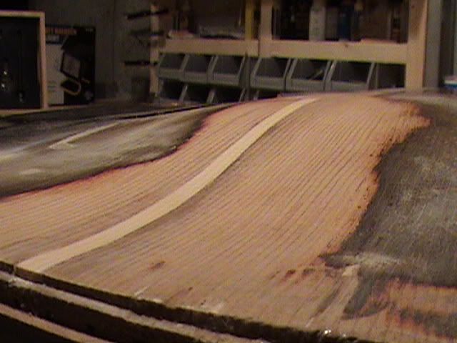

Steamed this last night and it sat in form for 24 hours , this is the filler strip when the glue dries , I will plane and scrape this flush , should be prett invisable , we will see .

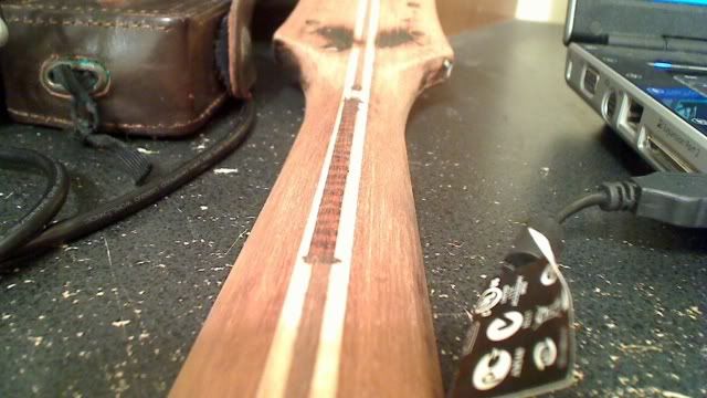

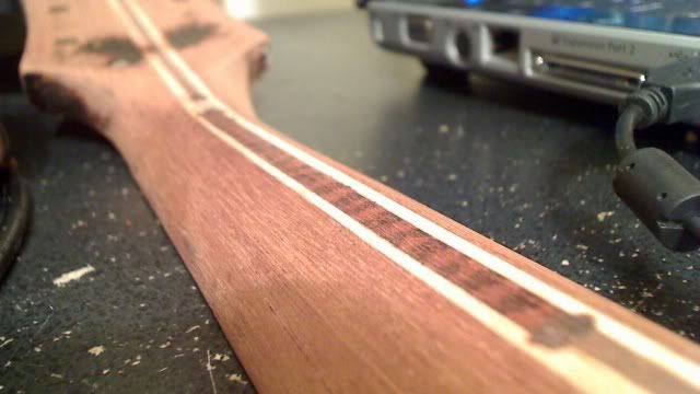

Stormy outside , cut a bunch of holly and steamed it up. Holly bound neck. Needs to be scraped and made all pretty but I think the holly looks really nice

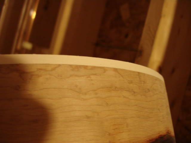

PostPosted: Wed Dec 22, 2010 8:12 pm

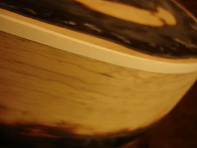

here is the back body binding , American Holly , wow that birdseye maple on the sides is sweet

Sorry, but that crack repair was lame. The splint didn't extend the full depth of the crack so it will not hold up for long.

It accually did , I tapered it and made sure it fit in their nice and snug I then steamed it , so you can imagine what the soft steamed wood fitting in there was like being clamped tight ,I also steamed the crack "shut" before fitting it in . It's not going anywhere trust me . At some point I should try to fit a camera inside to grab a few pics of that repair from underneath .
