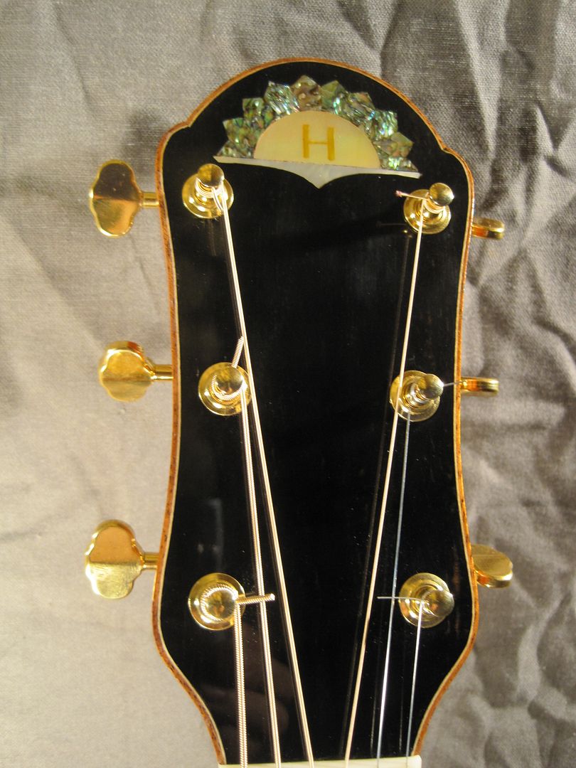

Here is what I came up with, measurements for tuner locations came from Michael Payne's OLF SJ plan sheets
Tuners are on 1.35" centers, 1/2" from edge. First tuner (low or high e) is 2.7" from nut. Overall length is 6.7", width at widest is 3.4". Width at nut is 1 11/16"
Thoughts? Input?

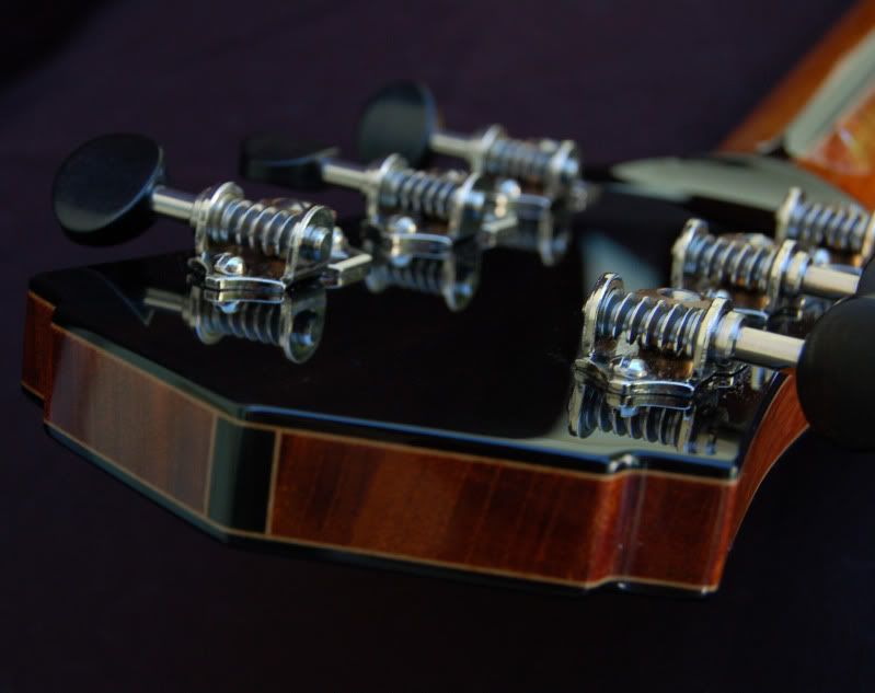

Haans, I've long thought that's the best looking non-F5 mandolin around.
Here's mine. Borrows a bevel from the mandolin/banjo world.

Mike, I space my tuner holes 1.5" centers, seems to leave a nice amount of room when using a string winder or just the fingers while tuning.
Everything else seems fine, although for my taste I'd like to see more at the top of the head after the top tuners....
Thoughts? Input?
Draw on the tuner keys too. Usually they go above the post centers, which I think will look odd being so close to the end of the headstock. Though there's nothing stopping you from putting them on upside down, either.

Dennis, Rod, thanks. My headstock is 6.7". And I don't want to graft on any. I will remember this next time when I spec out the neck. I have plenty of room to bring tuners closer to nut, and add space between then. The OLF SJ peg head is 7.5". And I was first attempting to keep location the same. If I pull them back, then angle to nut will be greater on low and high e. Think that's ok? It's that angle I'm worried about.

OK, went back and came up with a modification that seems to answer the observations.
1.6" centers (several guitars I have built have used that), pulled first tuners back to 1.8" from nut. Still will have to graft on small wings. But I like the width. Nut model is 1 11/16 x 1/4, inset is 1/16" on each side, then I used even spacing. Tuners are 18:1 gotoh, .2" shaft
Better?

I agree with Dennis that you should draw in the the tuner shafts and keys to be sure you like how they are positioned/distributed along the edges. I almost screwed up my headstock design by not doing that. Fortunately, I caught it before drilling holes.

It's probably just me, but for some reason the E tuners look a bit too close to the bottom corners of the headstock. Maybe it's because of the difference in the distance between the E tuners and the bottom corners and the distance between the D and G tuners and the top corners. If it was me, and it's not, I would either shift all the tuners upwards (~1/4"?) or leave the D and G tuners where they are and compress the others upwards toward them to preserve the area at the top for inlay space. It's your design of course. I like the overall shape of the headstock.
