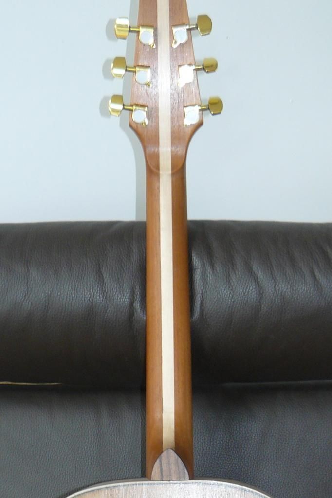

I simply wax my necks with Briwax polish, apply a couple of coats then buff to a nice shine, sometimes a bit of eggwhite first. Maintenance is merely cleaning with methylated spirits then rewaxing. They feel super smooth.
this is a sapele and maple one.
