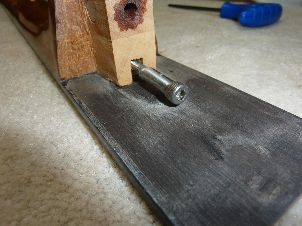

I had a response from Grant at Allied Lutherie and, although he wasn't sure, he suggested that the hex part is cast into threads. Seems reasonable enough to me. He also said my problem was "bizarre" and hadn't seen that before. He also offered me a new truss rod which I will be happy to take him up on as I'm in need of another batch of rods anyways and I still like the rods from Allied.
For those who might be interested, here is a picture of how it worked out in the end:
I also did find a 10-32 set screw but I liked the screw with the head better since it takes a larger, more robust size wrench. I ended up going with the red Loctite. The screw is 3/8" long, i.e. lots of thread and I've given it some healthy cranks in both directions and it seems solid. The neck is now back on the guitar.

Glad it worked out for you Pat

The ends are threaded, and then broached for the Allen wrench. Looks like yours missed that last critical step.

Good fix Pat. That may last you longer than the original.

Thanks Tim and I think you might be right. The hex head on that screw has a lot more meat to it than the hex casting or broaching or whatever it was. If the loctite holds, then I'd call this an upgrade.
