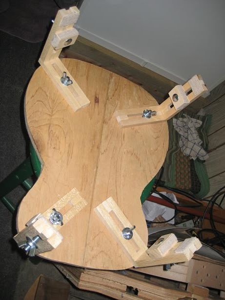

Look at this pic, this is what I used to cut binding channels on my last guitar.
Now you see why I'm so pleased with my new toy.
Gregg
