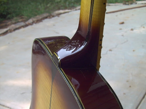

I use Qualasol from Behlens to seal the binding and purfling. Then clear-coat and then use the 3M blue premium striping tape over the purfling and binding before applying the tinted Lacquer. I mix the tinted Lacquer as dark as possibly to cut down on the coats needed to achieve either the transparency or opaqueness desired. One other tip; if you think you have the burst even under the shop lights take it outside in the bright sunlight and any inconsistency of the burst will show up. Take it back in and shoot to correct and check it outside again. When it looks right pull the tape look for bleed under the tape, scrape as necessary (Shouldn't be necessary if you applied the tape correctly) and start pouring the clear to it. I put at least five coats of clear before lightly scuffing with 800 grit. Staying off of the edges. Then another three coats before sanding with 800 grit again.

I am just finishing up this LP. I did the primary yellows and reds by hand with transtint dyes and water. The deeper wine and almost black wine colors were transtints mixed with Target's EM1000 clear sanding sealer. After doing the base colors, I sealed with a couple of coats of clear EM1000 then sprayed the outer edges of the burst. I shot the finish so light it was almost dry when it hit the wood. This did leave a rough texture compared to when nice, even wet coats are laid down. After the color coats, I shot two coats of amber tinted shellac over the whole burst then followed up with clear coats. I didn't touch the burst with sandpaper until I had a half dozen coats of clear lacquer above the shellac. By then I could level the finish and not worry about sanding through to the tinted layers. Once done, the whole burst was nice and level.

People do play outside Howard. It's not "voodoo" to get the burst corrected as it's usually an area that is too light. You simply fog that area lightly and let it flash and take it back into the sunlight to check. You're still shooting the same color you started the burst with so it will blend perfectly. Maybe the inexperienced who don't know how to adjust their air pressure and gun settings and don't have the viscosity of the Lacquer correct could mess up by shooting too much on the retouch. Less is more because you can do it again if you don't make the light area blend. I've been shooting sunbursts since 1971 and that's the way I've always done it with excellent results.
