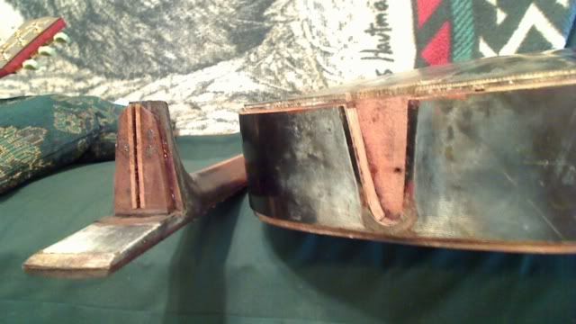

What's that shim and drill hole in the block? previous reset?

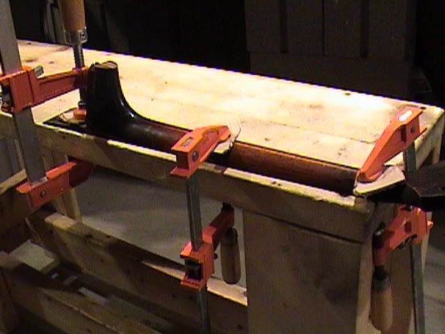

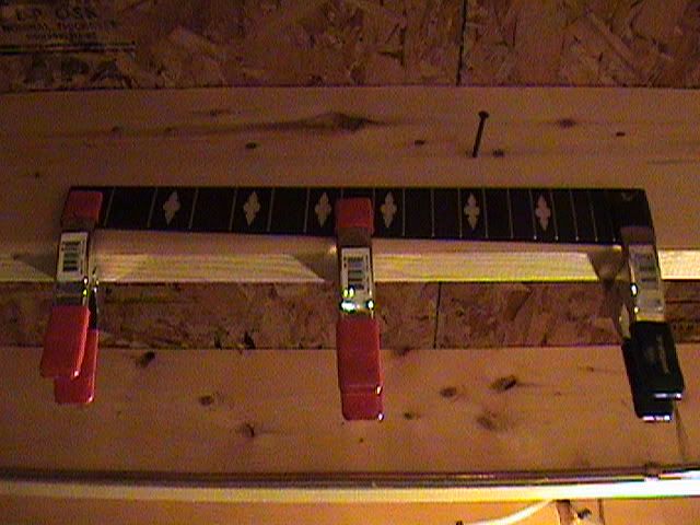

not wanting a cracked piece of wood ,this took forever . at least 2 hours. came out perfect .
i ordered a truss rod from lmi , the standard welded nut one , it was the lowest profile one I could find. @ 3/8 deep route. after removing the fretboard I left the iron laying on my bench to heat up the wood good. Then I ironed the neck and fretboard and clamped them down . the neck to my bench, and the fretboard to the rafters.

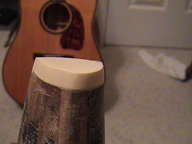

Since I HATE platics on acoustics . A new heel cap needed to be made too . And since im waiting on things to arrive in the mail I figured what better time than now to make it .It needed to be made before the neck could be set anyway so, here it is 1 holly heel cap.

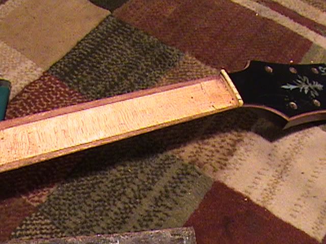

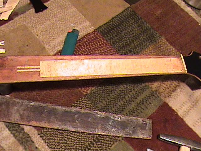

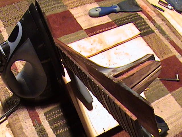

I just realized..... How do you cut the channel for the truss rod ? The neck is already tapered, how do you route a centered chanel? I'm using a dremel 231 table router with a dremel 4000 , and 3/16 routing bit . How do you account for the taper to get a centered channel? Thank you so much if anyone can wrap their head around this, my mind feels fried trying to figure this out .
PostPosted: Wed Oct 13, 2010 12:47 am
Joined: Sun Sep 12, 2010 4:50 pm
Posts: 40
also how sick is the maple in the neck shown here with the fretboard off. sick sick sick looking maple

I would make a template out of 1/2" ply and use a router with a collar and whatever size bit you need.
