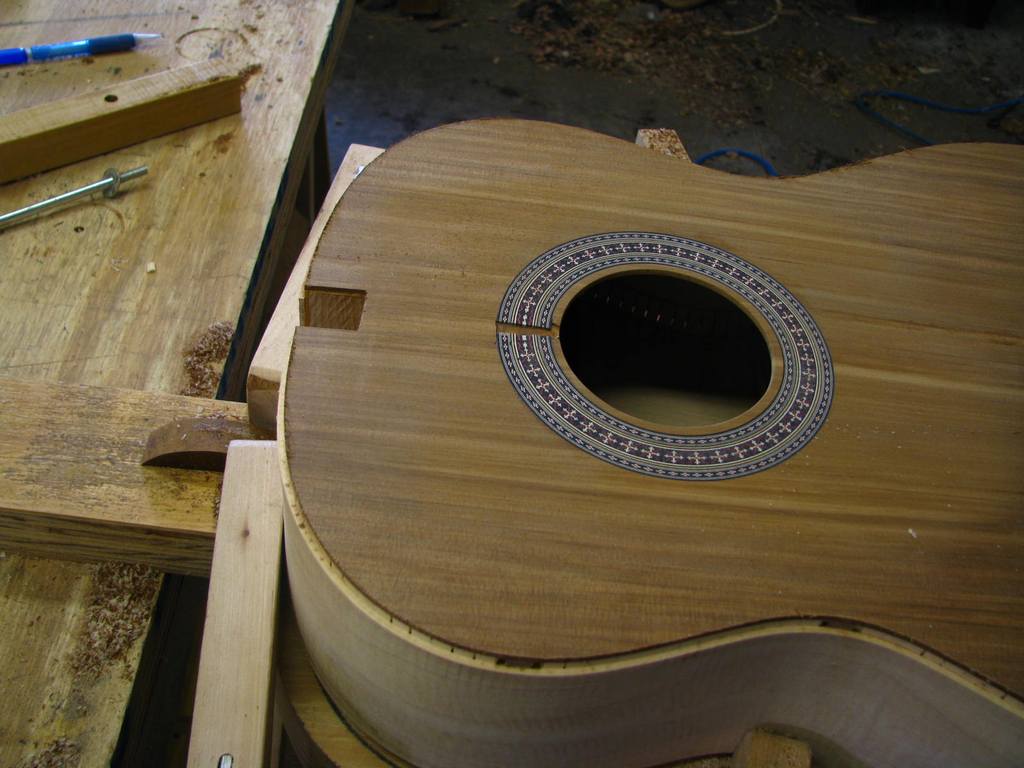

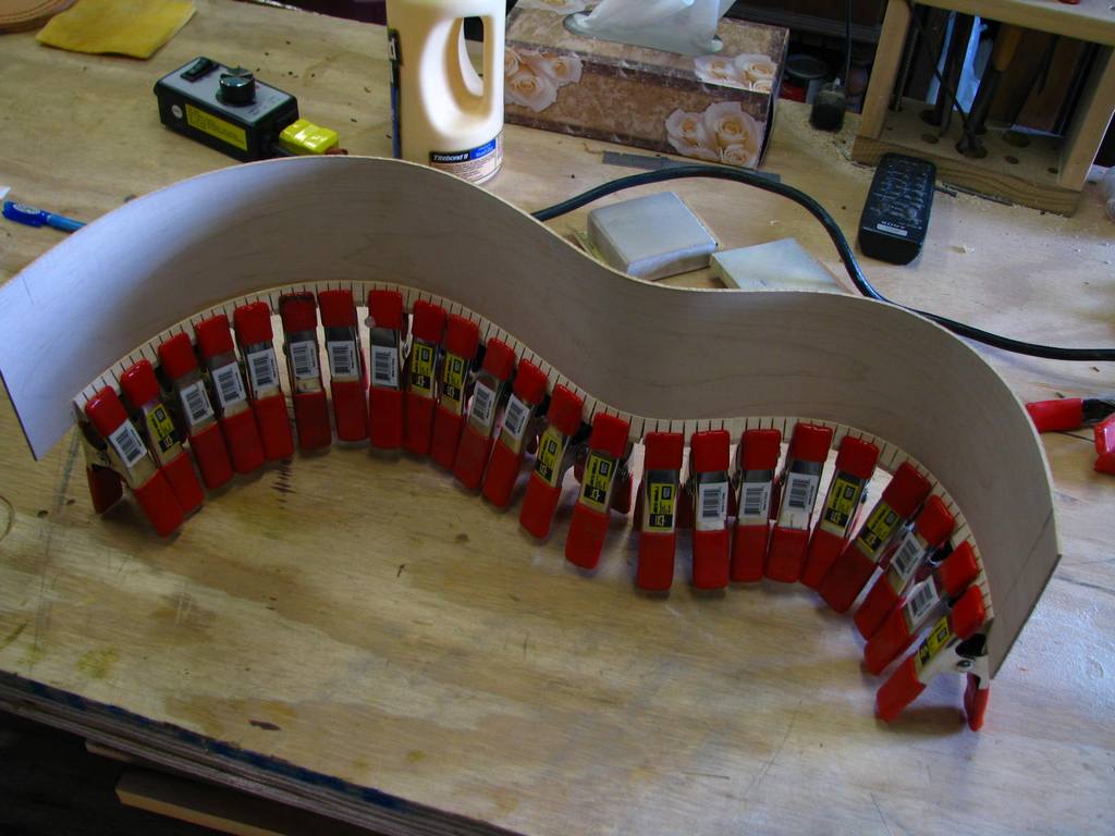

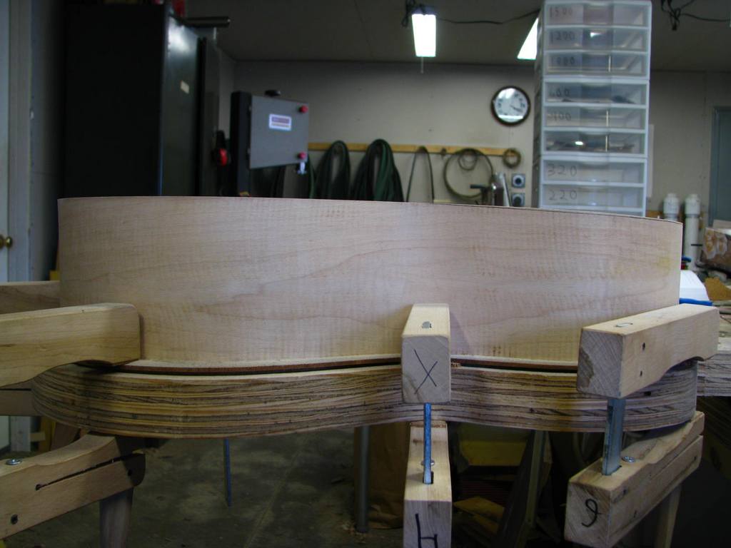

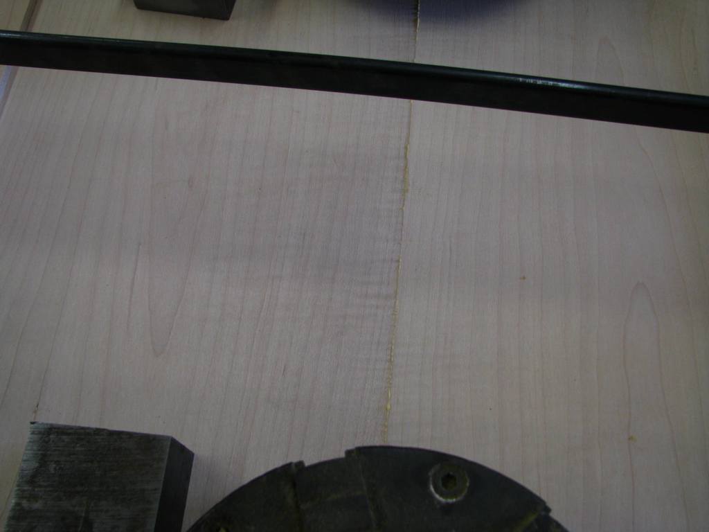

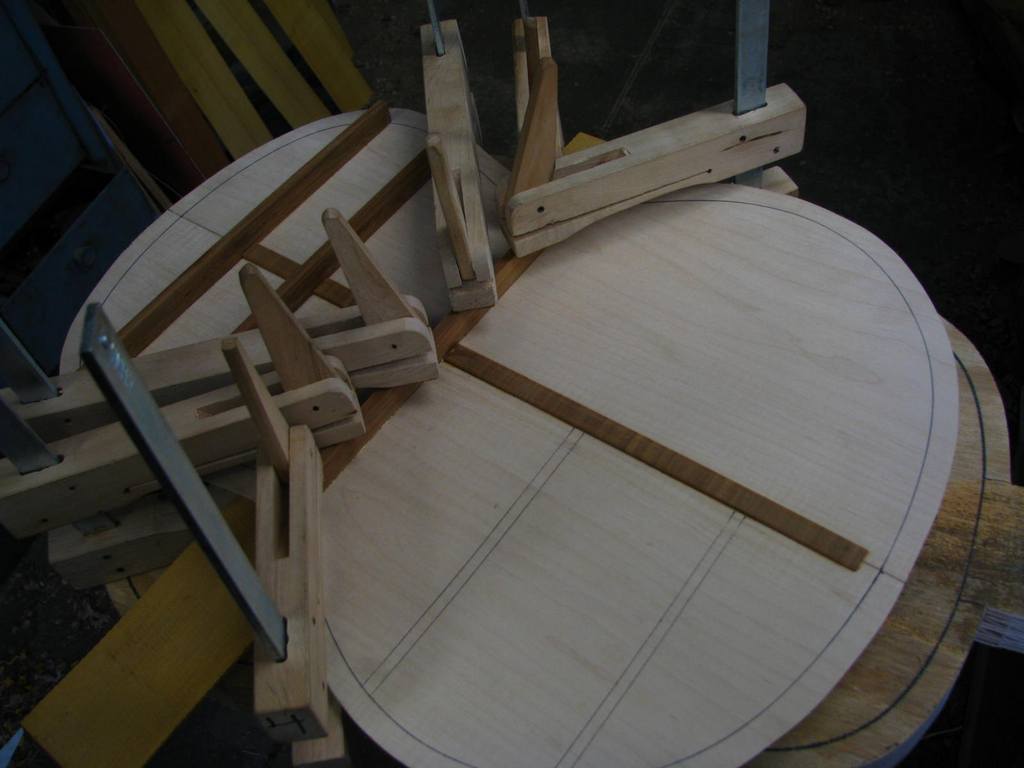

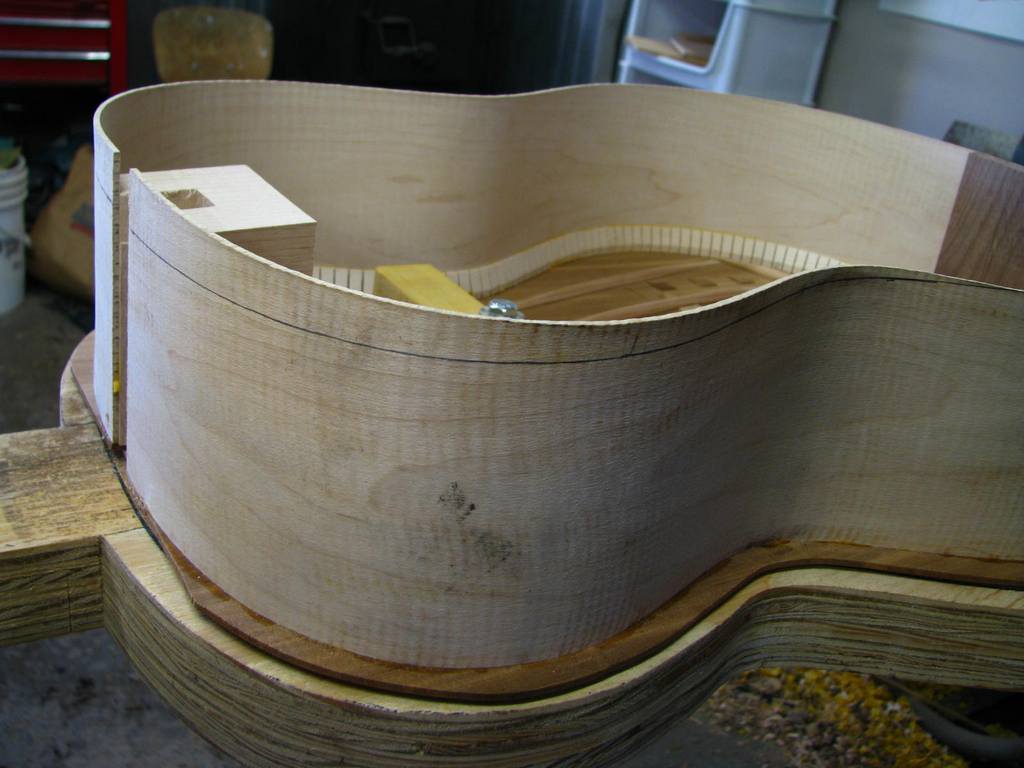

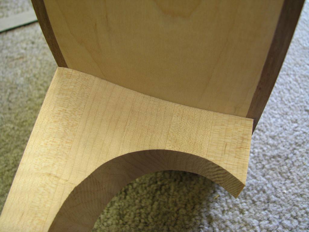

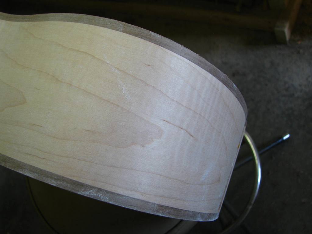

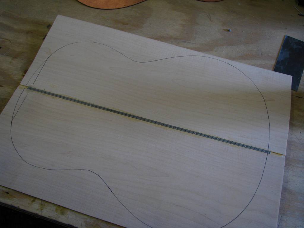

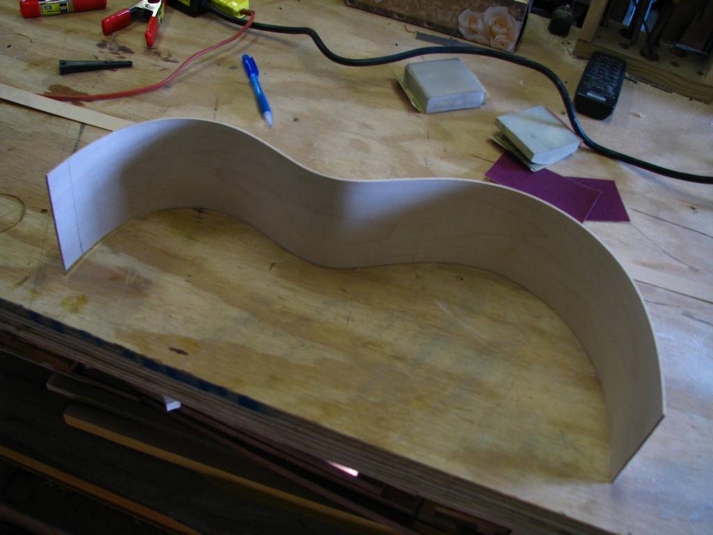

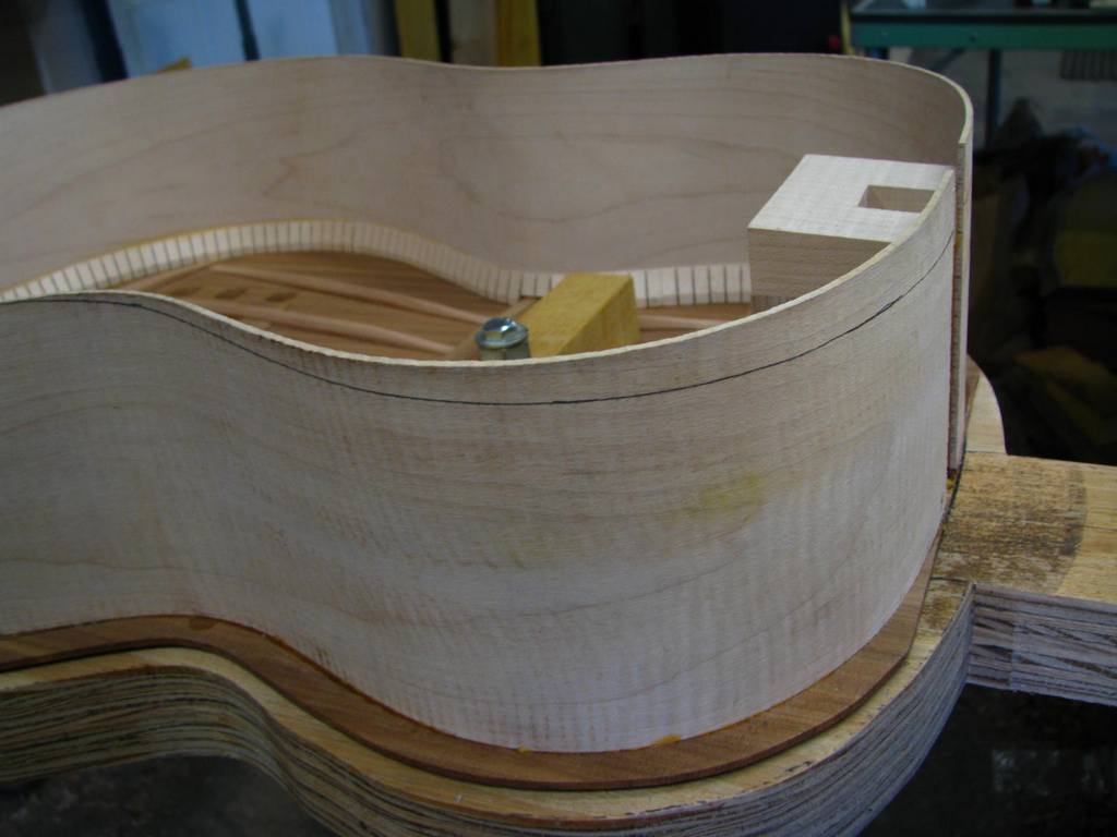

I had to steam the sides twice, because the first time there too much spring back, but they seem to have turned out ok.
Today I glued the kerfing on the first side in preparation for gluing it to the soundboard:

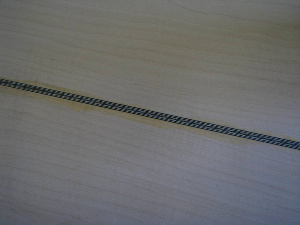

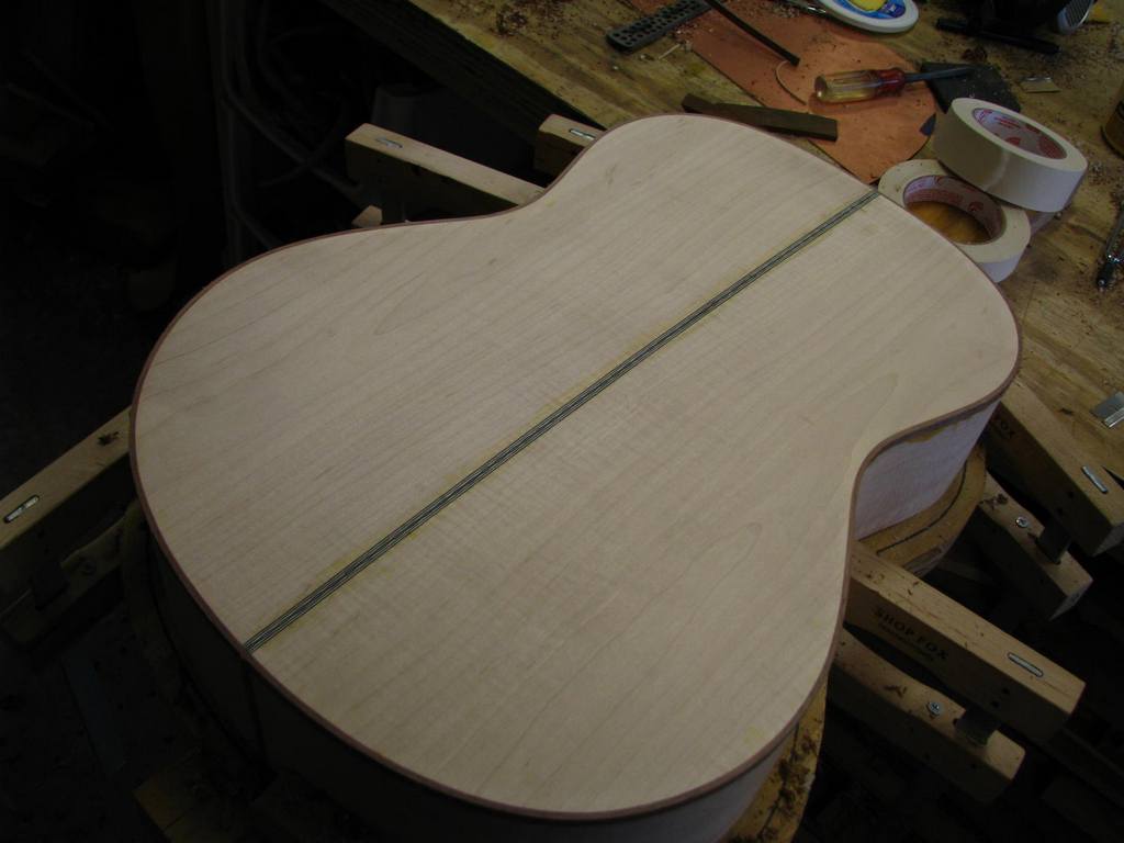

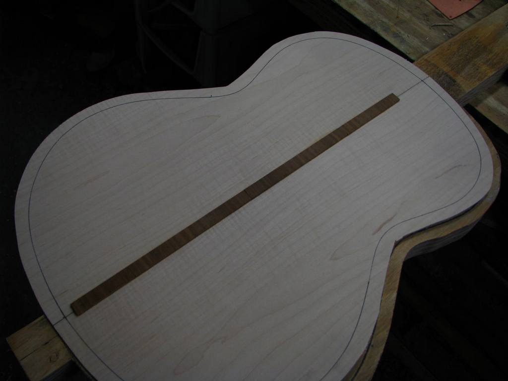

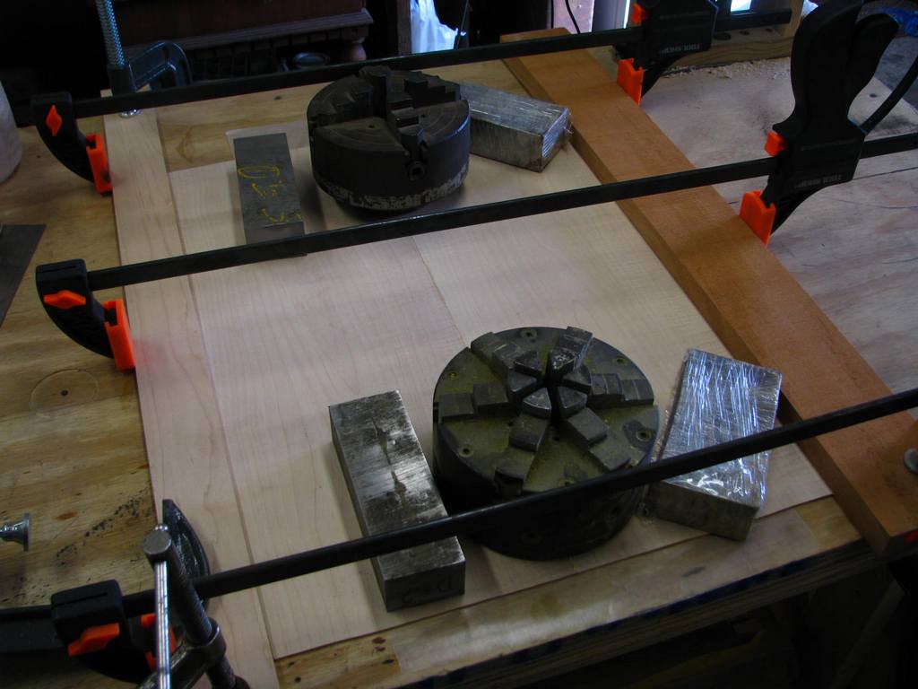

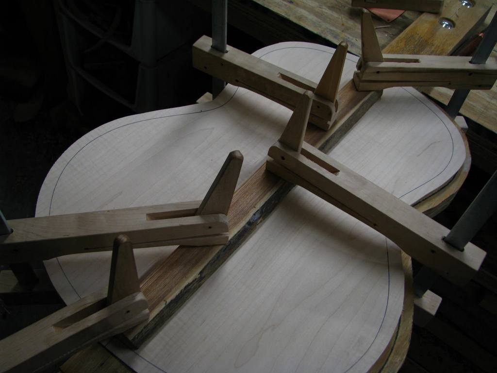

I also glued together the two halves of the back....

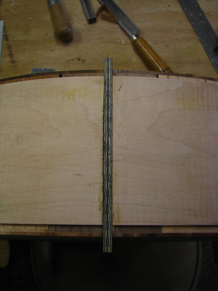

and inlayed the backstrip:

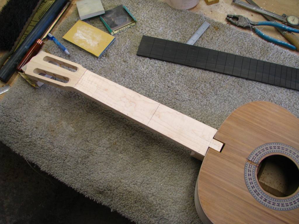

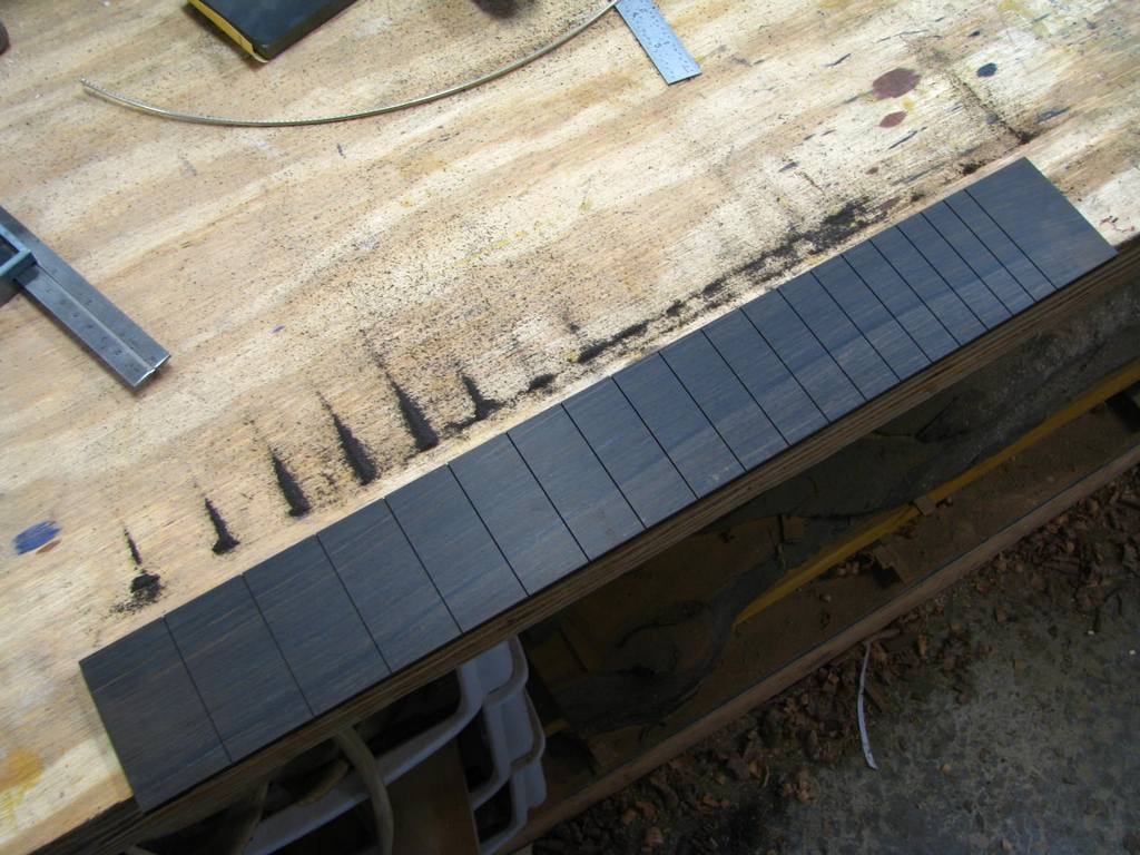

And I slotted the fretboard:

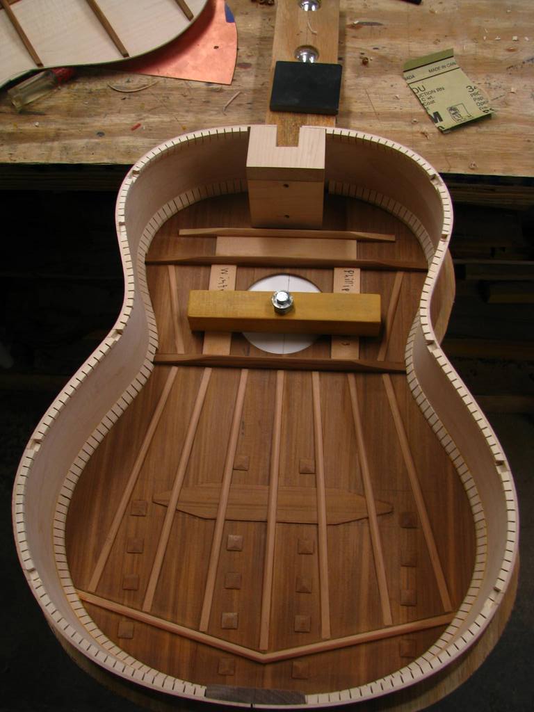

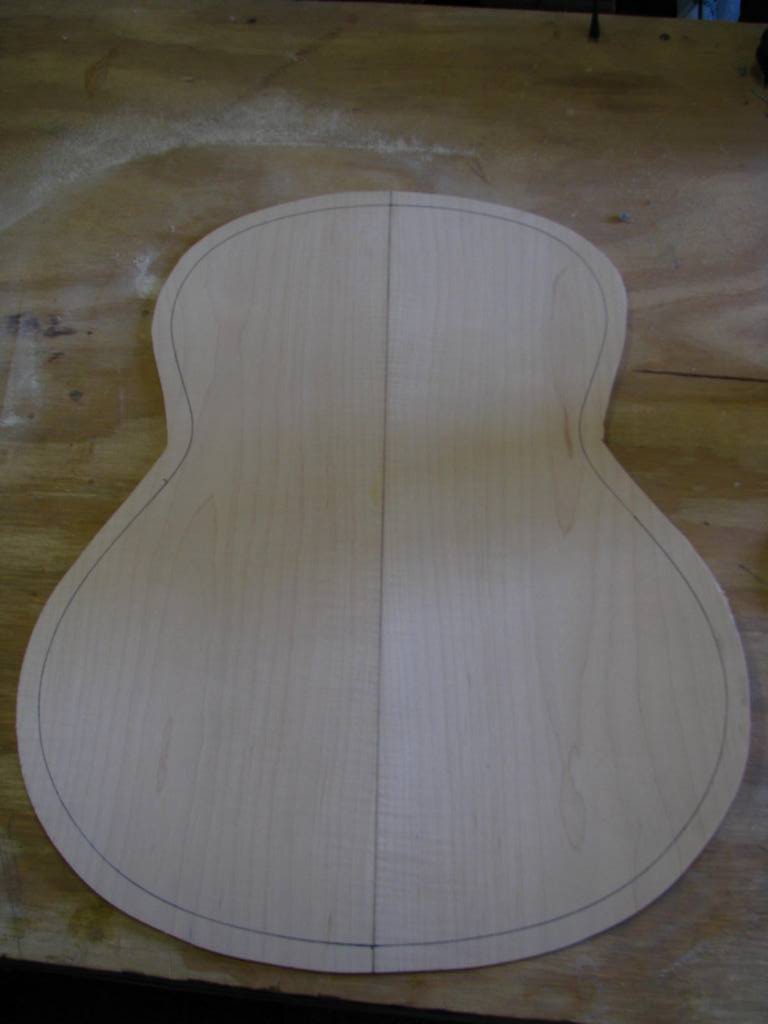

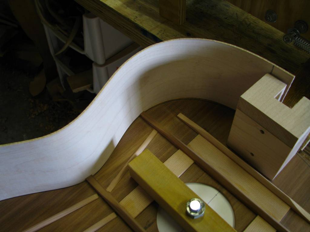

Tomorrow I'll brace the back and glue it to the sides. On my first two guitars I made the mistake of bracing the back days or weeks before gluing it to the sides, and they lost all their arch. [headinwall]

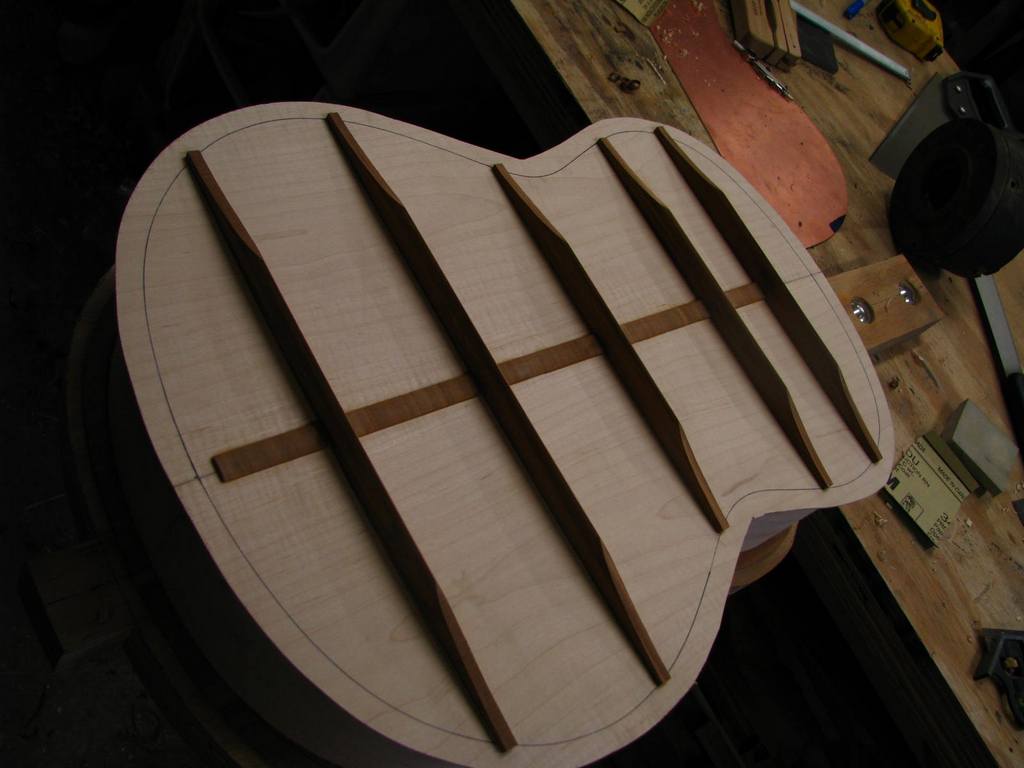

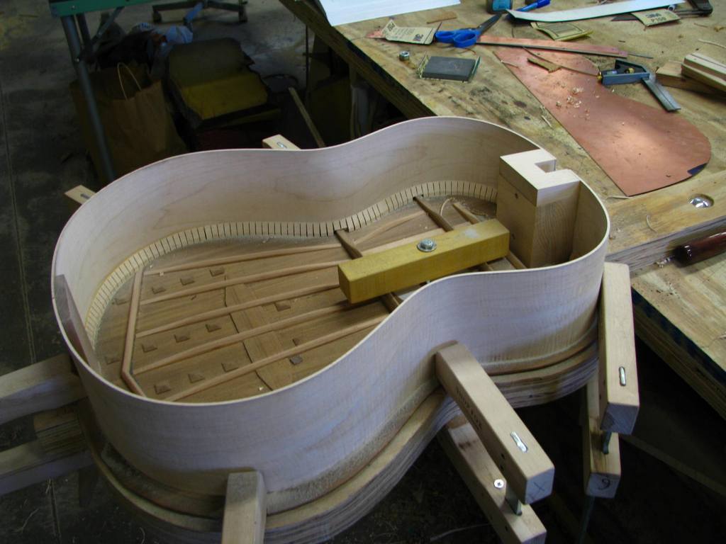

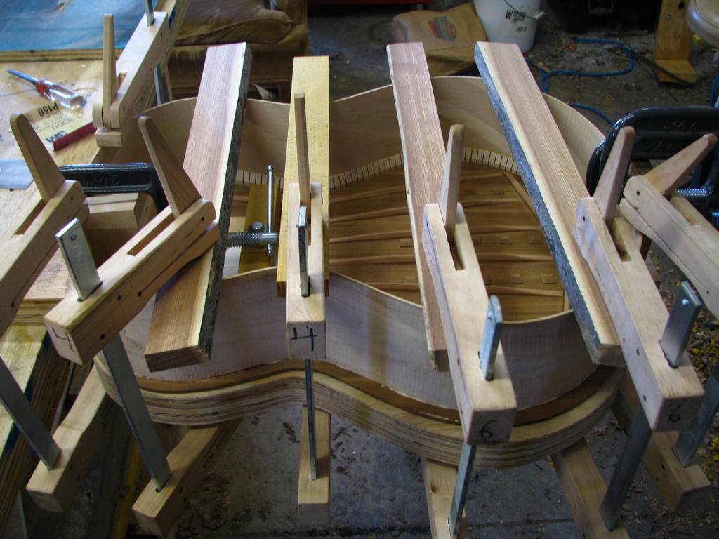

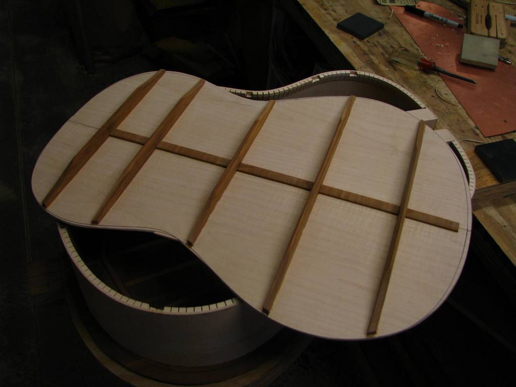

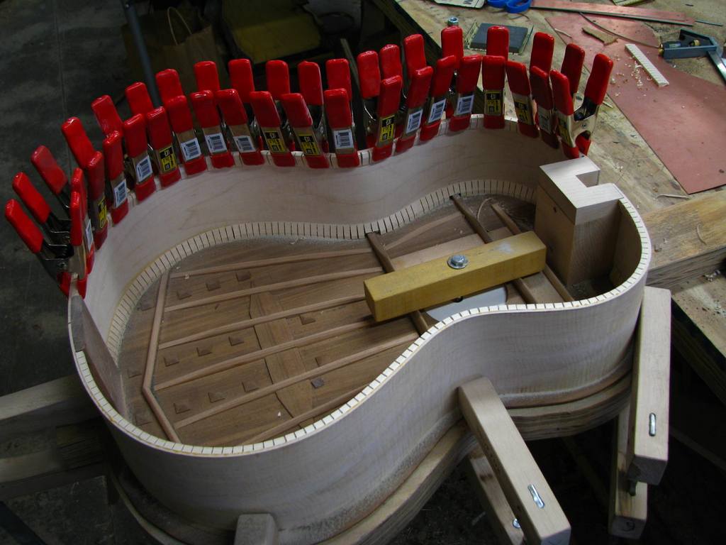

Gluing on the cross grain strip:
Gluing on braces:

 Post subject: Got the back on!

PostPosted: Wed Feb 10, 2010 7:13 am
That's looking really nice, looks a little overbraced, but only you, with the wood in hand, can be certain about that. I like the colour scheme with the darker top and maple sides, that will make a pleasing contrast.
Did you feather the centre of the closing braces before gluing on the back? If not, be careful in the future as any brace not tucked and not feathered to nothing, including the centre of the closing braces, can be dislodged easily if knocked. Also, there are many multi-piece tops around that don't have the cleats added to the seams, did you allow for their mass when bracing?
Thanks for the input! I didn't know braces could be knocked off like that. No, I didn't feather the closing braces, but I will on the next one.
I used 5 braces on the back instead of 4, because the maple I used for the back was flat sawn, and showed a marked tendency to curl up like a potato chip. :mrgreen: But I did use thinner stock for the braces (1/4" instead of 5/16").
The top is thinner than my first classical, and the braces are a little slimmer, so I think the extra mass is accounted for. We'll see. The tap tone sounds good, but then I'm not sure what to look for. ;)

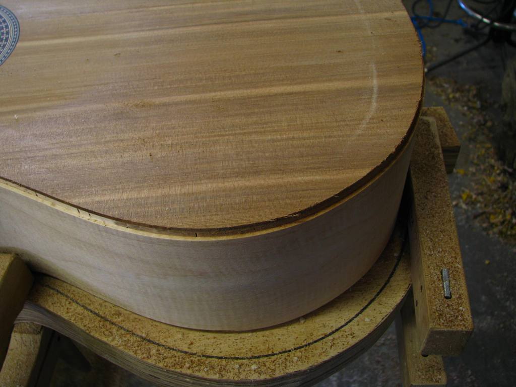

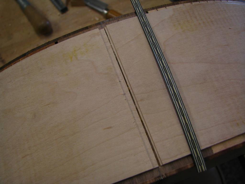

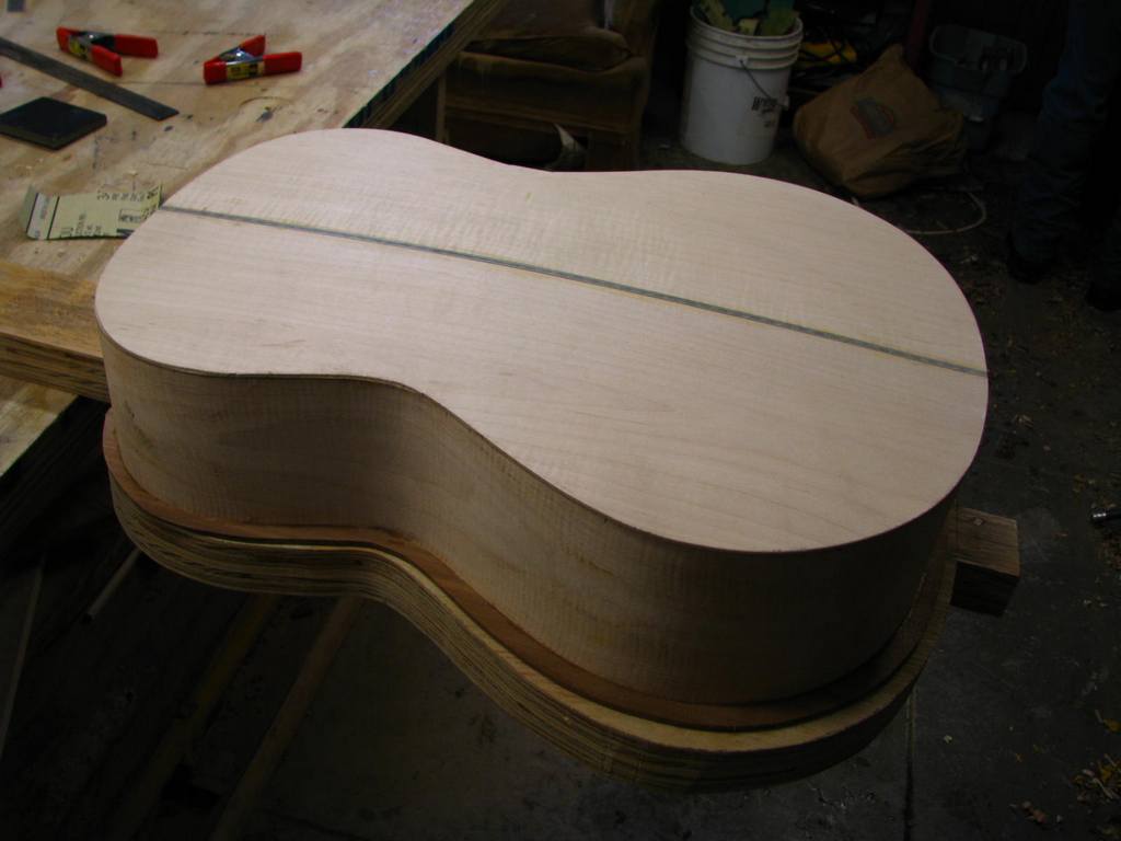

Routed the binding channels and installed the inlay strip on the end:

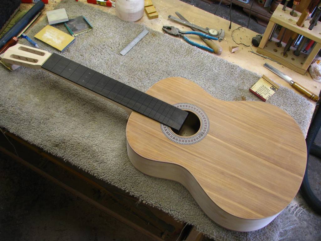

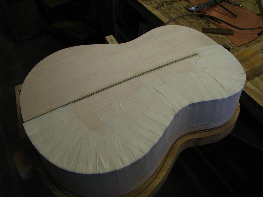

Now that the box is closed, I've noticed that this one is much louder than my previous two. That seems like a good thing. Right?

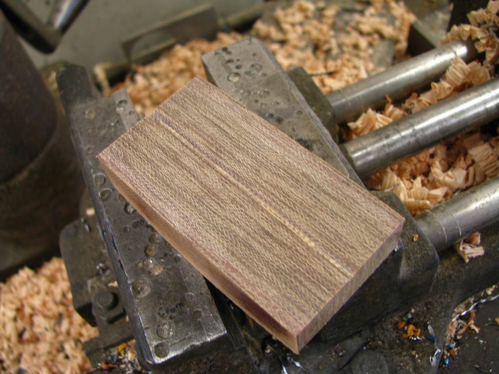

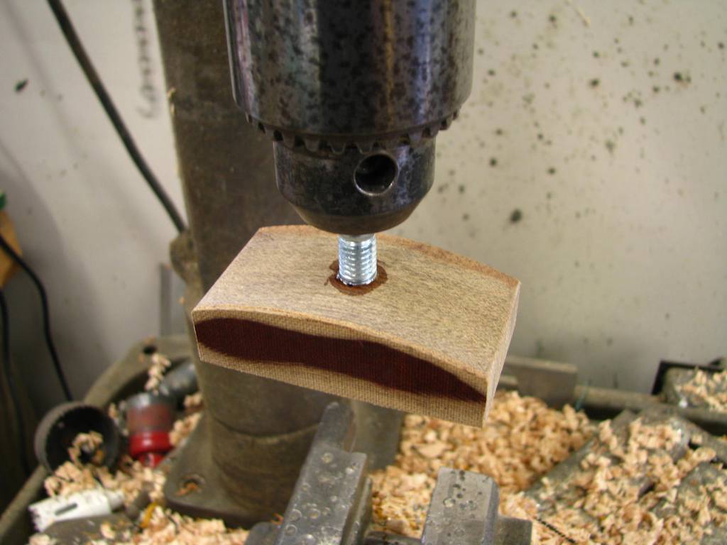

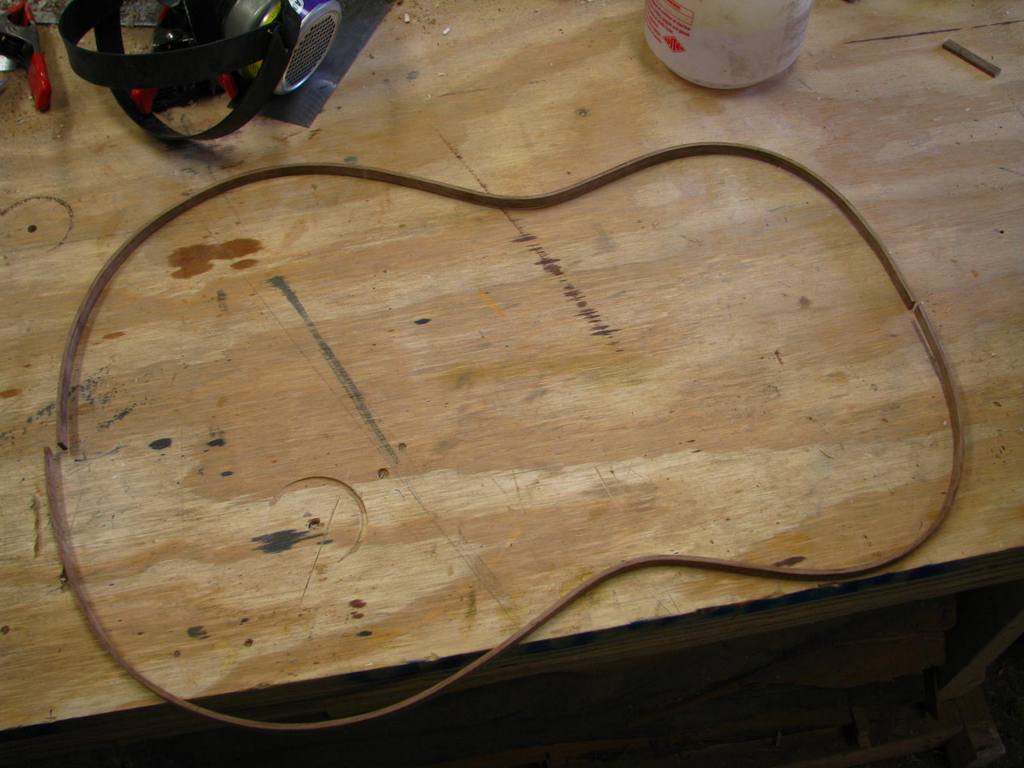

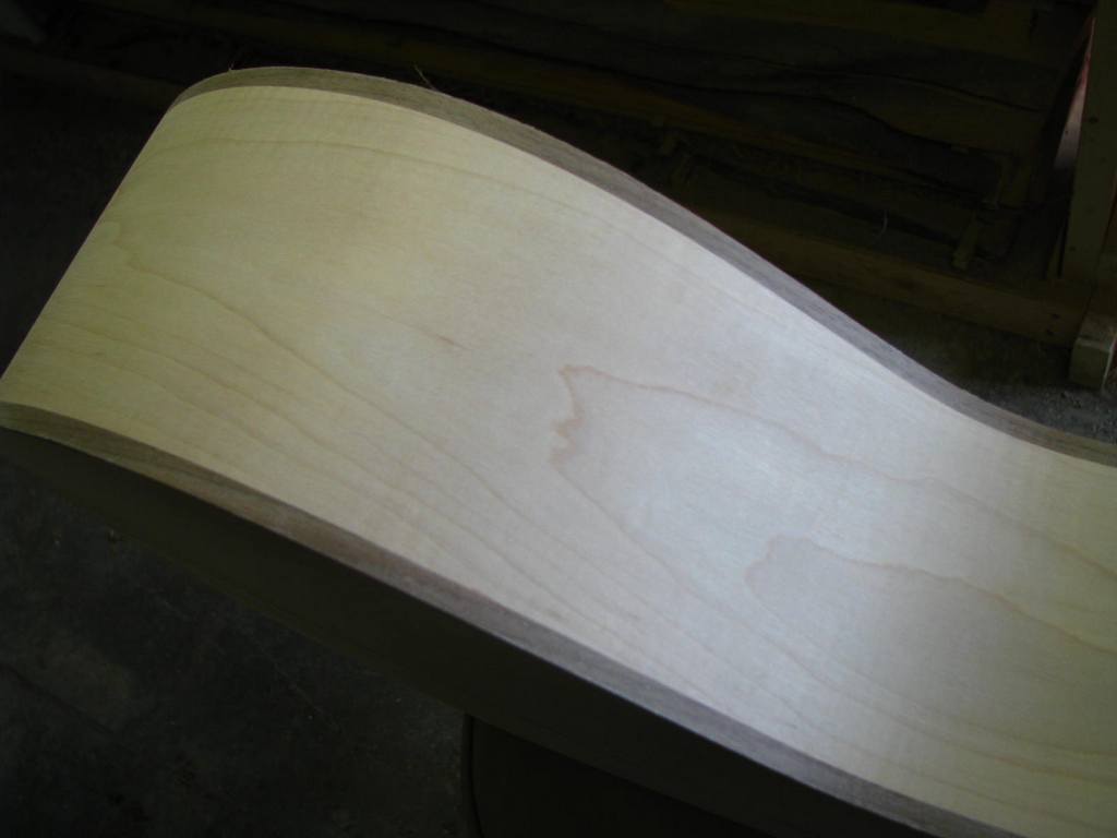

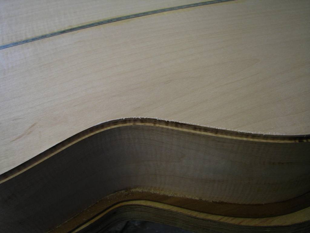

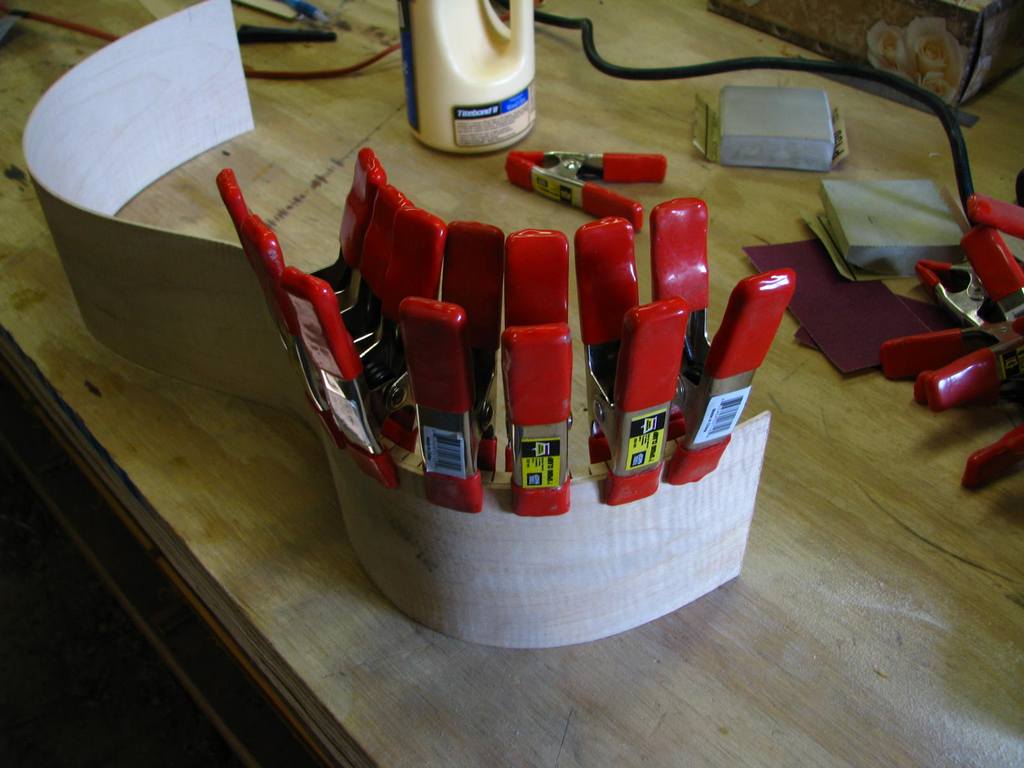

So far, binding is my least favorite part of the whole process, but I did learn a few things on my first two projects, so it's going easier on this one.
I bought a Dewalt palm router/laminate trimmer, which so far seems to be more controllable than my full size router.

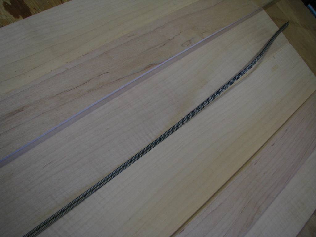

I'm using walnut for the binding. I cut up a bunch of strips, taped them together, and bent them in my bender. They came out with some kinks, so I have to tweak them on my pipe bender to get them to fit right.

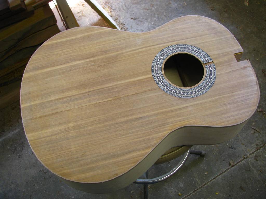

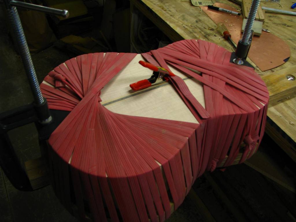

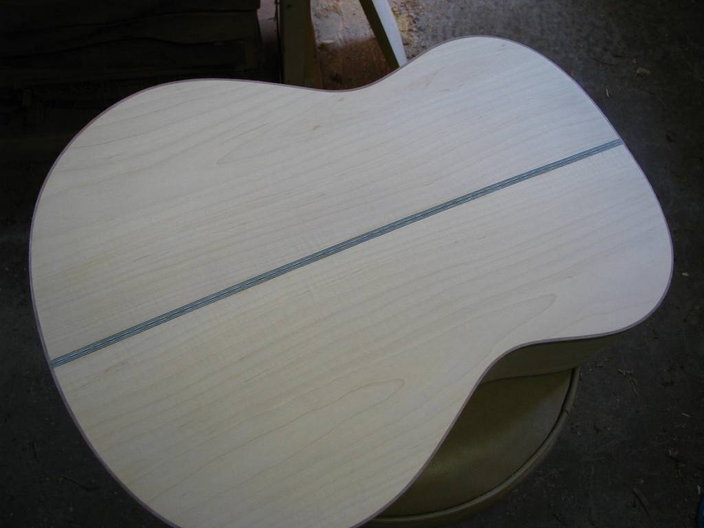

Scraped the binding flush on the back, and glued the bindings on the soundboard side:

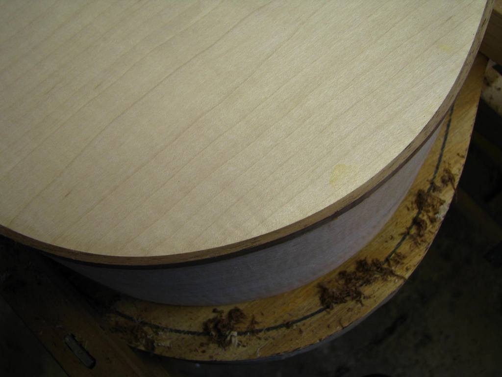

Colin North wrote:
Can't wait to see it with the tape off the top binding. Tease! pfft
Here you go:
The binding came out pretty well. Only a few small gaps. Nothing a little Bondo can't fix.
Just kidding! :mrgreen:

Looking good!
I would suggest filling any small binding gaps with Walnut dust and CA but you probably knew that.
It will be far less obvious than either Maple or Cedar when finally finished and binding width/depth will appear even - guess how I know that. [headinwall]

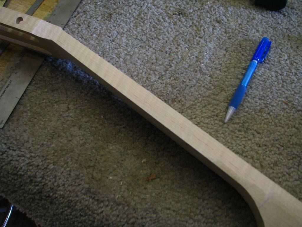

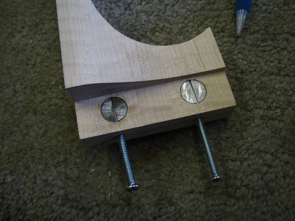

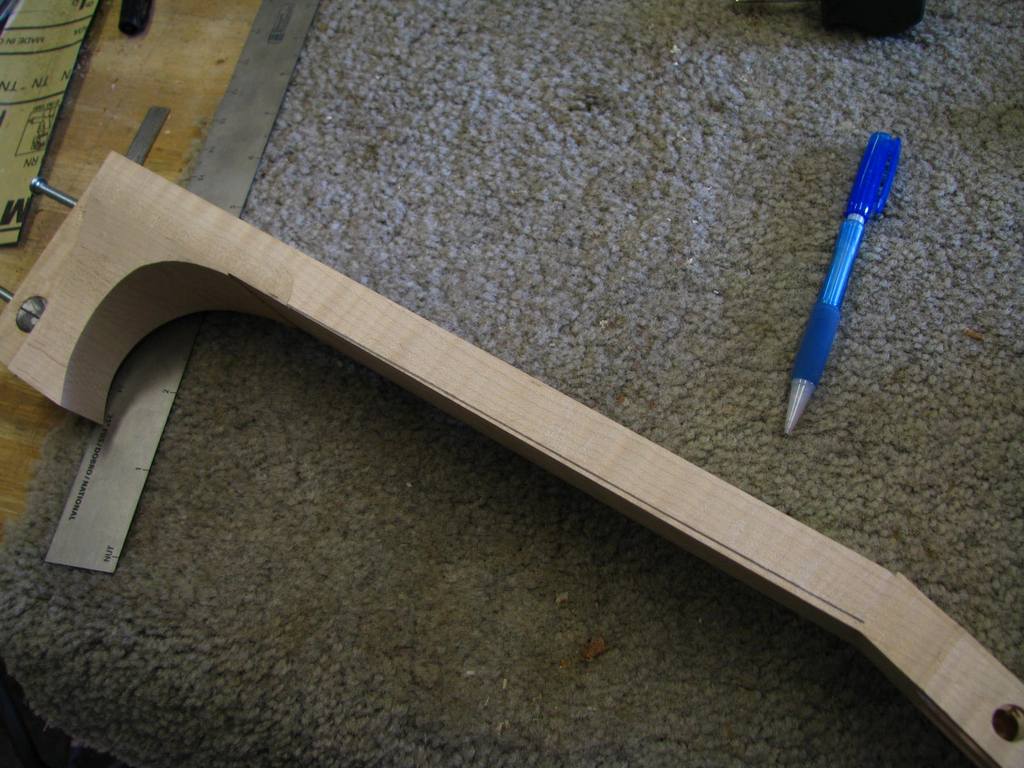

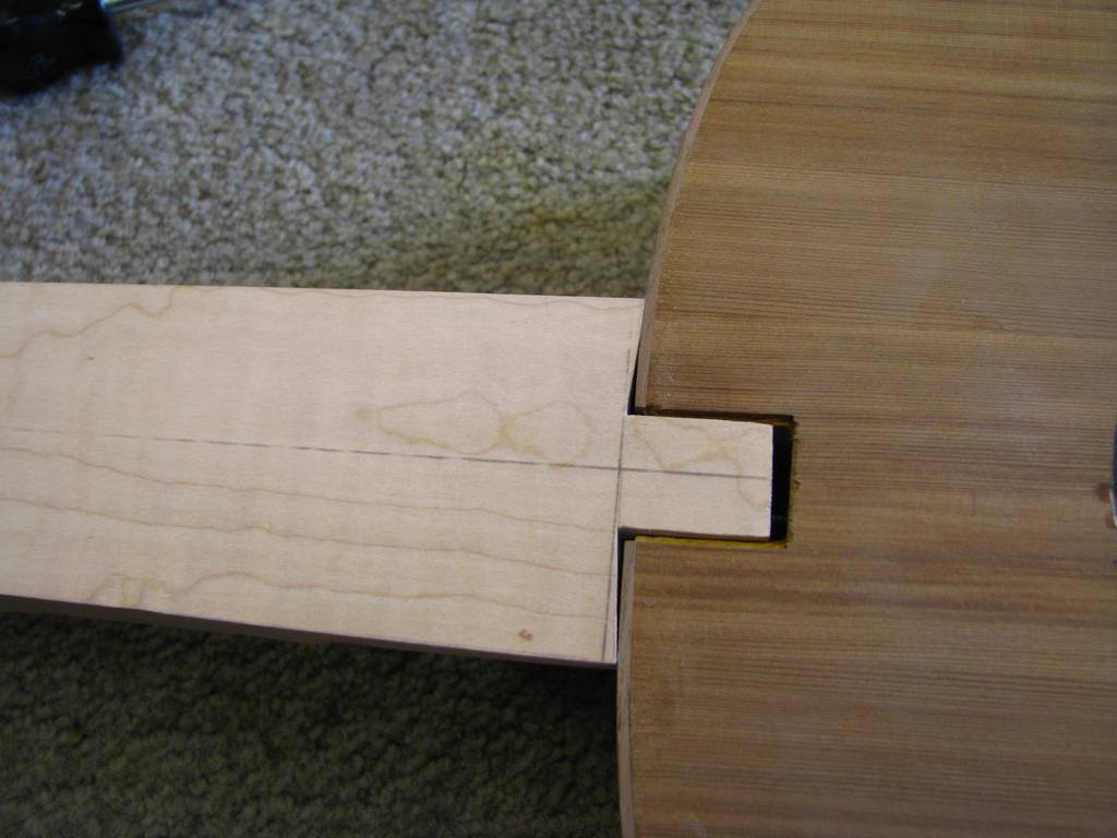

Some shots showing the fit of the neck. It's better than my last one. Just a little "flossing" should make it perfect. [:Y:]

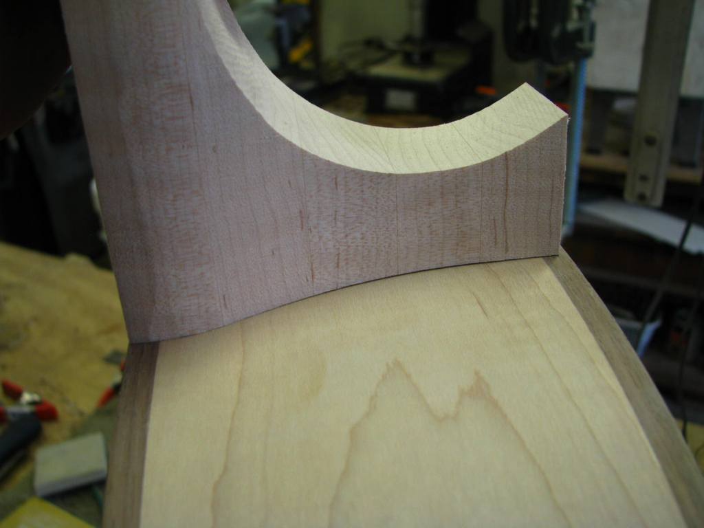

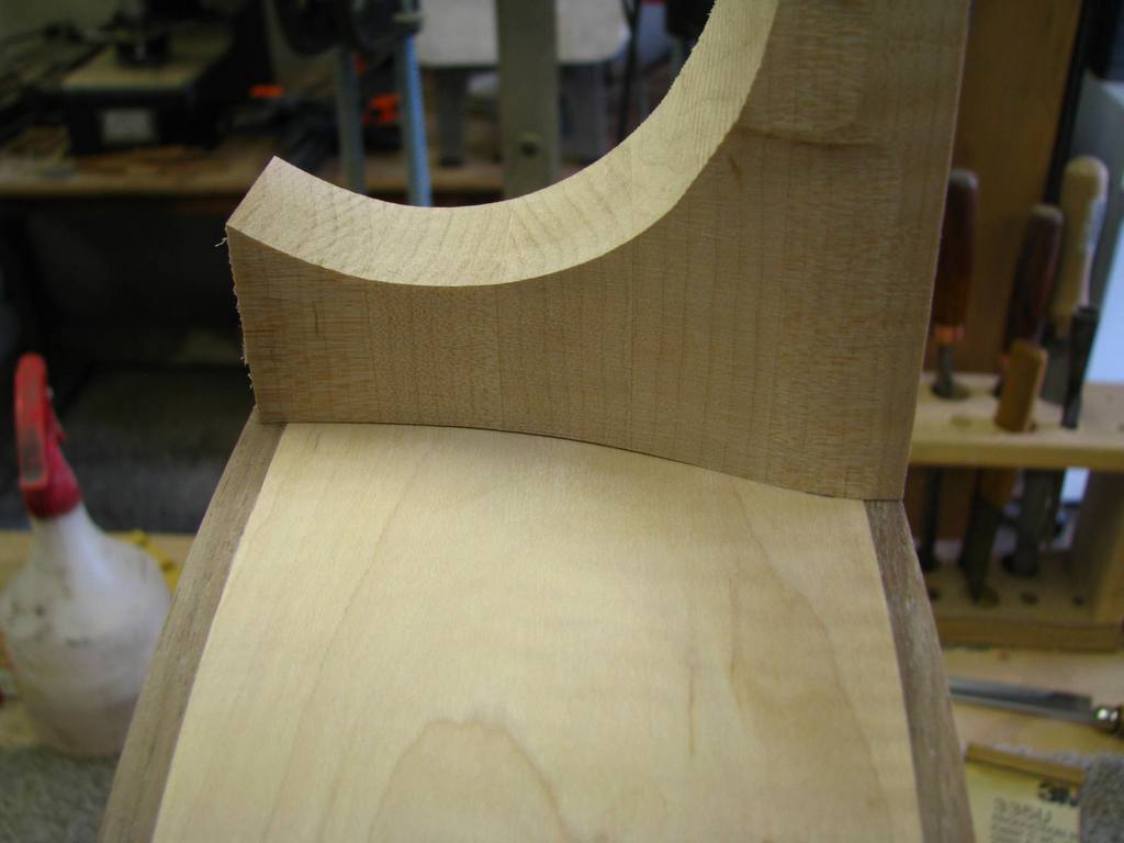

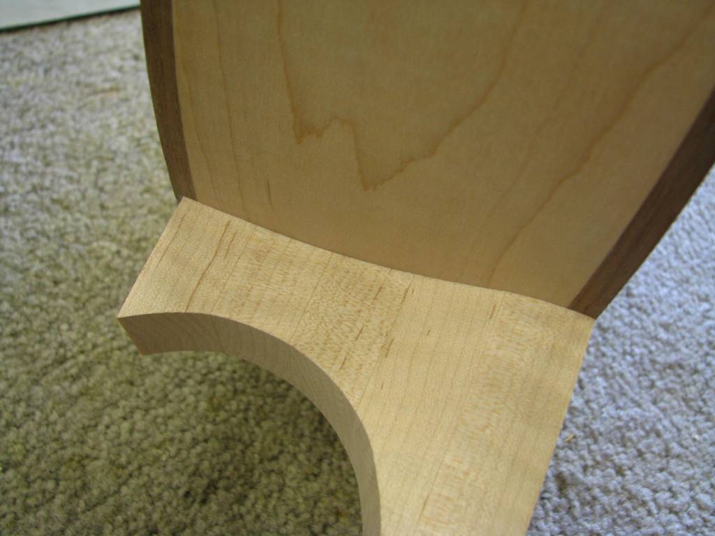

Today I flossed the neck/body joint. To see what it was like before, there's pics in a previous post. Here it is now:
I also tapered the neck shaft a little:
