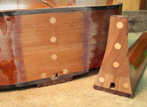

Here you go. I'm betting this is probably what it looks like in there -
I didn't have enough clearance on the bandsaw, so I just cut through the body at the waist - it makes neck removal a piece of quiche on these.
And Larry - though I'm flattered you would consider me as one of the "Wise Men", if you think about it I'm sure you'll have to agree that I'm much more like one of the donkeys they rode in on.
David, a chainsaw will work without cutting through the waist, and IMHO you're one of the wise men. When you talk I listen.
