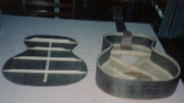

I don't have any good quality pictures from the time of construction. Here's the best that I could come up with.
One of the things Al did to help stabilize the neck angle for the long run was to extend the sound hole brace through the upper traverse brace and into the chin of the neck. This feature doesn't show up too well on my picture so I drew a few lines on top of the braces to highlight what I'm talking about.
Here's another shot from a diferent angle. Again, sorry for the quality, this was long berfor I had a digital camera.

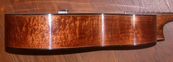

I'll make it easy for you to post your pictures, even it doesn't come out right, by posting some pictures of my first two guitars. The one that had the flat side profile where where sides join the top is rosewood. The one with the very spherical top is koa- that makes it easy to tell the two apart. It's hard for one pictue to tell the story so I'll just post a bunch.
First the rosewood. Some side profiles.
Here's a close up of the fret board extension.
As the picture shows, there wasn't much need to do anything drastic with the fretboard extension. I think we just made sure that the fingerboard would fit flat on the neck and soundboard. I probably used sandpaper on a block. I iimagine that Al would have used a few strokes of a hand plane.
The next one, which I started around 97 used dished workboards in its construction. By this time Al had stopped using the Spanish heel but he still liked it and encouraged me to use it, so I did.
Here are some profile shots. Hopefully you can tell that there was a lot more arch going on here.
Here's a close-up of the fingerboard extension. At the time, it was common practice in Al's shop to carve the underside of the neck extension to match the dome of the top. I imagine we did it by putting chalk on the bottom of the fretboard and then putting sandpaper between the soundboard and the fingerboard extension and then pulling it out. Carve away where there is no chalk, repeat as necessary.
As the pictures show pretty clearly, the saddle is shaved low, and the strings sit low to the top. That's not something time has done to it, that's pretty much the way it came out. The guitar doesn't have strings on it at the moment but for most of it's life it's been under tension. I was in a pinch for bridge pins a little while ago and this guitar had just the pins I was needing. The good news is, when I set it up with this low saddle the action was really low. Still, if it was something that I could easily adjust, I would. It would be easy enough to adjust the neck angle a bit by tapering the fretboard, in fact the fretboard has a bit of a taper in the other direction so a lot of adjustment is available but the fretboard has abalone strips running down the sides so it's a substantial job.
