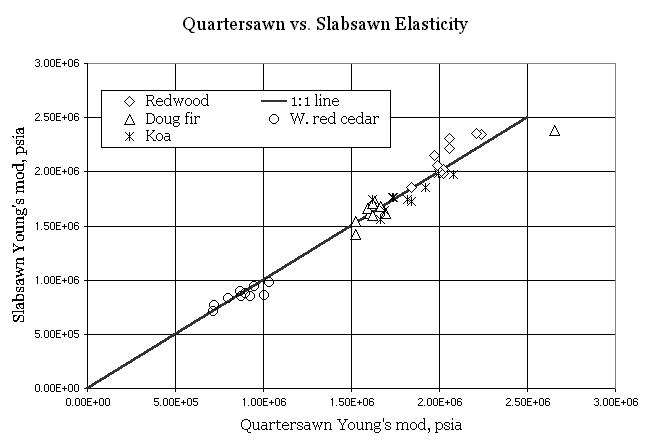

I did some bracing stock deflection tests on four different species of wood a few years ago: Western red cedar, koa, Douglas fir and redwood. All told, I measured about 35-40 different samples. In each case, I measured the thickness in both the quartersawn and flatsawn directions, measured the deflections on a standard apparatus with the same weight and so forth. Then I calculated the parallel to grain Young's modulus for each grain orientation. So here's the data with quartersawn Young's moduli vs. flatsawn Young's moduli, and a 1:1 solid line drawn through the data for effect:
I interpret these data to show that for these samples, if the dimensions are the same in both flatsawn and quartersawn directions, then the stiffness is essentially the same as well.
I also suggest that experiments testing stiffness in various grain orientations with only a limited number of samples can often distort a significant trend because of statistical noise.

For the tests I ran, all the deflection tests were done along the grain of the wood - two sets of them on square cross-section pieces - with the deflection test done on one piece, the piece then rotated 90 degrees along the long axis and the test repeated. So the orientation of the grain relative to deflection never changed.
In a cross-grain flexing test that you describe, the flexing occurs perpendicular to the grain. I like to think of trying the same thing with a piece of corrugated material that doesn't have the surfaces covered with surface sheets. That is, corrugated cardboard without the smooth surface paper on either surface. The Young's modulus across the grain in many woods is many times less than that parallel to grain, but interestingly enough, in koa and I believe mahogany the moduli are much closer to one another.
Perhaps warmer sounding instruments are made from woods which have less of a stiffness contrast (all koa or all mahogany) and brighter sounding instruments are made from woods with greater stiffness contrasts (hardwood back/sides and a softwood such as spruce for the top). This might be another topic for an interesting discussion...
