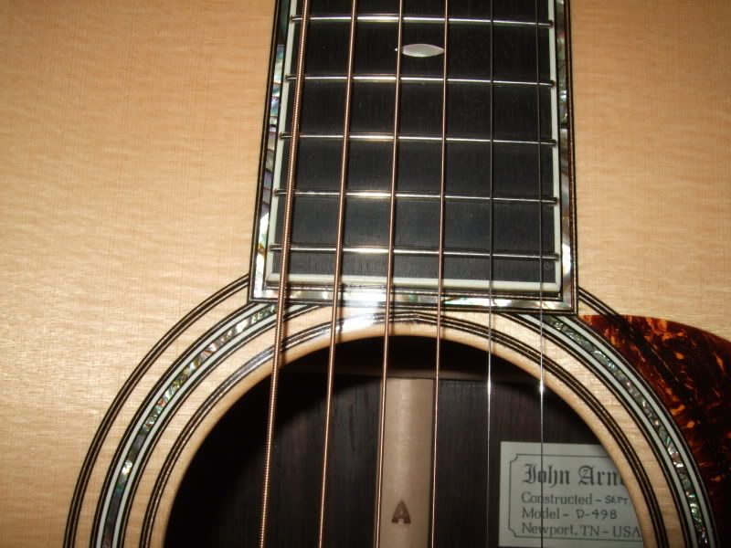

If you look at the definition of Quartersawing Lumber... They cut the log into quarters, stand the quarters Pointy-side-Up, and saw out boards... Only the very middle boards from the Cant will be vertical grain... As you get farther towards the edge of the Cant - they will run to 45* or so... Literally, anything that is 45* to vertical is called "Quartersawn"... so calling your top "Quartersawn" is in fact correct... If you paid a miller to "Quartersaw" a log - You would get pieces looking just like that.
Now... In our Luthierie practice - what we are really talking about is "Vertical grain".... How close to perfect, vertical grain the top is... Once again, it depends on the Supplier and how they grade.... This is where it's handy to talk about Degrees off vertical... If the guys tells you specifically "Master is no more than 5* off vertical across the entire piece" and you get 20* off vertical - then you send it back because it wasn't vertical enough for you....
Some suppliers look at this, others don't... It's very hard when you are talking about the smaller trees you get in Red, White, Black, and European spruce... The trees just aren't big enough - and so the grades are shifted accordingly....
If you feel it's absolutely important to see Medullary rays - then specifically request a top that shows Medullary rays.... Most suppliers I have dealt with will pick you a top to match up with your request (though it may cost a bit more)... and you may have to accept some trade off to get everything you want.... Say 8.5" wide halves, no runout, low density, perfect vertical grain, absolutely uniform grain lines, AND perfect, uniform color in a real life German Spruce top.... You may be talking about a $500.00 top...

This is the closest I have seen to master grade red spruce, and is undoubtedly more rare than true master grade Carpathian spruce.
Quote:
I wouldn't use a top that was more than 4 degrees off quarter.
In general, I would agree. In my experience, cross-grain stiffness falls off sharply when the grain is more than a few degrees off-vertical.
But.....
My 1937 D-28 has grain that is about 45 degrees in the center, and near vertical on the outer edges. It is one of the best D-28's I have ever played. That has taught me that it's just as important to have good wood and good design as it is to get a perfectly-cut top.
In the red spruce I have cut, I made every effort to keep the grain as vertical as is possible. But the trees were small, and the radius of the growth rings on the inner edge of the top is such that the tops can get off-quarter quickly when parallel slices are cut. That can mean rotating the billet after cutting each top (technically radial sawn, not QS), which is more wasteful and time-consuming. However, along with cutting from split billets to minimize runout, it is the price you pay to get the best tonewood.
